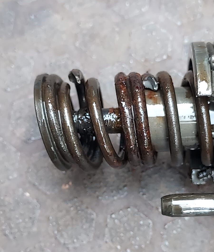

The gasket failure happened exactly where the wrong head bolt had been fitted. Instead of the bolt with a small stud on top to support the dual alternator bracket, a plain bolt had been used - and tightened down hard distorting the bracket, which then bent and came loose
I suspect the tappet fell apart when the pushrod was removed - that's a new one on me! And the broken spring on the fuel pump has probably been there for ages

I did wonder about trying to find a replacement spring, do you have one?
If i can find an old pump, yes. I'll have a look
Richard
23 minutes ago, SiFi said:
Or you need a spring
Richard
