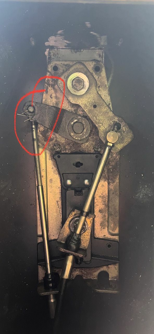

Just an update. I’ve unexpectedly gone to my boat today and taken a much closer look at the morse control, which I now believe to be the MV-1. After getting my hands dirty, the improvements have been fantastic. There is a huge improvement in control, the handle takes the boat into forward and reverse and the acceleration in both directions goes from the gearbox turning very slowly and incrementally increasing in speed as the handle is pushed forward or pulled backwards. There is no longer the slamming into gear that I’ve previously experienced. I’m hoping that I’ve not damaged the gearbox in anyway, time will tell, at the moment it sounds pretty good.
The amendment made was to the shift cable where it met the control arm. It was wound out a few turns and the nut on the cable tightened, I think this allowed the cable to push the arm at the gearbox that little bit further, ensuring it went into gear, something it must have just been missing previously. From the information I’ve gained, it looks like the cable also needs to be attached to the arm in the same direction as the throttle cable. I’ll do this when I’ve purchased a few replacement split pins. You wouldn't by any chance know where I could purchase the pivot (the part that the split pin threads though)? Seems they are only available in the US.
Once again, thanks for all your input, I’ve found it invaluable. If you are anywhere near Stockport I’ll buy you a beer or three!
Mark
Try looking for clevis pins
As an example:-Clevis Pin Bright Zinc Plated Steel, All sizes | eBay
A thin washer under the split pin also takes out some of the slack.
Thanks, that part number should help the OP
Any idea where the modification came from?
Wish I did, we had that boat for 14 years, contacted all the previous owners even spoke to the guy that actually built her, but never found out about the pulleys or many other odd things. The engine however was marinerised by Oxford Marine but never found any info on them.
Our old boat with a BMC 1.5 had a very similar modification, that used a 4PK1052 belt, but until you offer up a new belt to the pulleys it is very difficult to tell.
