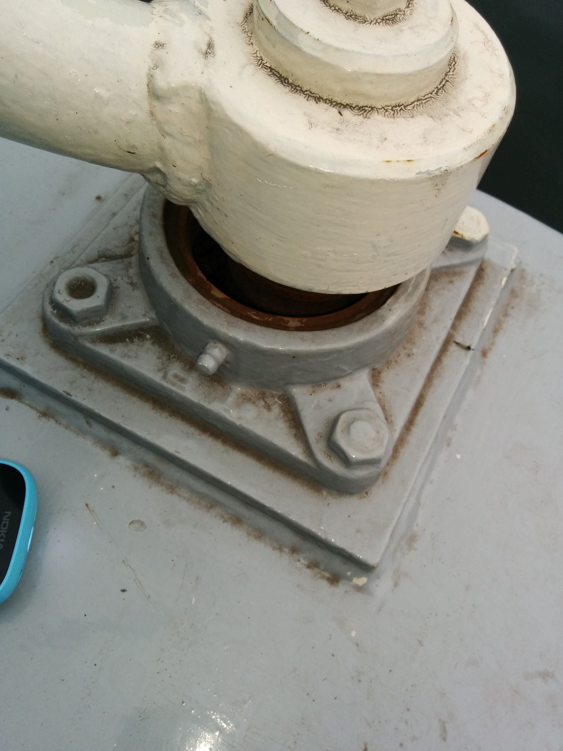

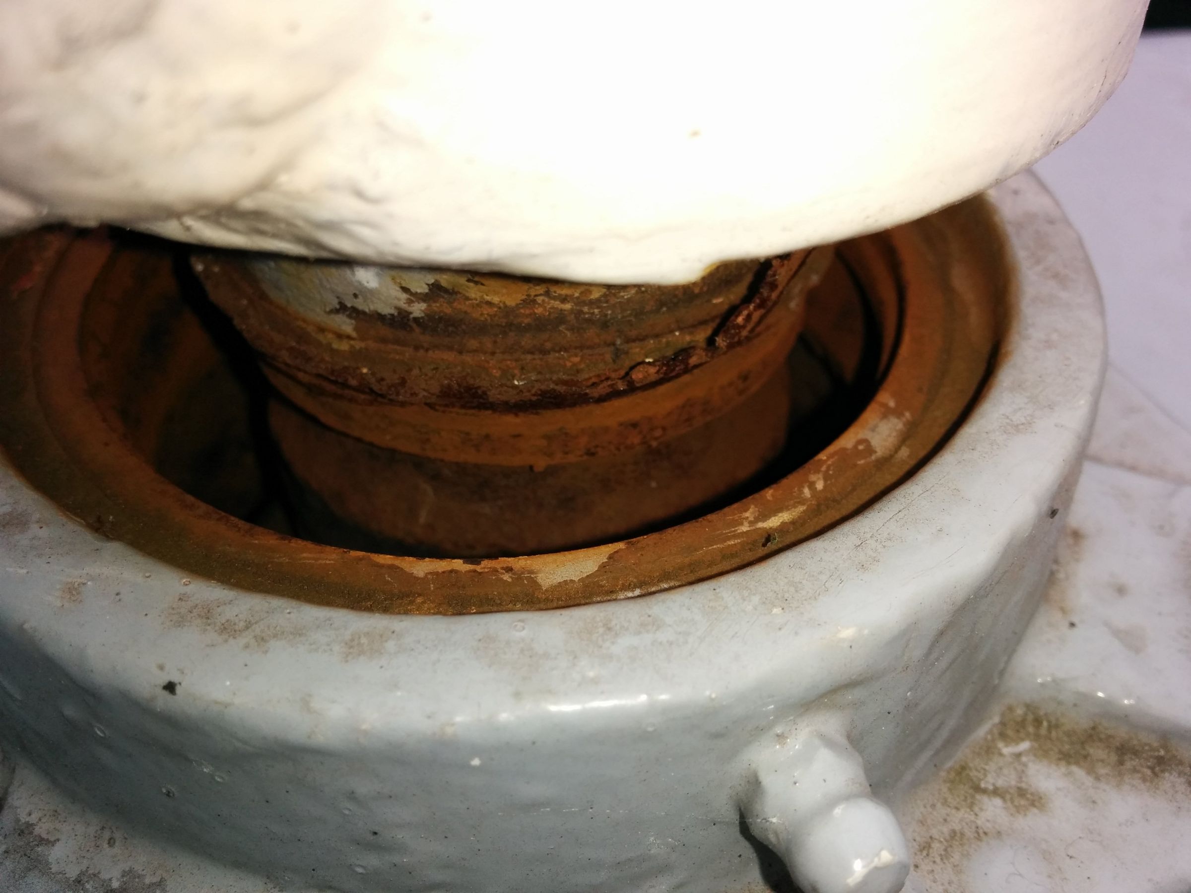

  8. Just to conclude this thread, here's what we (my incredibly helpful dad and I) had to do: Getting the swan neck off was, as people predicted, a real pain. It took 2 attempts - the first attempt, with smaller/less powerful tools didn't work - so if you're attempting this, my advice would be to get some serious tools! We used a fairly beefy puller tool, then heated the outside ring of the swan neck with a powerful blowtorch and whacked it on all sides with chunky hammers. After about an hour or two of that, it did finally come off - slowly - but it was a lot of work. No way I could have got it off without a puller tool. Once the shaft was exposed, we then had to remove the rusted bearing, which was of course, fused to the shaft. Several cuts with an angle grinder finally took it off, but again, a pretty mammoth piece of work - probably took another hour and a half or so to try and avoid grinding into the shaft itself or the bottom plate. That didn't actually manage to get the rusted bearing off the shaft though. The thing that finally did it was the puller tool again. We had to lift the rudder up slightly so that we could get the puller tool underneath the bearing (we'd taken the advice of putting a bit of rope through the hole in the top of the rudder, so we were able to lift it - it never slipped out of the cup that holds it at the bottom end, though on other boats that may be a risk). All that done, we were finally able to determine that the shaft width was 1 1/2" as opposed to 40mm, which are the 2 available sizes of F208 bearing unit, which I got here - thanks @OldGoat for the Bearing Boys recommendation - no need to go anywhere else. I then sanded back all surfaces as best I could, liberally applied grease over everything and fitted it all back together. Just got a couple more nuts & washers to find, but it's solid enough to pilot the boat now, without the tiller clanging back and forth. One day we'll repaint some of it, but - of course - not the grease nipple!

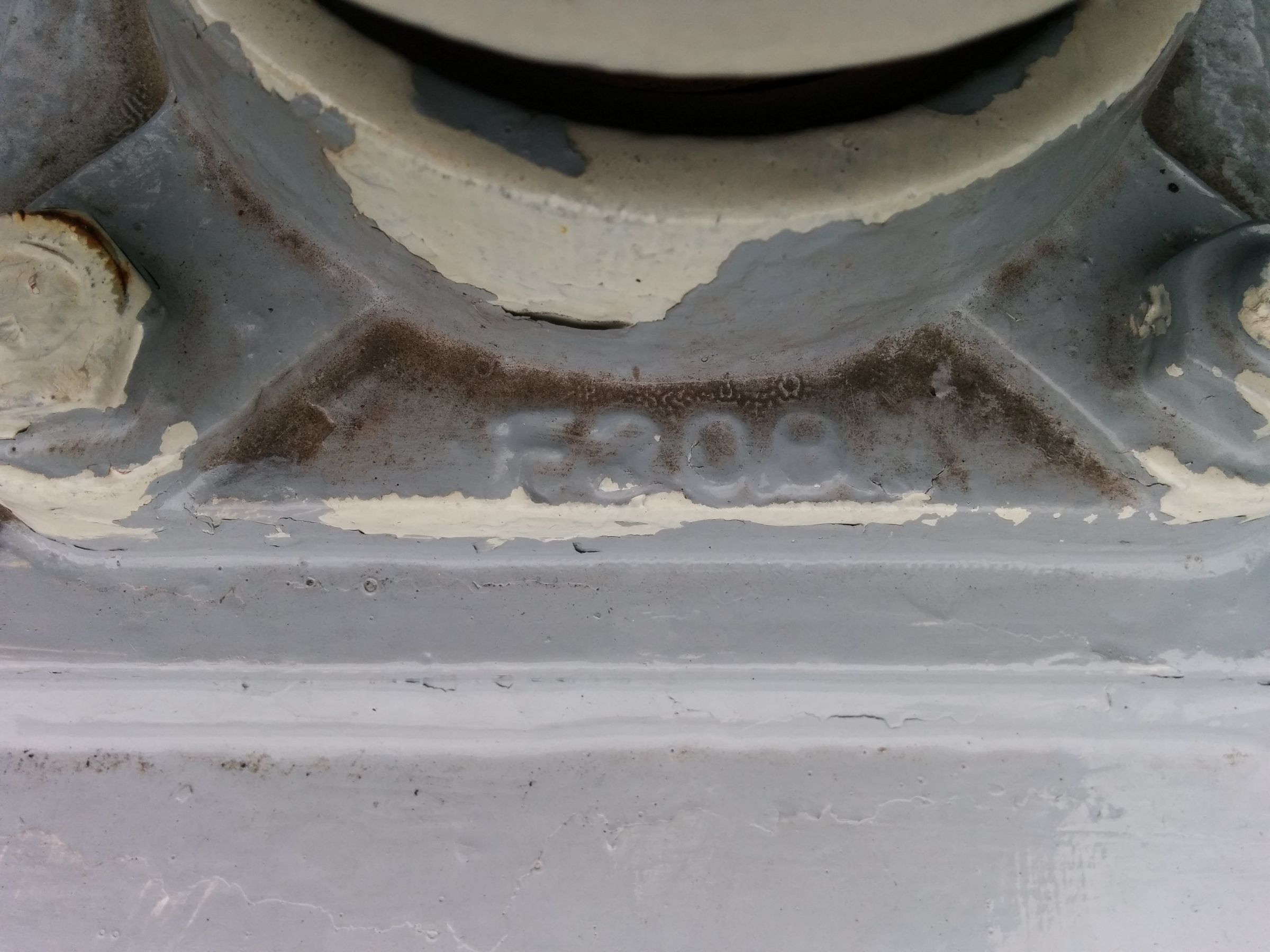

  11. Hi all - very new to boating and the boat that I've bought has a very loose tiller. It was identified before buying, so not a surprise, but I'm hoping someone can help me understand the best next steps to fix it. Some details: The looseness is only at the top - the rudder appears to turn fine, and has done so for three years (previous owners didn't travel very far and didn't see an issue with the steering). The boat is a Bidston Marine from 2003 Shaft diameter appears to be 53mm, however that diameter may also include some of the wreckage of the old bearing seen below - actual shaft diameter should probably be measured after removing this! The existing housing is marked "F208" Here's the tiller in question: Looking at other posts on here, it seems like the bearings have been destroyed and what's left of them will need to be removed and replaced. A few questions then: If I take the swan-neck off, do we think that the rudder is going to fall into the water? (It seems to be standing up based on the bottom cup at the moment, so I'd guess not, but thought I'd ask) Once the swan-neck is off, I'm assuming that I'll be able to lift the old bearing off and clean the rust off the top of the shaft - do we foresee any issues here? Do I just need to take off the entirety of the existing painted housing and replace it? Looks like you can get F208 bearings quite easily - like https://www.ebay.co.uk/itm/New-40mm-Bore-4-bolt-flange-bearing-F208-with-40mm-bearing/284234869022 - do they come with different bore sizes? I've only found 40mm. Lastly and probably most importantly - is it likely that the bottom bearing may also want replacing when we take the boat out of the water in a few months, and if so, is there a reason I might regret not doing top and bottom bearings at the same time? Thanks! James
