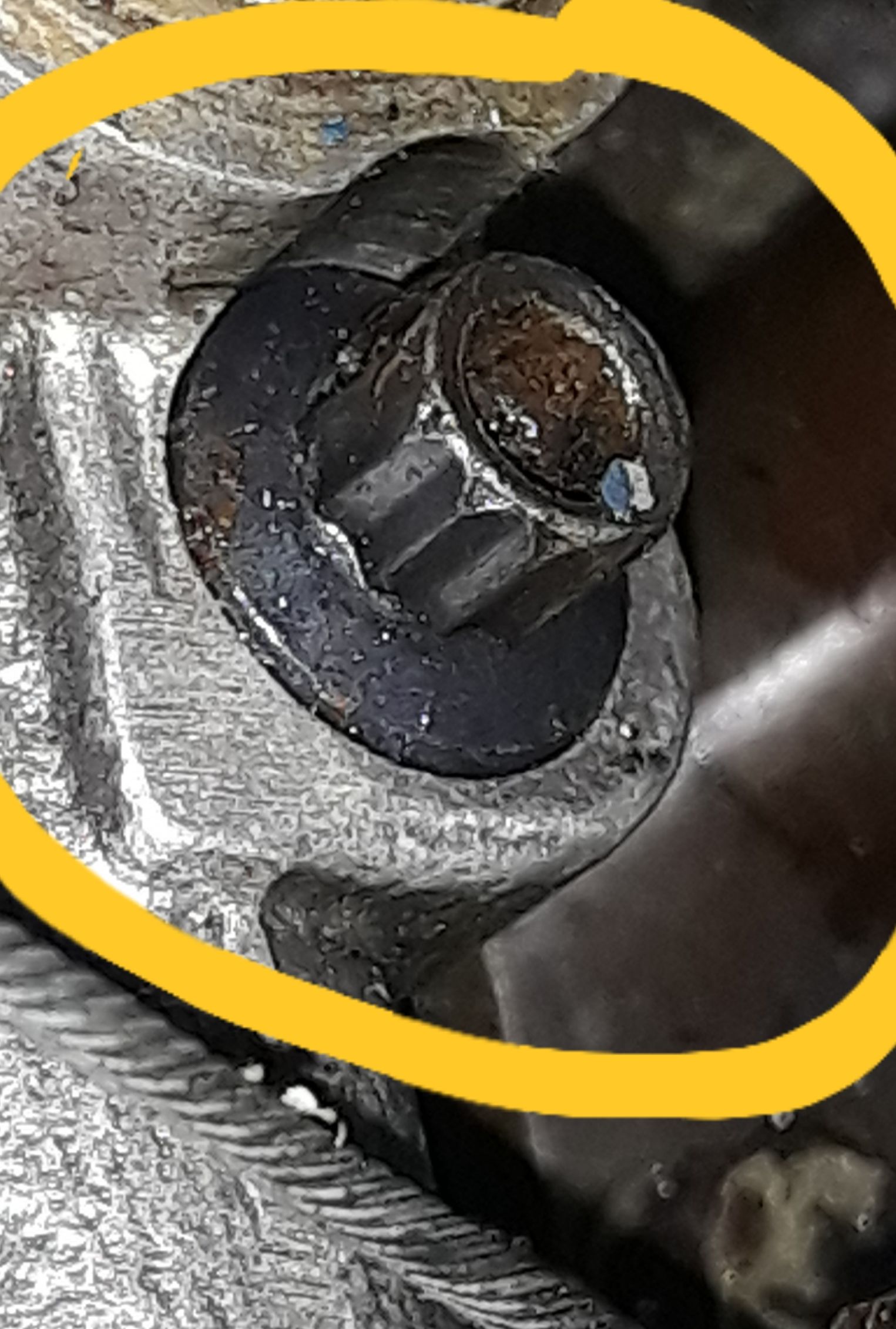

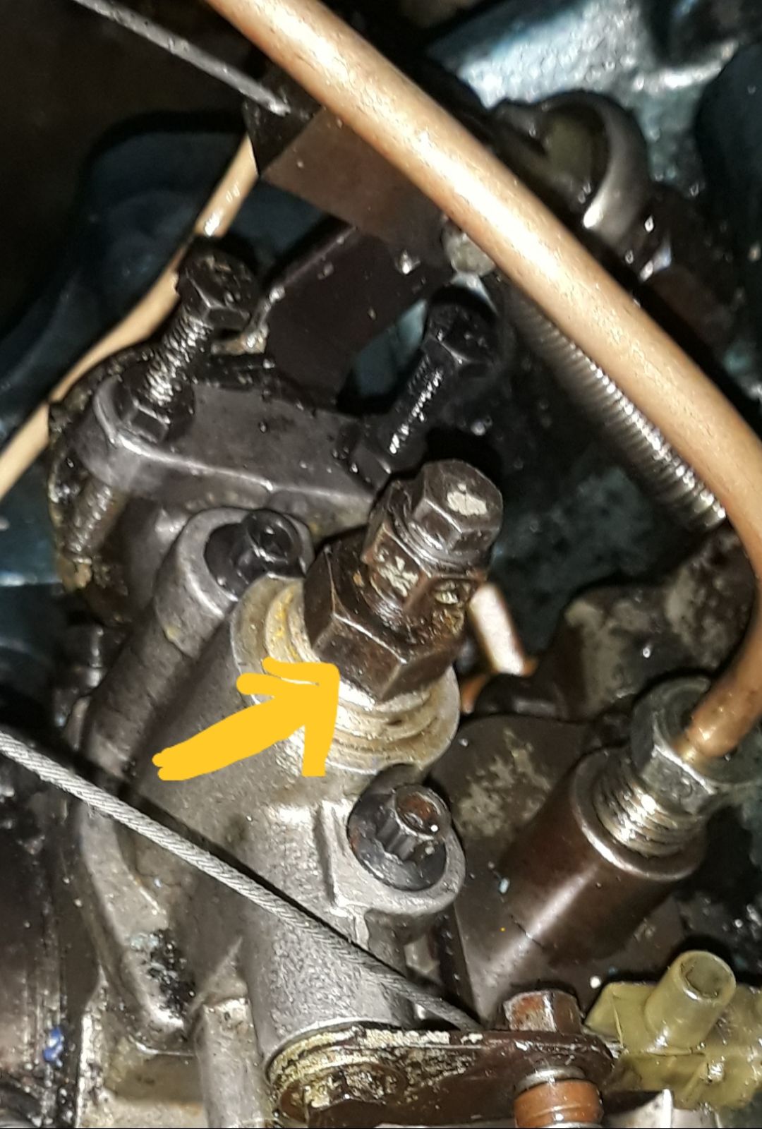

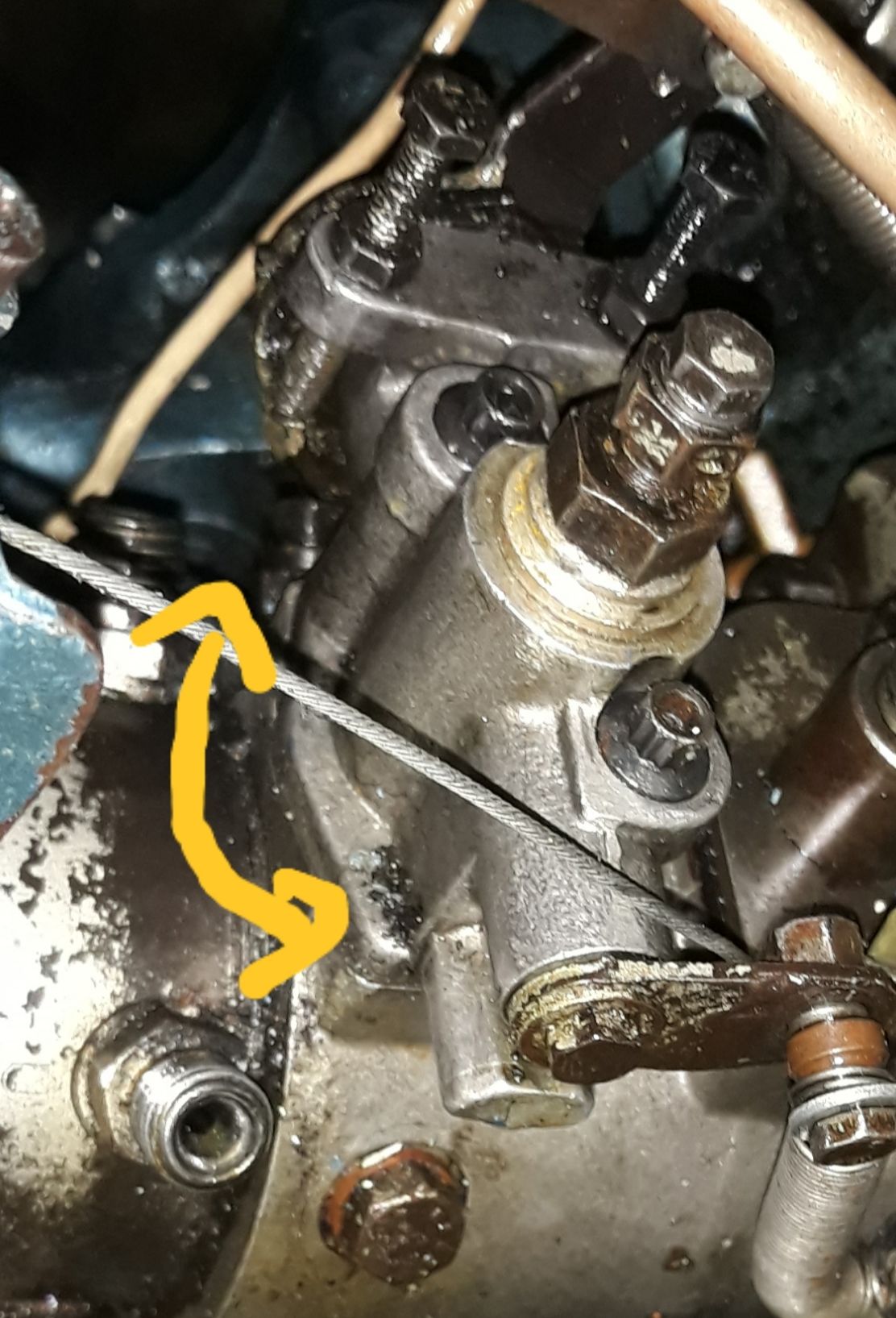

    I think I may have confused things. The first photo with the arrow points to where the fuel was leaking from. On the second photo with the arrow I have circled the spindle I am taking about. This is the part I was trying to take out. This is what turns but doesn't seem to come out. I was told it is a spindle and inside would be a small o ring that may need replacing. Is this correct? (I will post a photo of where the play is in the next post)

    Yes sorry, it was a bit muddled. I now understand a bit more. The governor assembly has slight play. I thought maybe that the 12 point screw needed tightening but wasn't sure what tool I needed. The leak seemed to be coming from the large nut at the top of the housing. This is the one that turns but doesn't come out.

    Just one thing I'm not clear on: "you can turn the 12 point screw and it won't come out" Do you mean the spindle on top with 3 nuts (the larger nut at the bottom) or the smaller splined one on either side? Thanks for all the advice and info, I really appriciate the help! I will read through it again and make some notes. I've had the boat since April and the engine has always run without problems. It was last week for the first time when it cut out. I'll go through the steps and see if I make any progress. Thanks!

    I thought I needed a special splined socket. What size spanner would I need? Idon't have anything small enough.

    Initially I thought it was the fuel filter but it wasn't even dirty, I changed it anyway. I haven't the inlet filter. The main problem seems to be the leak from the spindle on the top, plus the housing it goes into has play in it.

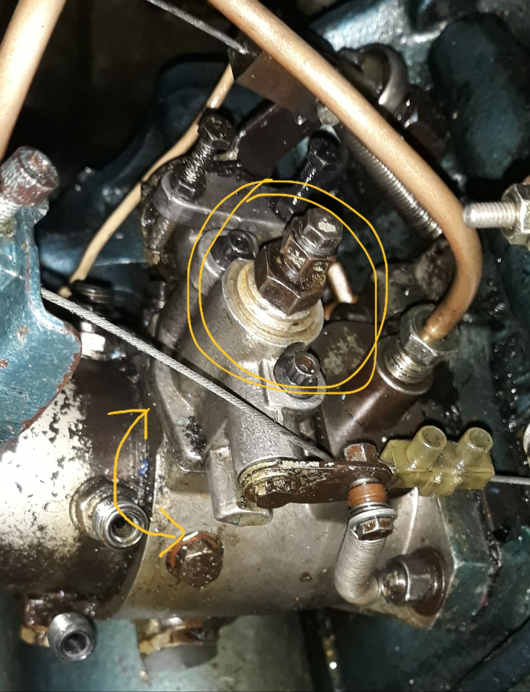

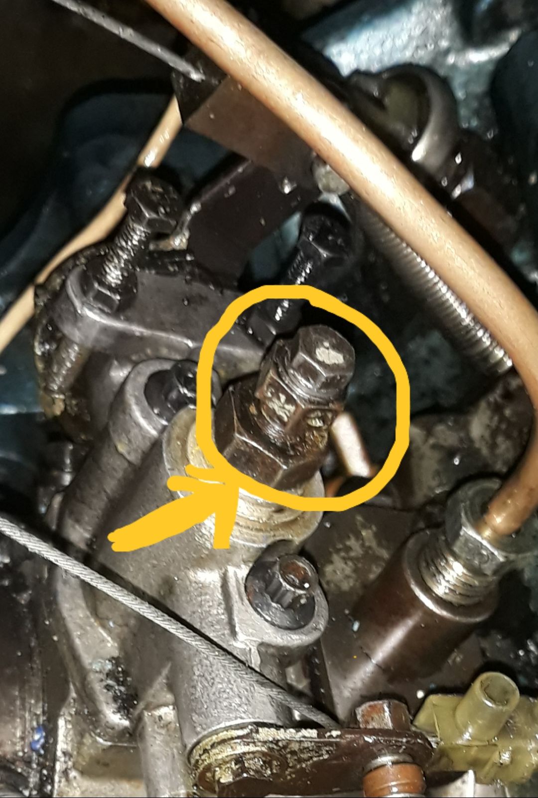

    I emptied the water trap and put a small amount of deisel back in. I also changed the fuel filter. The steps for bleeding the system were done after. First I primed the lift pump and undid the nut on top of the fuel filter until the air was released and fuel was flowing then tightened it up. Next I undid two injectors and again pumped the lift pump until air was released and fuel flowing and then tightened them back up. The leak is coming from under the biggest nut of the spindle on top. I've added a new pic and circled the spindle I am referring to. The arrows indicate where there is slight movement. What do you think? Just checked the fuel tank and I have 4 inches of fuel which amounts to about 16 litres

    Hi. I have a bmc 1.5 that recently cut out after eractic revs from the engine. Bled the system but unable to start it. Looks like I have air escaping from a bolt on top of the fuel pump, there is a thread with a big bolt at the bottom of the thread and a smaller one slighter higher and then a small nut right on the top. I tried to remove the bolt as was told it may just be an o ring that needs replacing. The bolt turns but doesn't seem to come out, also that whole bit that the bolt goes through has slight play. Do I need to remove the small multi spline bolts that hold it in place and if so what tool do I need? I'm stuck as to the best way forward and live aboard so really want to get it running. Any advice would be much appreciated!!
