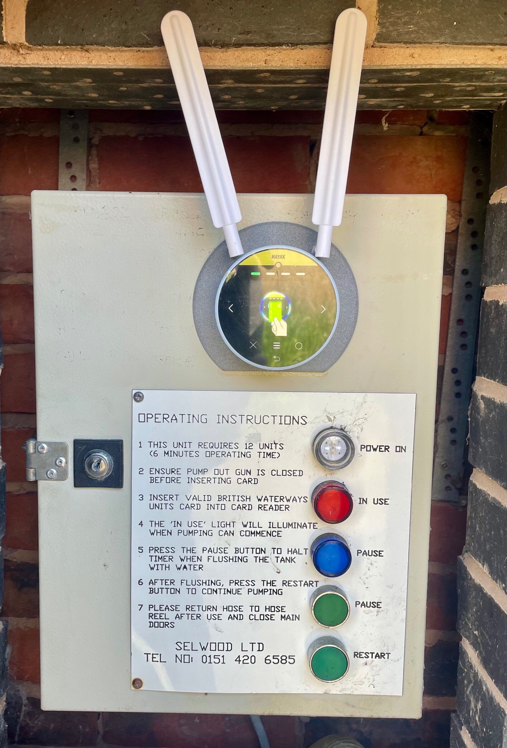

Yes the antenna aren’t great, having said that they are tucked away at the top and in the case of the machine at Anderton it would have been very difficult to hit them with the pump out hose. My biggest issue is, if this is supposed to be a trial CRT could have presented it a little better. By that I mean amending the old instruction plate to reflect the new card reader and perhaps putting a notice in the cabinet explaining that it was an evaluation and perhaps providing and email address so people could give their feedback. -
The latest CRT boater update announced the trial of contactless payment pump out on a handful of machines in the North West which if successful would be rolled out nationally. I came across one today at Anderton Services. Initially it had me confused, mainly down to CRT failing to update the already outdated instructions on the machine or explain what the new gadget was. I have to say, however, I thought it was a vast improvement. It will accept and contactless payment card and you can also use your phone, as I did, if you have it set up for contactless. It worked flawlessly. My only worry is what will happen if I don’t manage to use the old style cards I still have before the old machines are phased out. Will I get a refund or credit from CRT I wonder? I hope they’ll think of that one.

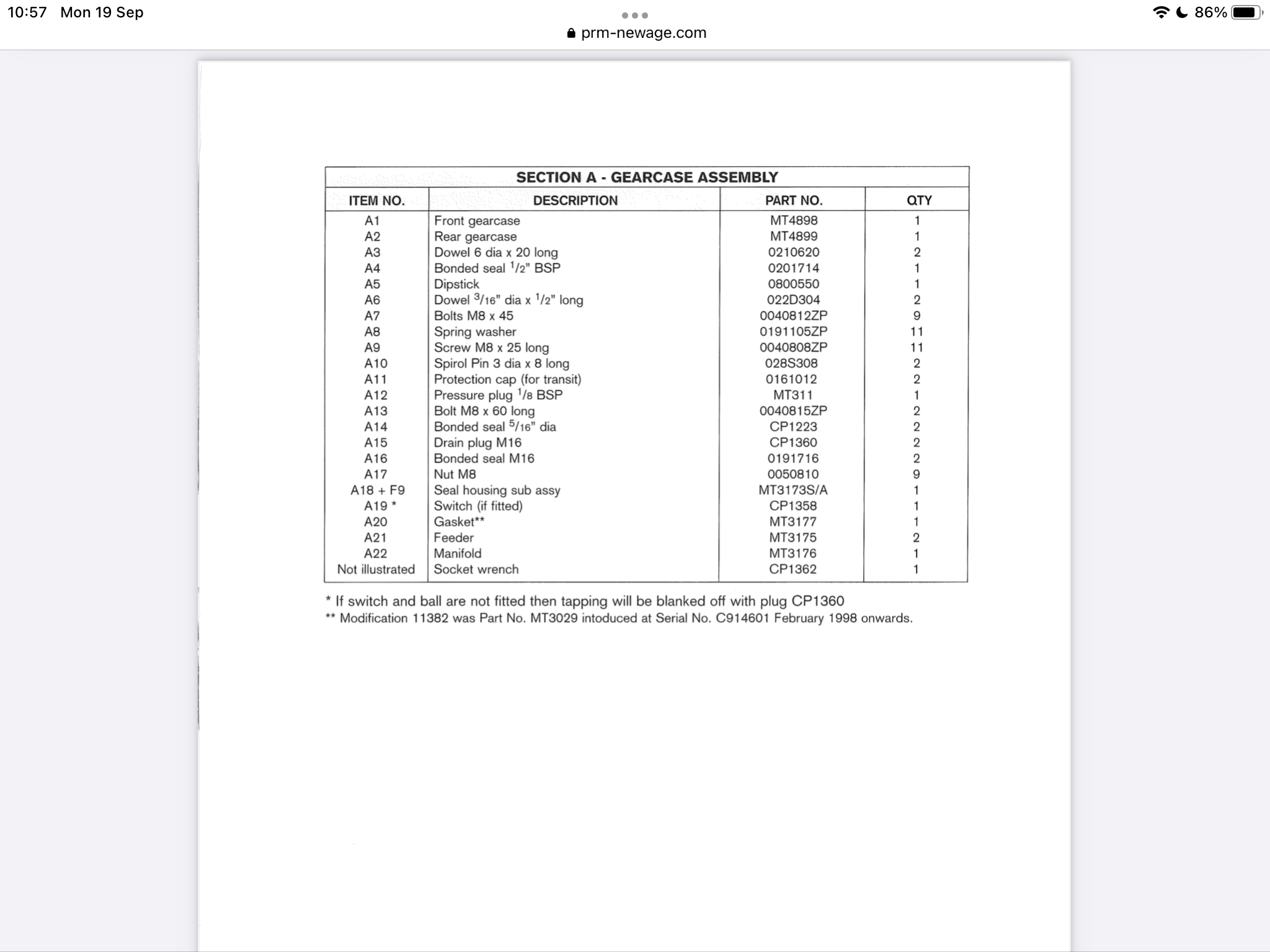

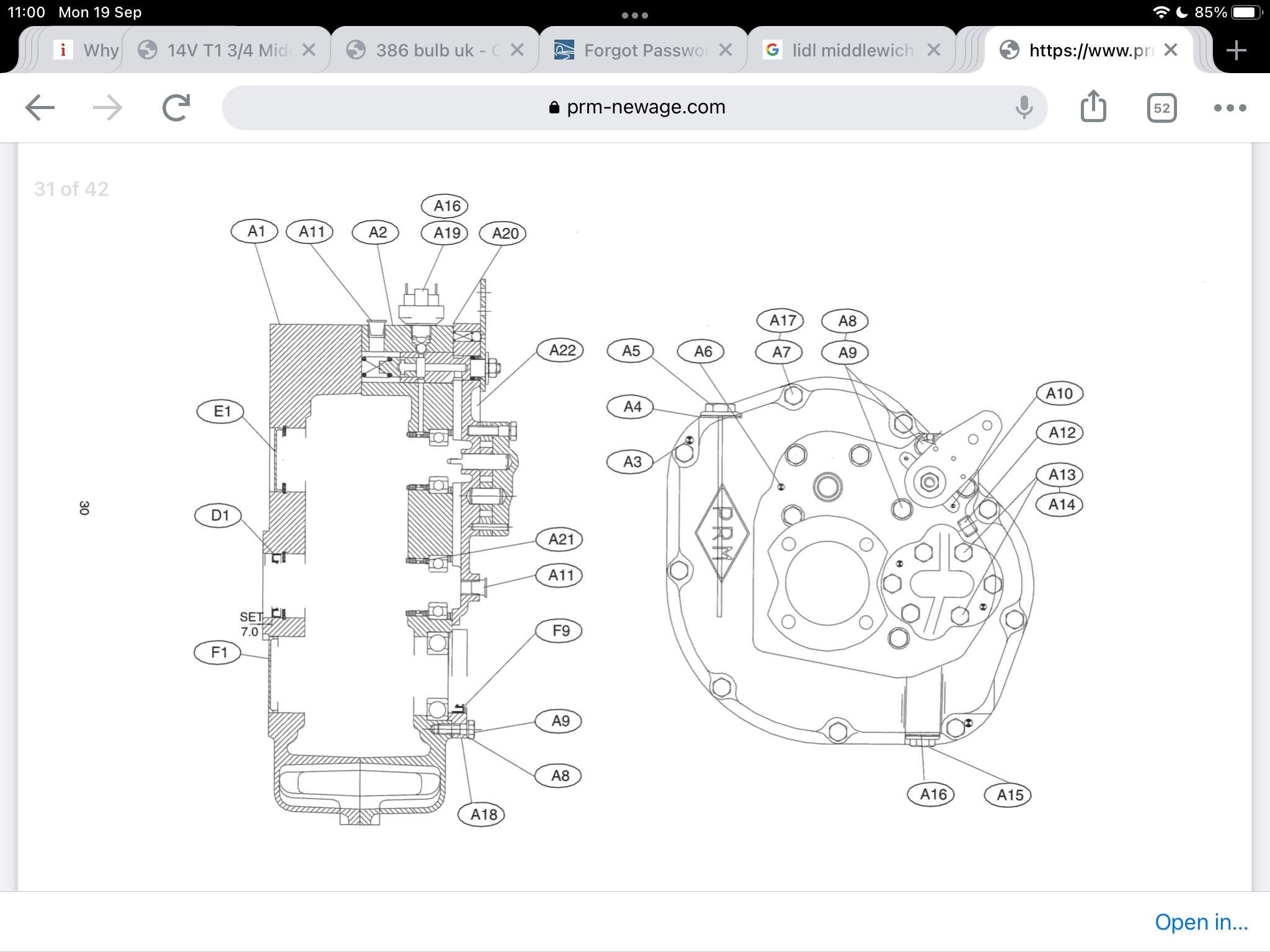

Yes I thought the dipstick one wouldn’t be critical as an oil tight seal. Perhaps PRM fitted it for that reason and because it would be more durable in day to day use? I’ve just checked the parts list and a 1/2 BSP Bonded Washer is listed as the dipstick seal. Out of interest, here is the list and diagram I’ve been referring to… -

I need to get some sump plug seals for my PRM 150 Gearbox which was first commissioned in 2005. I downloaded the workshop manual from PRM which specifies an M16 Dowty Bonded Seal (part number PRM 0191716) as you’d expect the genuine PRM seals are expensive when I see generic M16 Dowty Bonded Seals are widely available elsewhere at a fraction of the price. Before I bite the bullet and buy the genuine PRM seals I was wondering whether other owners have used generic seals without any issues? If so, any recommendations for good quality aftermarket seals?

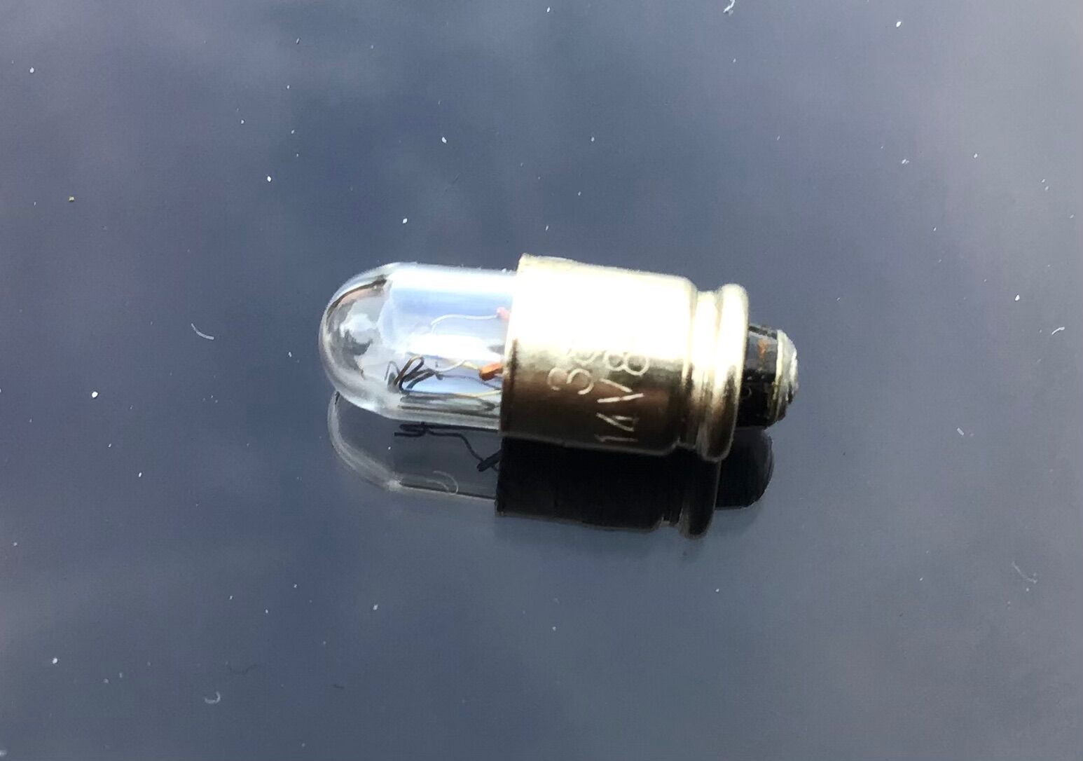

Thanks. Yes he was indeed right. After some very gentle prising the cover came off. Not so much a cap but more of a ‘plug’ shaped arrangement with a silicone seal beneath. The bulb was the real issue to get out. The rubber tube method failed in this case, not enough grip. In the end I used tweezers with the ends covered with two rubber float caps from my fishing tackle box to provide the grip. The bulb is a tiny type 386 ‘midget groove’ 14v bulb. These are still available on the web as panel lights, however Vetus do also sell them in packs of five and quite reasonably for them! I’m near the Vetus dealer at Kings Lock, Middlewich, later today so intend to drop in and see if they have some. This was mainly why I was keen to get the bulb out, so I knew exactly what I was looking for.
