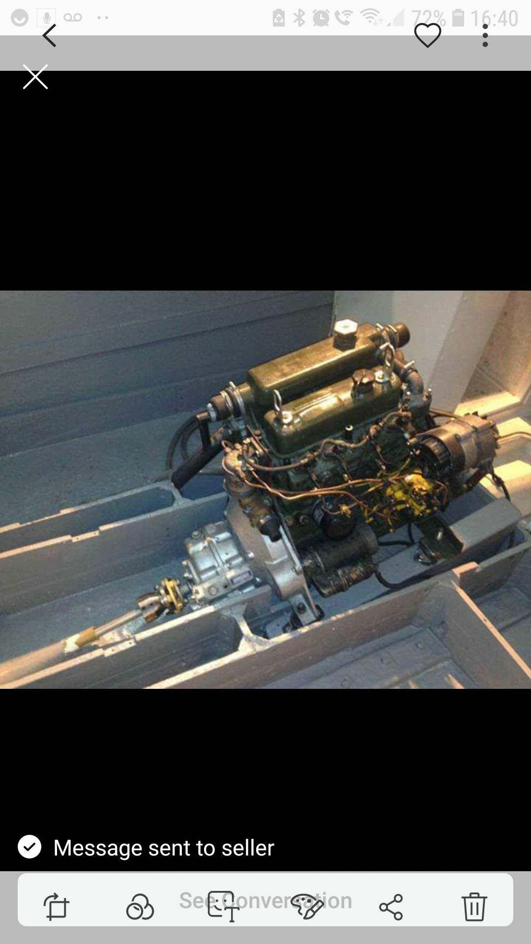

  23. We have had issues with our original BMC 1500 since buying our 48ft cruiser stern project boat with overheating, smoky and noisy, fluid leaks & general reliabillity issues. And has to be said what seems like an overly complicated system with a large car type fan radiator and two skin tanks one either side on each swim she also has two fuel tanks one each side but with only one filler cap. I understand she was previously an ex hire boat We have recently obtained a Heat Exchanger Raw Water cooled BMC 1800 which was refurbished on a millitary seargeants budget with resources availavailble Which we plan to fit when we get into the marina at the end of August after a total clean and refurb of the engine bay. Ideally we would like to convert to skin tank cooling as drawing water from the canal is not reccomended What are the nessacary steps to convert to skin tank cooling. Any advice much appreciated The BMC 1800 recently aqquired for £1000 in a nice millitary green 😎
