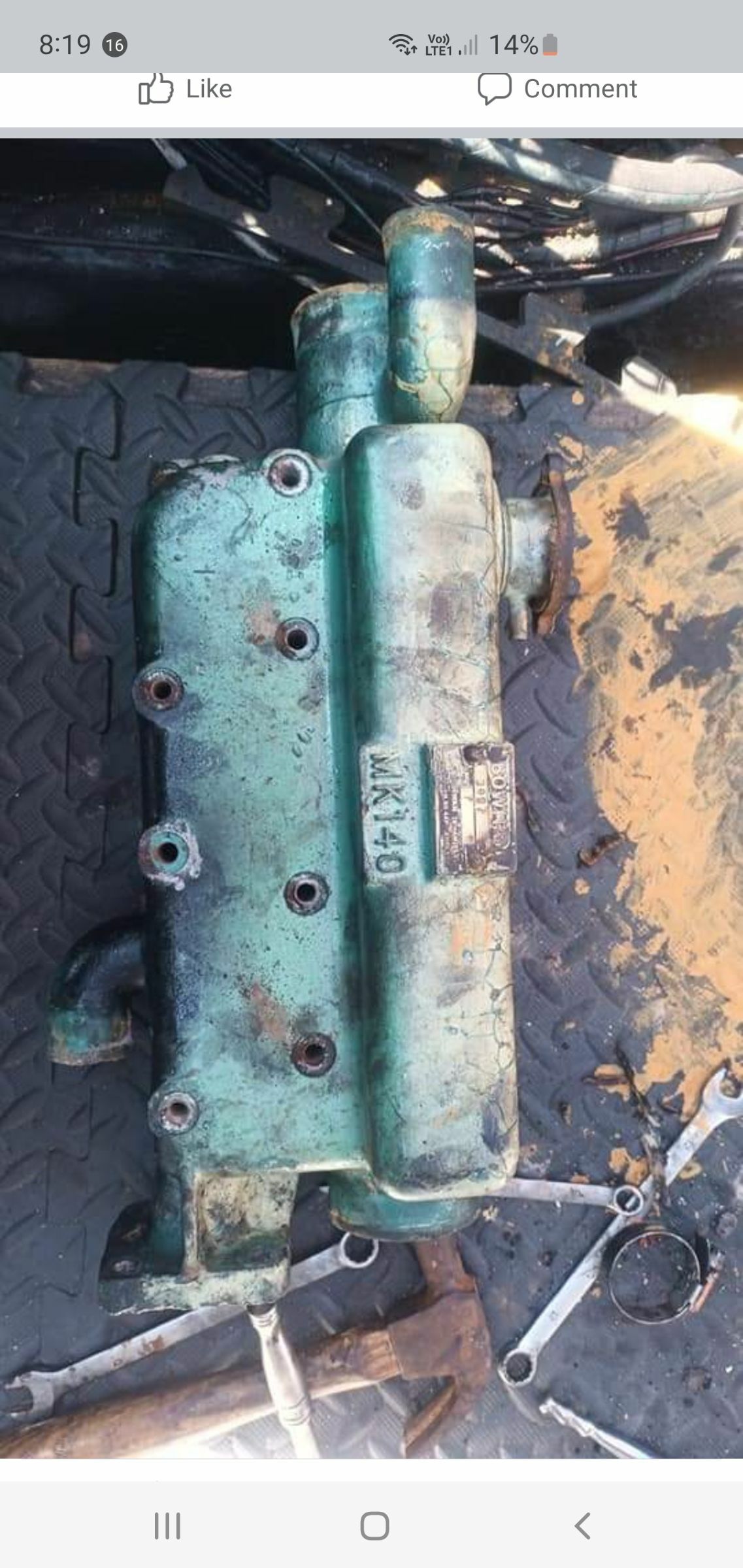

  4. As said a friend asked and I said someone will know. As said a friend asked and I said someone will know. It's a Thorney Croft T80 based on a Mitsubushi K4 D so Mr Darth is correct anyone know of a Heat Exchanger for one please?
  5. Looking for one for a friend in need!!! https://www.facebook.com/groups/boatscrapyarduk/permalink/1244958112809000/

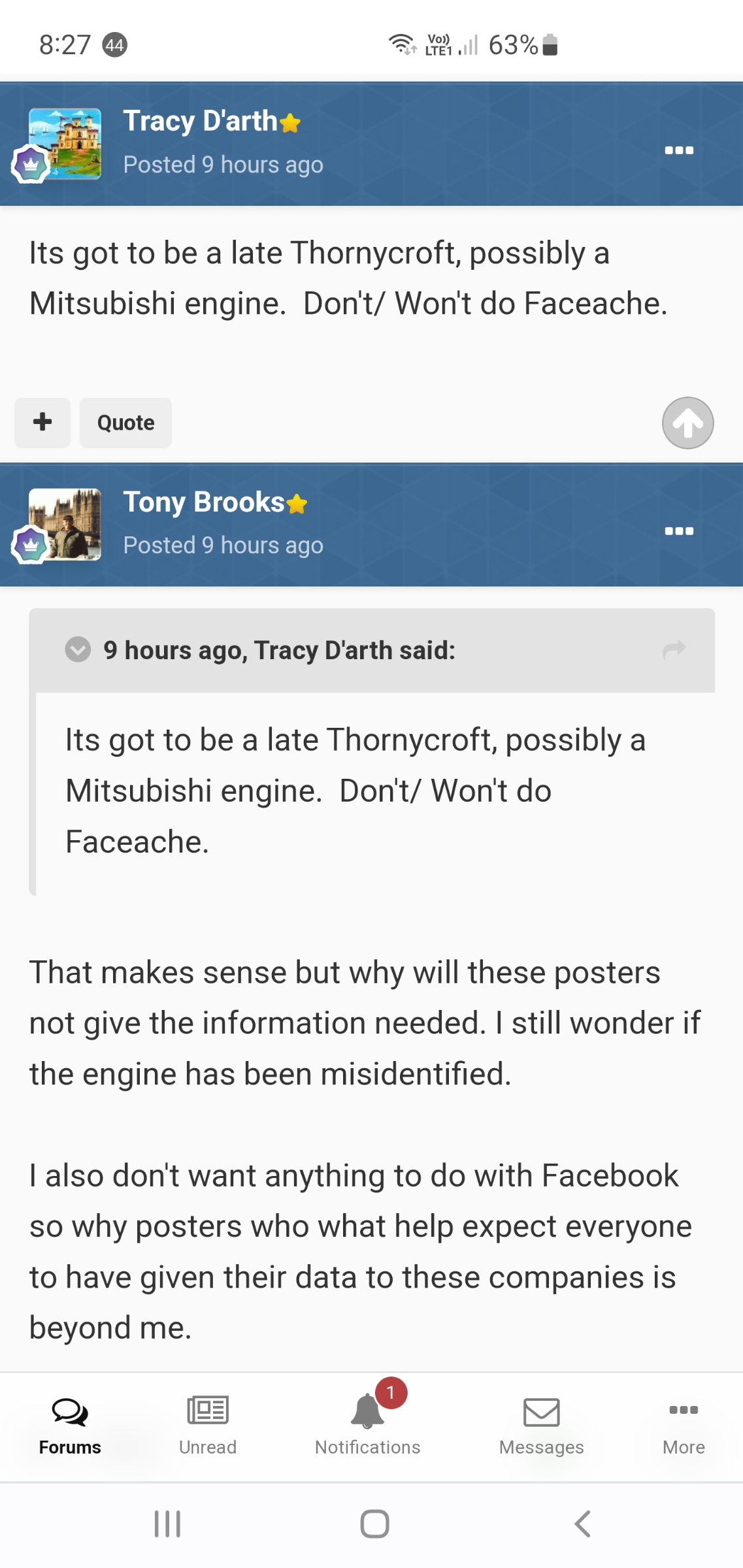

    1. Tracy D'arth
      Tracy D'arth
      Please do. I will respect the confidentiality.

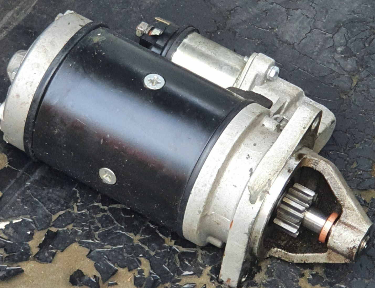

  17. Hi Mr Darth Yes they are in Parallel now the battery switch either 1 or 2 or both was changed 2 months back to the Tractor type either ON or OFF. batteries wired in line. They are Leisure batteries. 110amps The last paragraph I will have to look into. Thanks for your time. Picture are to large of the solenoid it looked like it had been shorting out. I have cropped images on my phone so hopefully I can upload from that
  18. I'm still having starting problems when starting from cold.Once fired up it's fine all day. It is a reconditioned engine ,It now has a new CAV injection pump as the one supplied was not fit for purpose.The seller purchased the new one and had it sent directly to me from the wholesaler. It never seems to spin over fast enough when cold. Batteries 2x110 amp are Fully Charged 4 years old. I had the starter looked at by a local specialist he renewed the solenoid as it showed signs of a lot of wear .I have a picture and will try to attach it. This however didn't fix the slowness of start. The guy who is helping me suggested there may be a power drop. So I have purchased so 50mm cables to run from batteries to starter. They have not yet been fitted as he has got the lug crimper at home and not down in Torquay. What someone asked is it the correct starter? Do 1.5 starters fit a 1.8 and are they the same Amps Output? If they are different this could be the cause. I also realise a recon is tight when newly refurbed I have put 30 hrs on the clock since fitting. Any thoughts would be most helpful. Thanks Nigel
