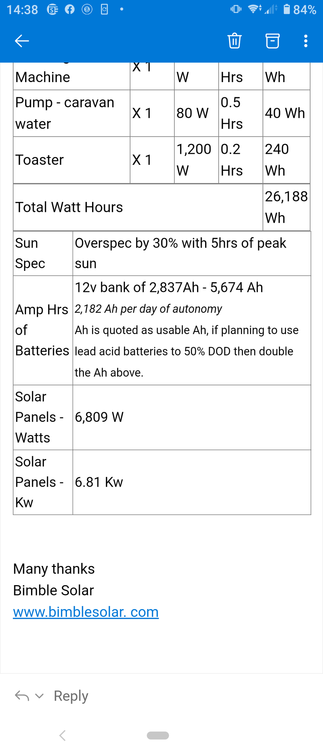

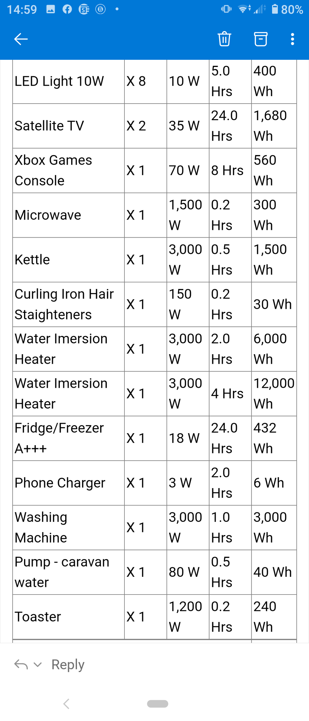

  10. As per my last post. I believe that I have calculated correctly and it would appear that we are at about 90AH per day. We are not going to be using the kettle, microwave or toaster. We have had a quote for a 12V 640W Complete Boat Solar Kit With Mono Panels. Works out at £750 for everything.
  11. Thanks for all the helpful replies. I can see that I was over reaching my expectations of solar power. We will make the necessary adjustments and we will go for panels in the near future. For those of you that said I had no clue and needed to understand solar power/electricity....guess what? That is why I asked the question. Not the first time that certain people on here have spouted their superior views. Never known a forum quite this bad for shooting people down.
  12. There is a mistake. TV is on for about 5 hours.
  13. I am proper confused. We used their calculator in order to work out what we would need. None the wiser.
