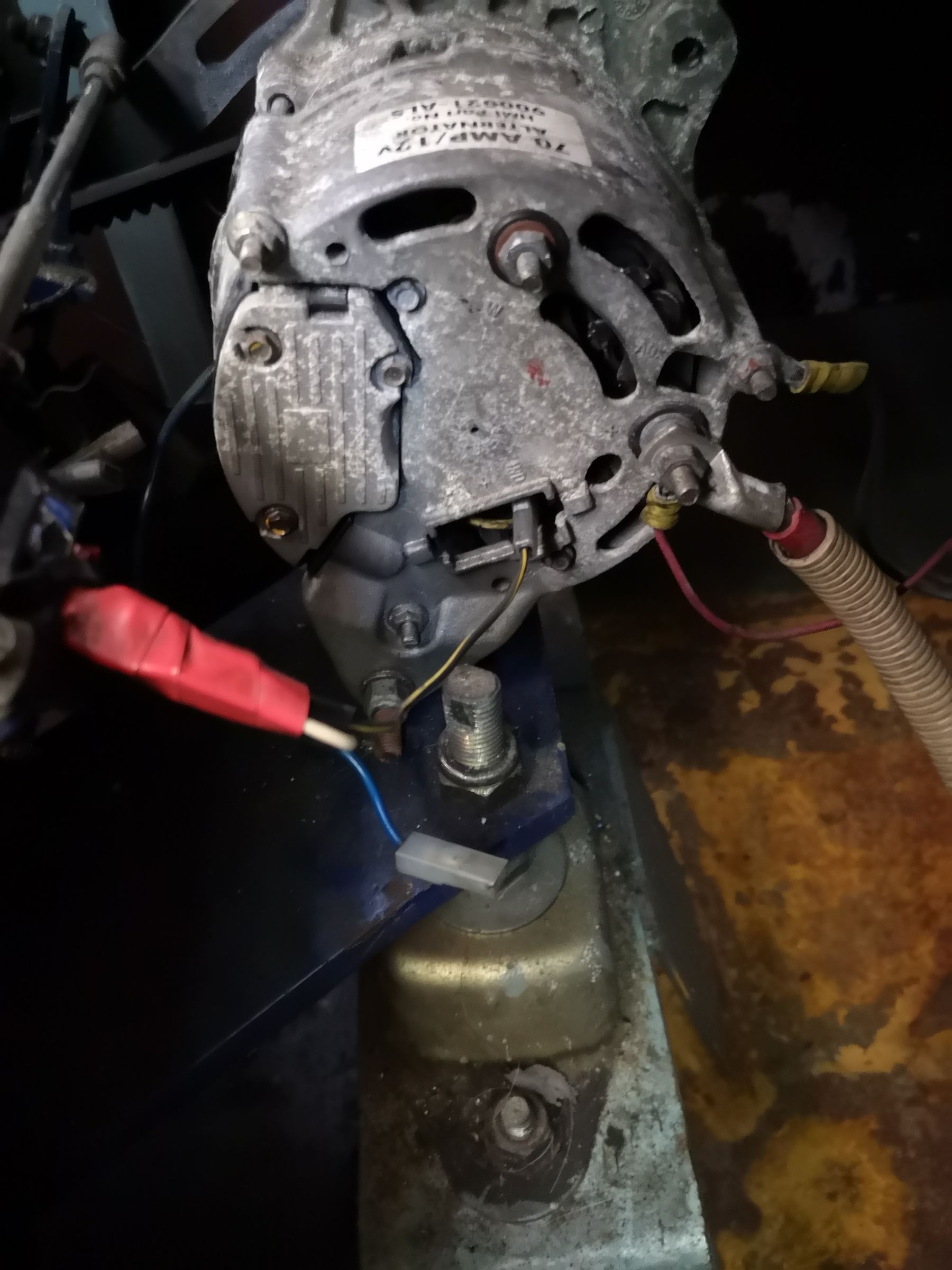

Thanks again. I'll check engine mountings in the morning. I assume these are the"feet" on which the engine is bolted to the hull?

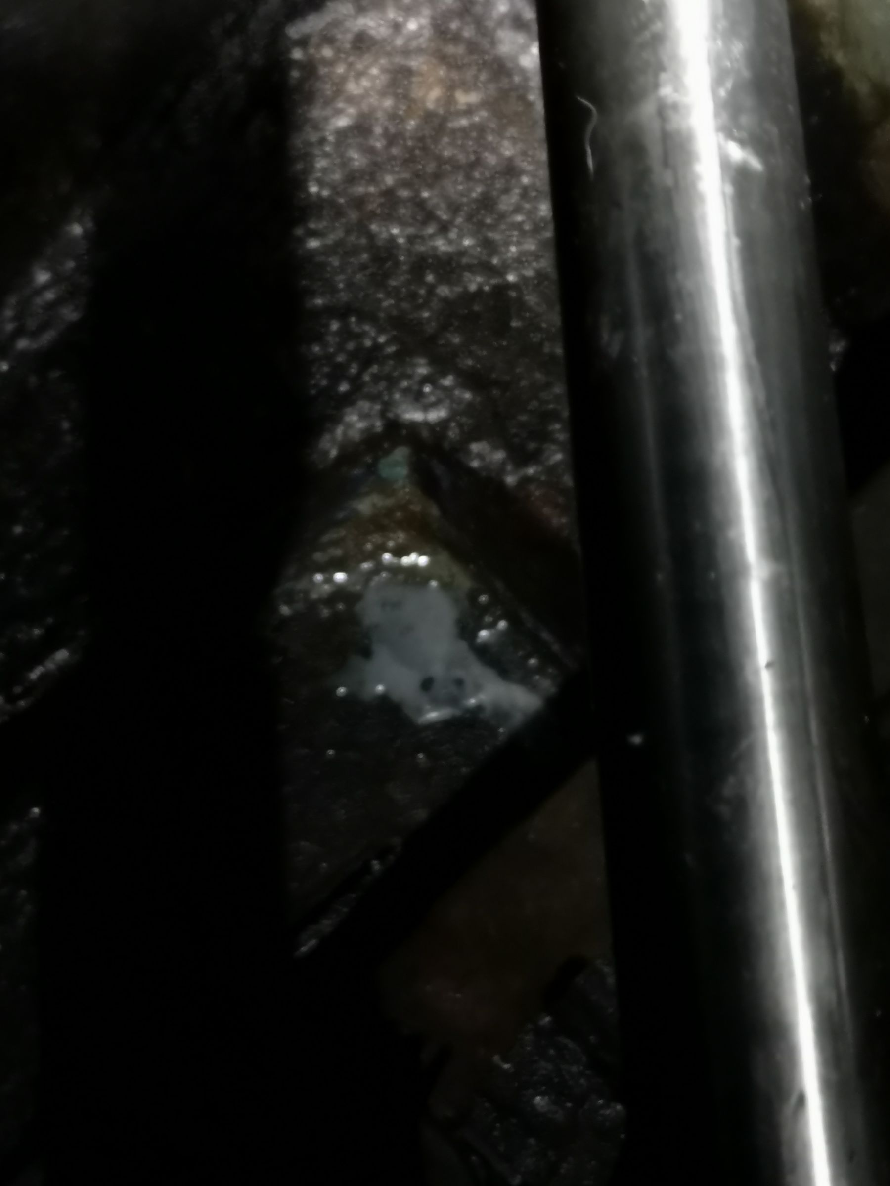

This is really helpful Catweasle. I'll get some silicone grease tomorrow and start the process of flushing out the K99. Would you suggest l do this for a few mornings in a row until the the"white" coloured stuff stops coming through?
Thanks to you all for such a quick response. Concerned that I was advised by a chandlers to use K9. I assumed this was sylicon, but obviously not. Will the K9 do any damage?

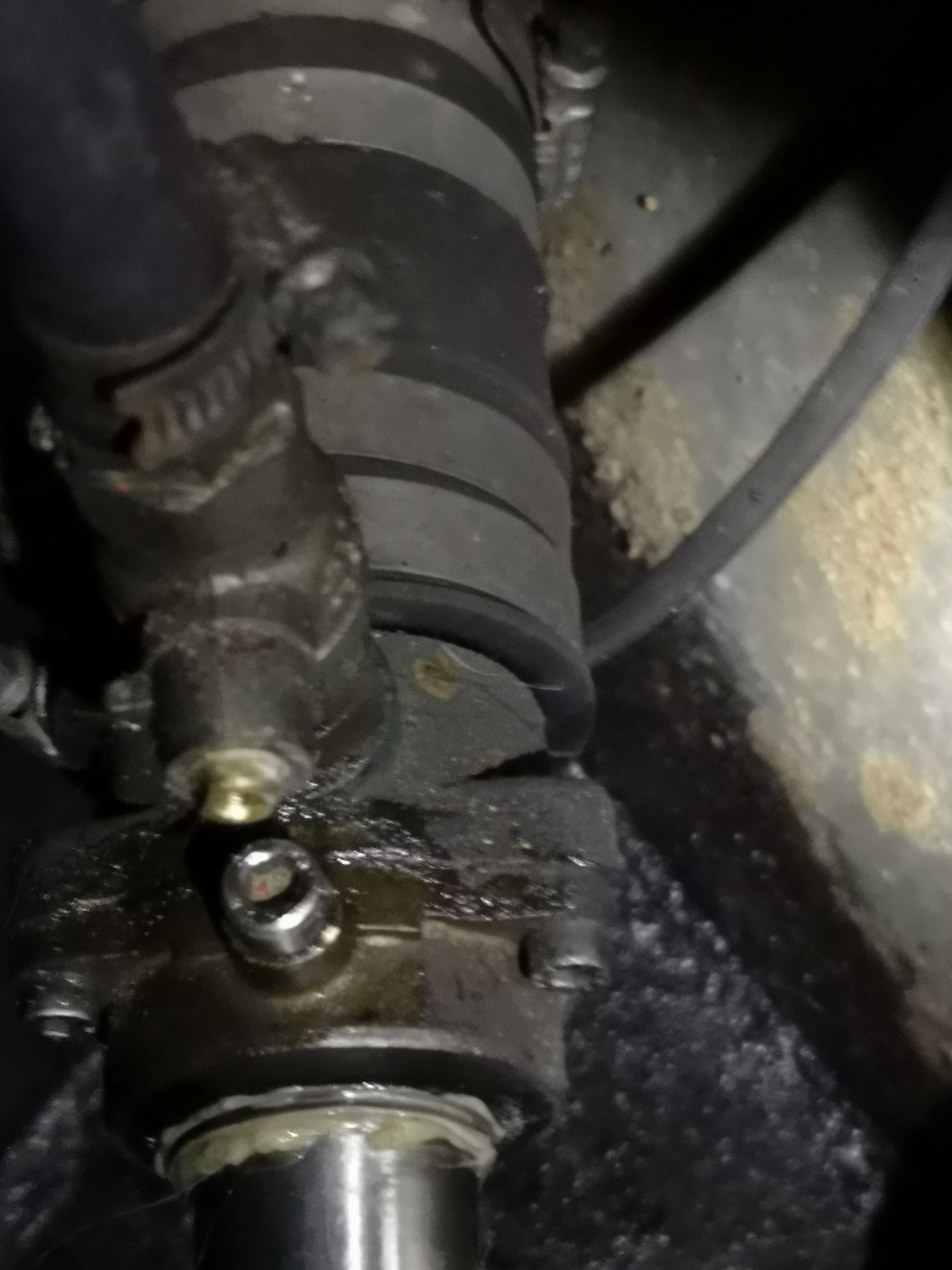

Recently posted about a slight leak from my water cooled stern gland. We're currently 2 weeks into a 5 week trip. I've put in more k99 in the hope that might solve it, but to no avail. Difficult question, but would it be ok to continue like this for the reminder of the trip, or do I need to get it looked at? Any suggestions would be gratefully received.
Sorry, meant alternator?
Thanks for the prompt response Tony. Excuse the ignorance, but could you elaborate a bit more on "prop fouling" and "alignment" please?

Hi,
Just noticed a very small leak from my water cooled stern gland. I'm told that taking off a small nut with an Allen key and injecting a bit of silecon grease may solve it. Does this sound right or could it be more serious?
Thanks
