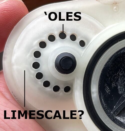

It would seem so as everything is running (better than) normal now with the new pump. At some point I'll have a go at the old pump and see if I can bring it back to life for an emergency spare, as George and Dragon mentioned. -

Update: I’ve replaced the pump! It’s all working perfectly now. I also added the filter thingy that the previous one didn’t have so that will hopefully help in the future. Thank you everyone for the help! For those interested, this is the pump I got: https://www.foxschandlery.com/jabsco-par-max-2-9-pressure-controlled-pump-12v-40psi?gclid=EAIaIQobChMItauigMSV9QIVzN_tCh1IsQCiEAQYAiABEgKg0_D_BwE -

Reporting back! I stripped it back as far as I thought I safely could without breaking anything, and It really wasn't terribly mucky at all. There was maybe 2 or 3 teeny bits of debris in the 'holes', which I removed hoping this would fix it, but no luck. It looks like there could be some limescale build up behind the plastic 'seal thing' but I don't think I can get to it without breaking it and leaving me with no water. A new pump is £79, so we might just go for that for now and then I'll have a bit more confidence tearing the current one down further, and we'll have a spare! -
