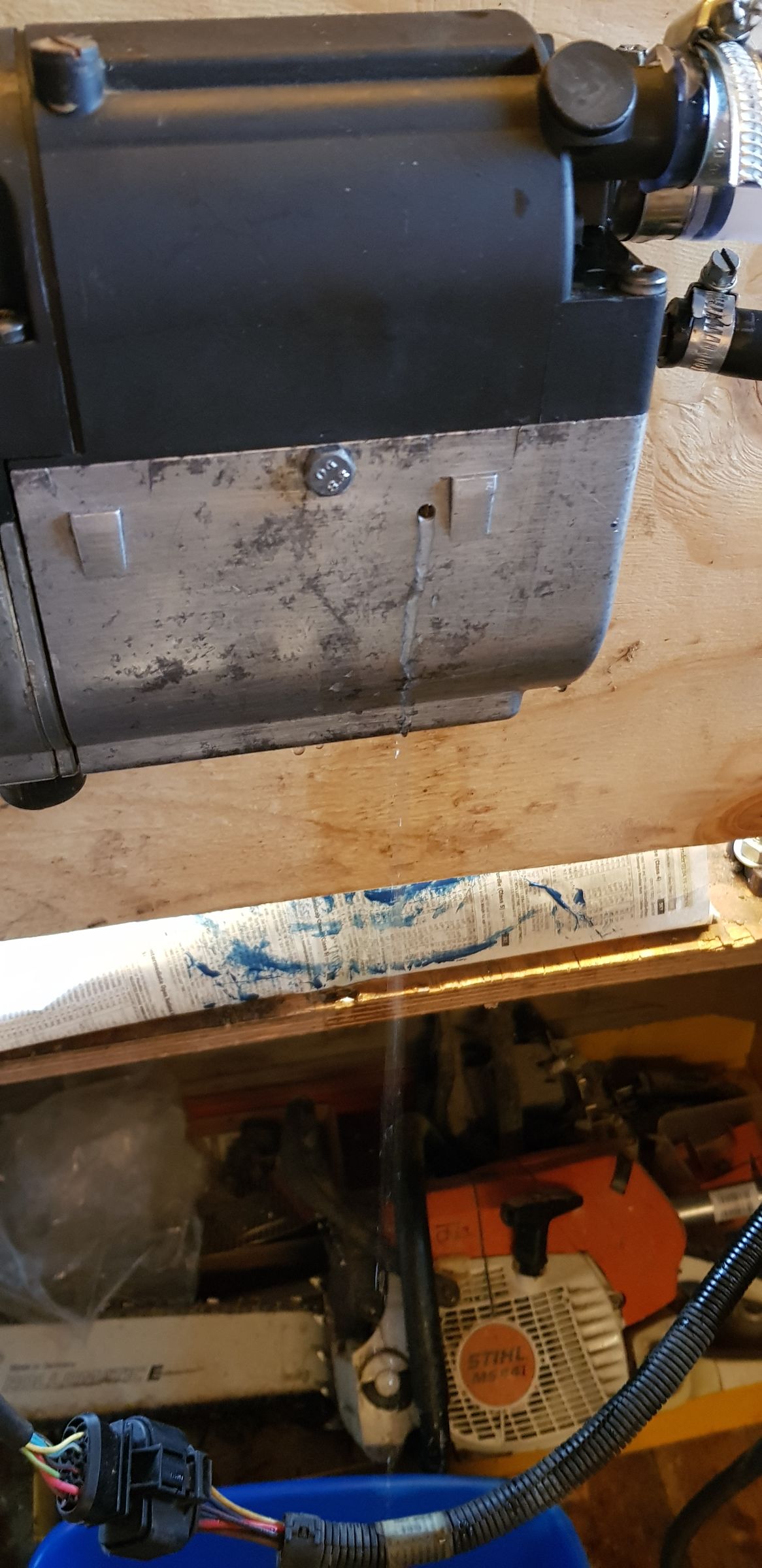

  3. Ok folks. Thanks for your help. They do say I have Markzheimers. I assumed that the 3 screws in the bucket were from somewhere else. It is typical of me to take sensible precautions....and then forget what precautions I'd taken. Those precautions were to put all screws, bolts, seals and anything else in a certain place. The water pumpleaked into the chamber above the metal housing between the burner and water interface. It came out of the hole as seen. I've now fitted it and tested it. It works great. Hot water for the 1st time since buying the boat. I'm t gave me a lot of confidence knowing that with your help it can be done. I'll need to get the GSM gate opener too.

  5. Ok folks. Thanks for your help. They do say I have Markzheimers. I assumed that the 3 screws in the bucket were from somewhere else. It is typical of me to take sensible precautions....and then forget what precautions I'd taken. Those precautions were to put all screws, bolts, seals and anything else in a certain place. The water pump leaked into the chamber above the metal housing between the burner and water interface. It came out of the hole as seen. I've now fitted it and tested it. It works great. Hot water for the 1st time since buying the boat. I'm t gave me a lot of confidence knowing that with your help it can be done.
  6. Well it is water from a bucket as I set it up on a jig in the shed. Having said that , I took it apart and found the problem. I wondered why those 3 screws werel eft over...not really I have markzheimers. They were the screws for the water pump. Oops.
  7. Ok folks. Posted on here last night about a similar topic i.e. the eberspacher but that was electrics and that bit is sorted(until I get it to the boat at least). I've serviced it and the only seal that i didn't change was the big one between the burner chamber and water jacket. (My description). I thought it would be asking for trouble and now I'm thinking I should have taken the trouble. The good news is it's in my shed set up and works. Can anyone tell me what this "tell-tale" hole is for?
  8. Ok. I'll take it apart again. It's not the bracket hole. It wasn't doing it last night.
  9. Thanks for that. Something to think about after I've got it working on the boat. Meanwhile another problem has arisen. Just started it up and there was a load of water coming from a tell tale hole which I presume is there for the very purpose of telling you that there's a seal gone. Which seal has gone. I'll put a picture up.
