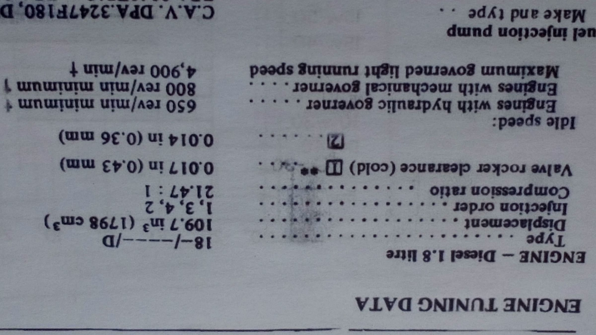

    I idown loaded it from inter net so im not sure just need to no in psi that what my compreoin tester is in

  12. Carl123
    Engine
    Thats in my manual sent photo so if the compression on my engine is at 300psi is that good or bad. Is that why its breathing heavily

  14. Carl123
    Engine
    I looked at the manual all i can make Out it should be 21 cm i could be Wrong if anyone knows what the 1.8 Compression should be please
