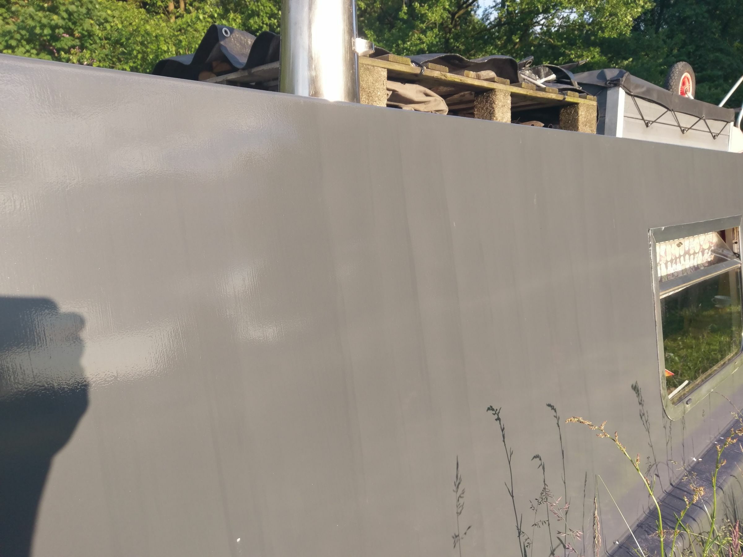

  15. Thanks for the comments. I did speak to Craftmaster who said the owatrol should be fine, but I think I'll buy their thinner for the next coat. I like the paint and that Speight feller knows his business. Thanks for the advice about the polytunnel humidity and heat concerns, you're probably close to the mark there, the heat levels change just like that and I reckon that caused the paint to separate. I didn't want to go to the effort of another coat without picking your brains, so thanks to all those who read the question, I'll embark on more back breaking work on the cut this time. Cheers all, any more bright ideas let me know. Craig
  16. Hi all Another paint question I'm afraid.......I've just had my boat in a polytunnel for a week. I put two coats of craftmaster high build undercoat on, then two coats of the craftmaster coach enamel in graphite grey. I thinned it with owatrol. It was applied with a mini roller then laid off with a brush. The undercoat went in fine but topcoat came out streaky all over as you can see from the photos. It wasn't caused by the laying off, it was like the pigment separated all the time. I stirred that paint plenty with that drill stirrer thing and kept stirring all the time to no avail. So, I'll be putting a third and hopefully final coat on at some point this summer. How do I avoid this happening again? Was it the heat in the poly tunnel? Is it a problem with the paint, or have I simply offended the Gods? I know some of you guys know your paint, what do you reckon? Cheers for any help, Craig
