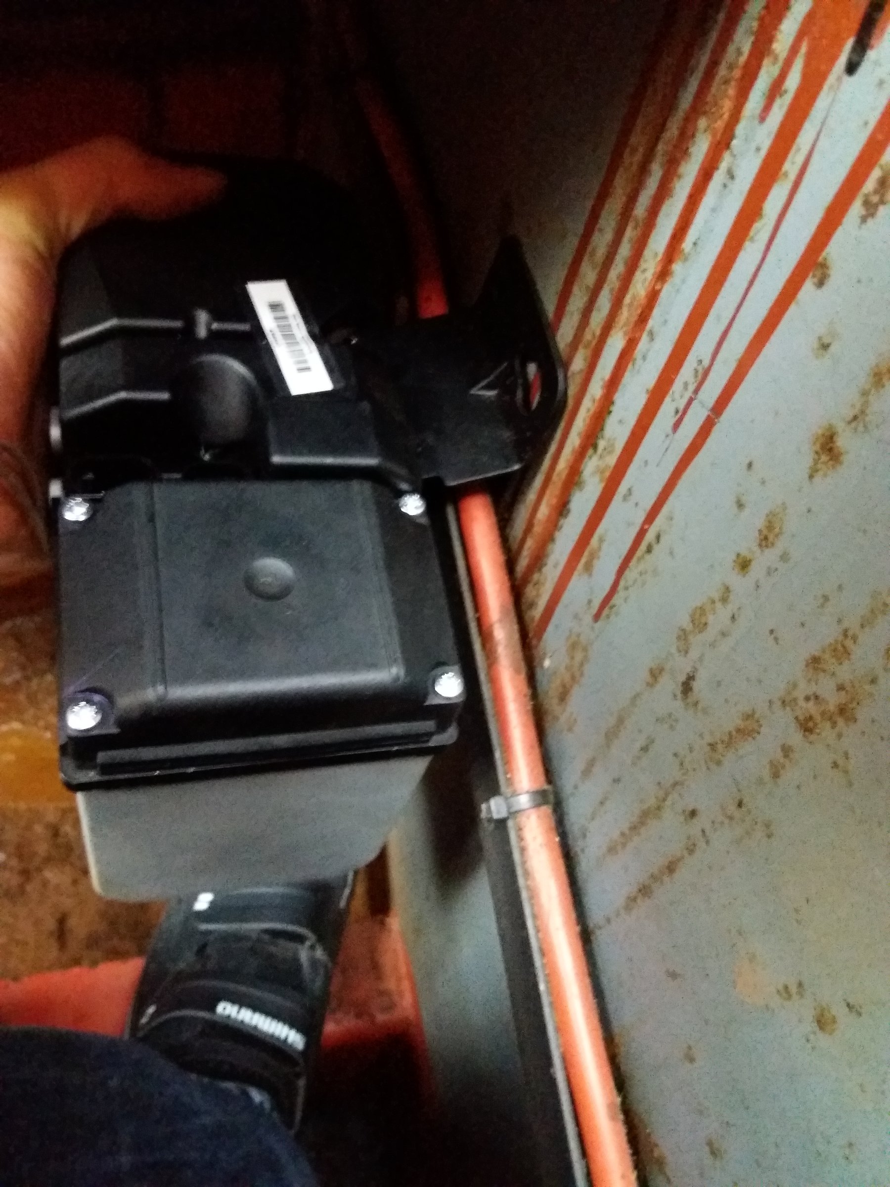

Another thing is the bracket supplied looks different to the other I've seen in pics. It has unequal standoffs so thatit won t be sitting at 90 degs to the wall. Here's a pic:

Me again! I've almost got all the bits to do the install! Just need to order the fuel pipe. I was looking at how I'm gonna mount the unit itself today and the best location would require me to straddle the battery to consumer unit cable run (fat cables zip tied to angle iron) with the bracket. It won't be touching the cable as the bracket plus anti vibration noggins will stand it clear by a good 5mm. Would this violate any regs? I'm not worried that heat would affect the cables. They're kind of shielded by the angle iron they're clipped to. I'll try and post a picture later.
