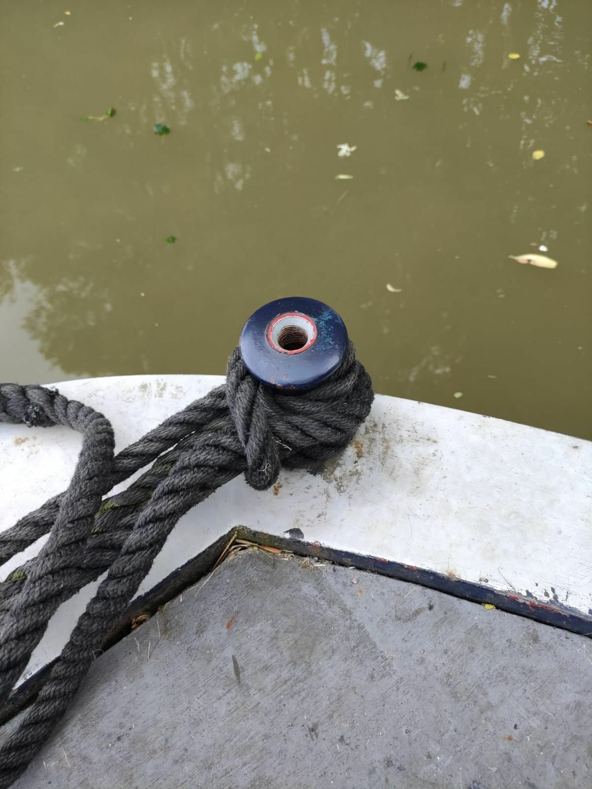

Stern dolly - centre plug missing, help appreciated
Capnbob replied to Capnbob's topic in Boat Building & Maintenance
To complete the story for anyone who turns this thread up on a search, I did eventually track down the right item. It's a 1/2" BSP fuel tank vent, like this: https://shop.chastheboat.co.uk/products/fuel-tank-vent-1-2-bsp-male-brass?keyword=Fuel Tank Vent -
Yup. Not that anyone would admit it, but I can't come up with any other explanation. -
Interesting question. Not theft, because the filler cap isn't locked. It just popped off when knocked by a rope, which clearly wouldn't happen if it was fitted securely. Our best bet is that the marina where we refuelled an hour previously released it to bleed the air out when filling, and then failed to replace it correctly. Nothing else makes sense. -
Thought so. Thanks everyone. -
For reasons I cannot fathom the plug which should be fitted to the top of the stern dolly (see pic0) has gone missing. I'm wondering if it's just a plug (seems unlikely) or more likely that it has some function,like air inlet valve to the diesel tank below. Boat is a 2003 Liverpool Boats 58' semi-trad. Would be very grateful for advice on: what is it? how worried should I be that it's missing? where do I get a replacement? Many thanks...
