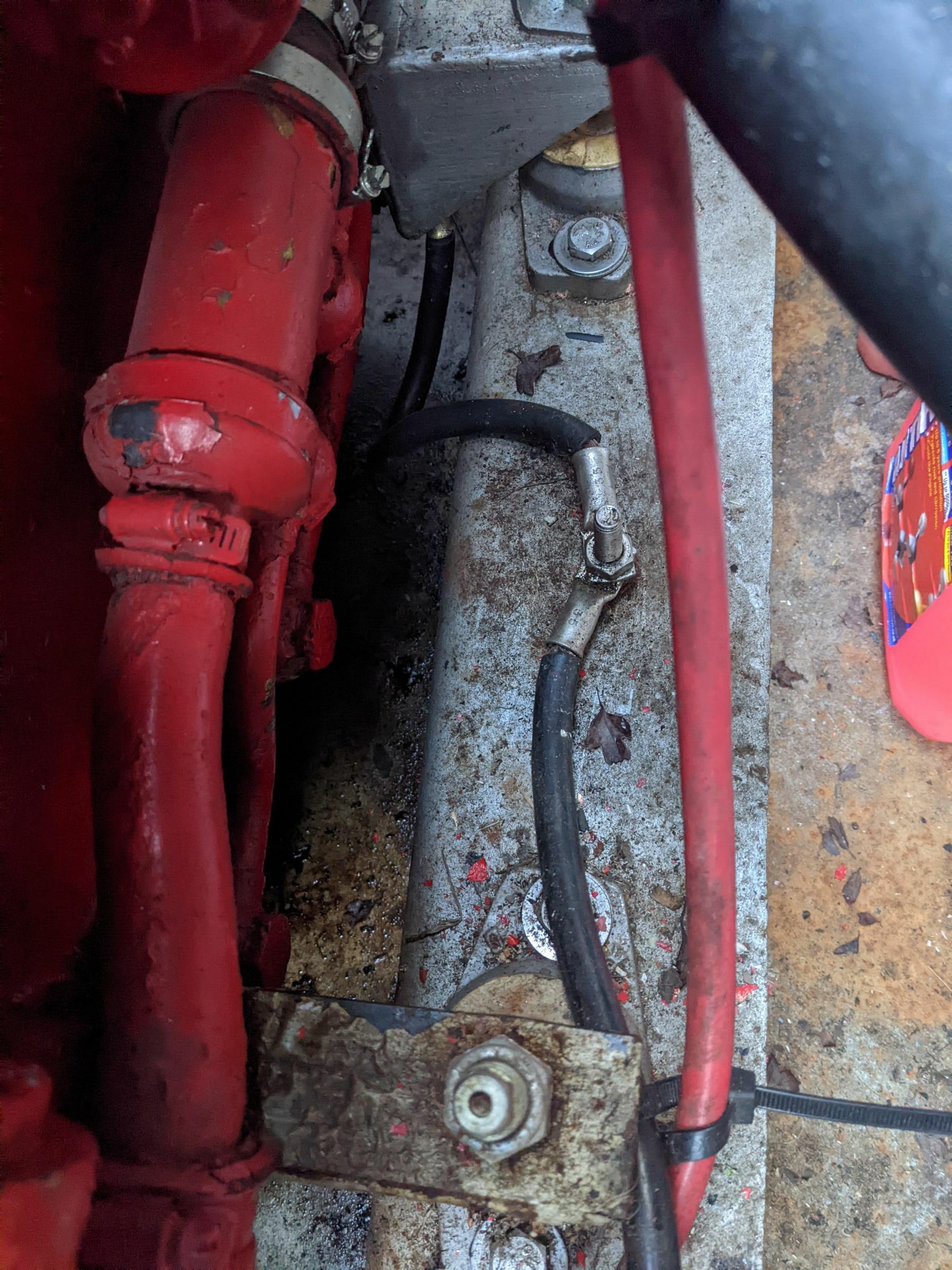

1is from the engine block to the earthing point then on to the starter negative.
Looking at the workshop manual for my Bukh DV36 the aforementioned attachment on the engine block next to the Jabsco water pump is the neg for the Starter Motor. So the neg from the starter motor runs from the battery to the hull then on to the starter.
I understand about the need for the switch to be between the starter + & the starter battery+. The boatyard that fitted the batteries did not do this and I am in the process of changing things. As I mentioned it's gone though 2 BSS without this. However the negative Busbar on my domestic side of things definitely does not show any continuity when I connect to the hull bonding point as shown in the photo. The batteries do charge OK. I've never really thought about it as obviously we do not use the hull as negative as in autos & the basic circuits were installed professionally & it is only now I'm able to really go into it. Just lately I have questioned weather the Cyrix VSR is working ok, but that largely was due to the starter battery being 9 years old😁

Can I ask about the 'common negative'?. My engine is bonded to the hull as shown in the picture, but my domestic side of things is not. There is no continuity between my Domestic busbar and the negative in the picture. Should there be?
