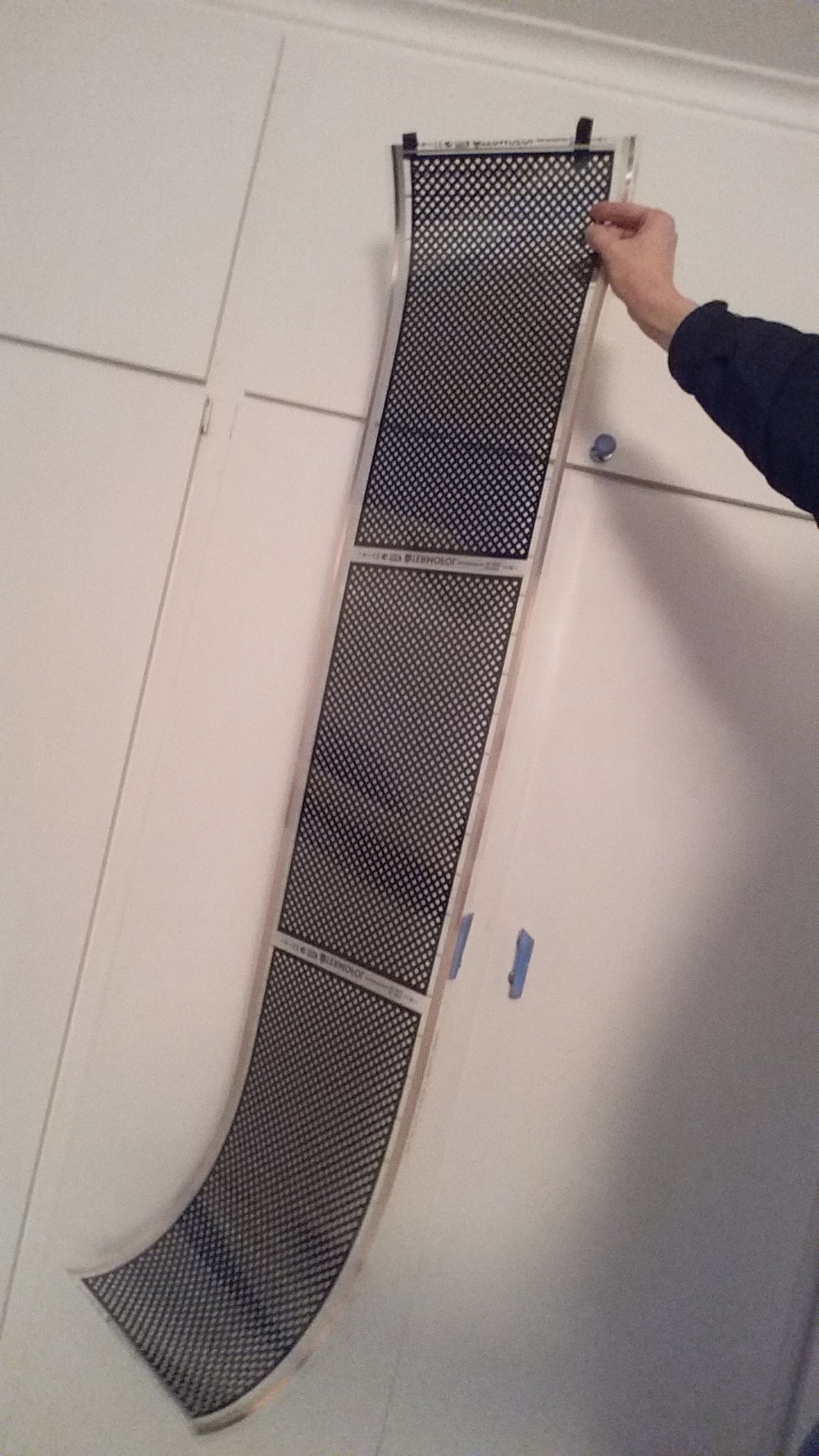

Do you use a thermostat with it?
We currently have no thermostat. I cut the heater film into 3 separate sections, one for each battery enclosure. The heaters were then wired together in series instead of the original parallel configuration. That reduced the overall power to a level sufficient to provide a gentle heat which, from memory, eventually reaches an equilibrium temperature approx 20 degrees above ambient.
This enables the heaters to be left on without any means of control. Fuses provide basic protection for over current, and the switch is a guarded and illuminates to give a very clear indication that the heaters are powered.
As the new monitoring system gives us better visibility of battery temperature, it is theoretically possible to automatically control the heaters. I doubt we'll ever get around to making that happen.

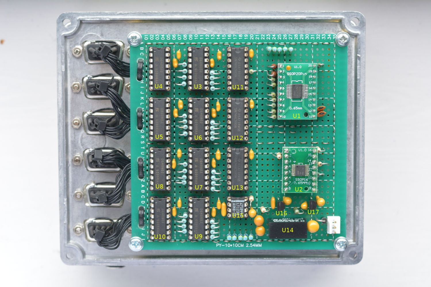

Time eventually came to build a MK2 unit to overcome some of the limitations, and make a proper installation. Also by this point, I was beginning to get a little nervous about what might be going on with the individual cell voltages. We have only ever carried out spot checks on the cell voltages, but there's never a convenient time to do it. Looking at my spreadsheet, the last measurements were taken nearly a year ago!
By this point I have a reasonable idea of what was needed, and what I wanted! I was hoping that an off-the-shelf system would be available by now, as what we're doing isn't exactly novel, and we're not alone in needing a means of precisely measuring multiple voltages. Each time i've looked, the available systems haven't satisfied our specific needs. For instance, many of the multi-cell monitoring solutions are designed for long strings of cells in series, not series-parallel combinations. Also i'm not convinced by the accuracy if the individual per-cell PCB modules as the ones i've seen just rely on the built-in reference within the microcontroller. Having become accustomed to seeing the overall pack voltage displayed with mV resolution and how useful this is whilst observing charge/discharge, I was determined to design something at least as good, but also had an accuracy to complement this resolution. i.e. able to measure the 12V pack voltage within few millivolts.
Our setup adds extra complication in that we have 12 cells to monitor. Whilst we could add connecting links between the cells to reduce the number of voltages which need to be monitored, we've chosen not to add the links for the following reasons; Firstly it would be a bit awkward due to the physical layout. Second I believe it might reduce the fault resilience of the pack i.e. 1 faulty cell might then take out 2 more cells. Finally it would not be easy to measure the individual performance of the cells without breaking the links.
The system I've ended up designing, for the most part follows a very traditional layout of ADC, instrumentation amplifier and multiplexer. It provides 30 measurement nodes with a somewhat unusual, but flexible multiplexing scheme. It is possible to measure differential voltages between any two nodes; therefore only 5 nodes are needed per battery pack. This scheme enables the polarity of the measurement to be taken in forward and reversed directions. By subtracting the reversed measurements it is possible to eliminate voltage offset of the signal path. A precision voltage reference IC is available via internal nodes 31 and 32 to allow the system to continually self-calibrate.
The C code for the raspberry pi is now fully written, I've ended up reusing most of my old python script for uploading the data samples to google sheets. The next phase is to produce some meaningful graphs/dials on the google sheet using the data. I've ended up doing a fair bit of verification work on this prototype unit, even checked it against a reference standard. At 10V the measurement error against the standard was less than 1.5mV. This equates to an error of 0.015%, which is acceptable and well within the spec of the reference IC. It's possible to further reduce this either by using the trim facility available on the reference IC, or by software calibration. I don't think it's necessary to go that far.
With the system installed on the boat, a comparison of the sum the individual cell voltages, with the measured overall voltage was found to give a discrepancy of less than 100uV on each of the packs.
So after 3 years without balancing, the battery pack isn't looking too bad. We'll need to leave the monitoring system to gather more data across a range of SOC. Initial data with the cells with a light load and at about 75% SOC is showing a maximum cell to cell variation of 2.5mV.
There's still a lot of work to do on this project. The next job is to retire the old lash-up system but to do that the battery current measurement signals need to be moved onto this MK2 system.
I've drastically underestimated how time consuming this project would be to complete. My biggest oversight so far has been the time taken to build of the prototype unit. I wish i'd gone straight to PCB. After all i'd gone to the effort of properly drawing up the schematic. Due to the way i'd drawn the schematic, I underestimated the sheer number of interconnections needed - well that's 8 days i'm not going to get back!
Making the cable assemblies also seemed to take forever. At least the end is now in sight!
Photo shows prototype MK2 unit assembled onto lid of diecast enclosure.

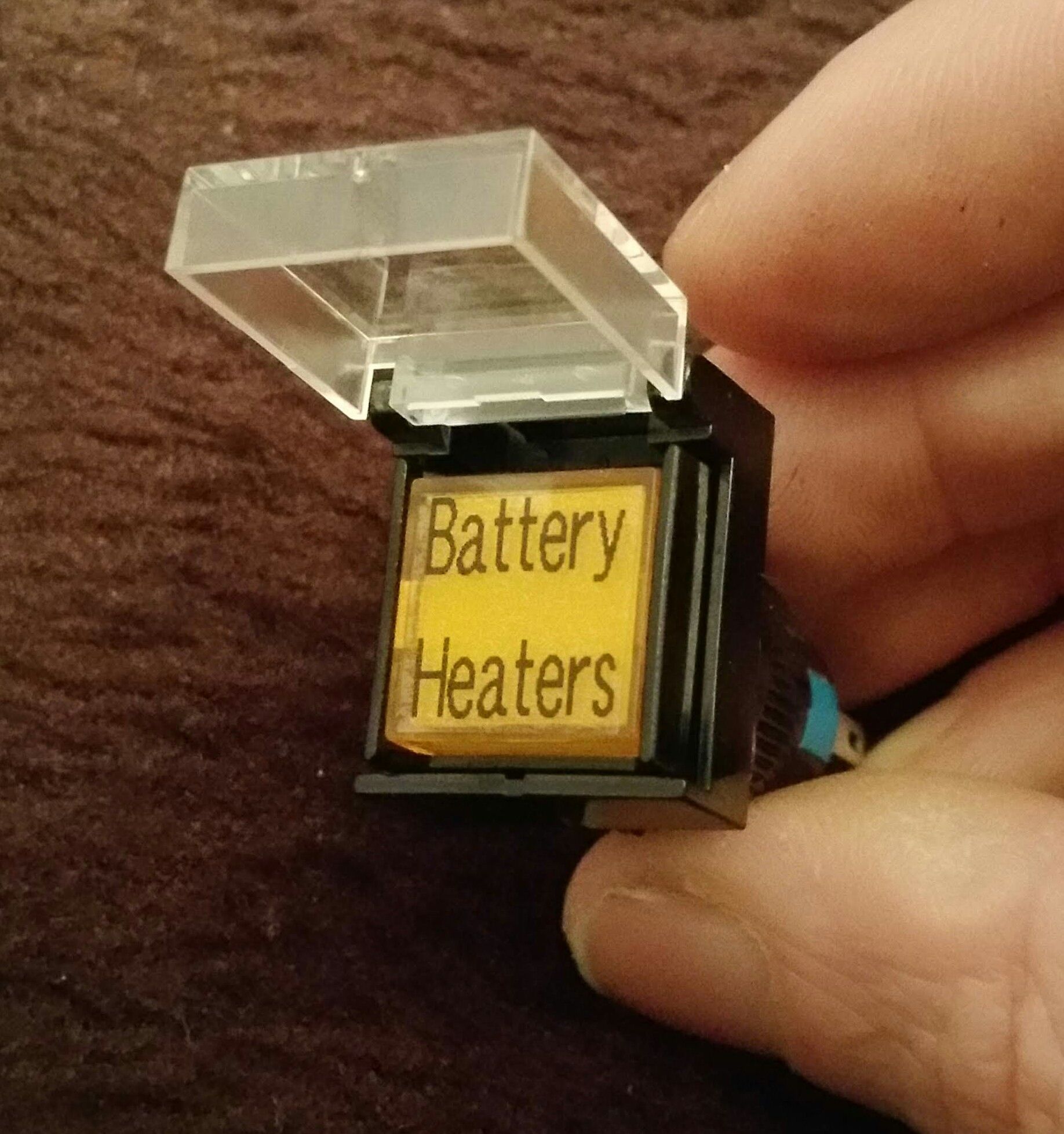

Since this is a bit of a niche topic I thought I'd continue this thread rather than starting a new one...
My BMS is set up to trip the charging relay at low temperature. But a better solution would be to warm the cells up so that they can be charged safely.
I've been told to use soil warming cables or vivarium heating pads for this purpose, as they apparently come in 12V versions with thermostats. The reptile ones especially have temperature control in the right range (0 to 35 degrees). The ones I find online are 240V though.
I did find plenty of thermostatically controlled car seat warmers which sound ideal, but I expect I need a thermostat that is much cooler - shutting off at 5 degrees or so.
I know that keeping them in the cabin goes a long way towards keeping them warm, but the room they're in does get cold if I'm not in it and running the diesel heater, and don't want to rely 100% on that. I would love to hear any suggestions or how anyone else has solved this problem.

We ended up using these heated mats. (See photo) They are available on eBay, search for "camper van heating mat" They are rated at 220w/m2. They can be cut down lengthways to fit the size of your enclosure.
We have 3 wired in series which, from memory, draws about 1 amp at 12V. In our setup this provides enough heat to maintain the cells above 5 deg C when the ambient temperature is at about -10 deg C.
We've fused both the +ve and -ve supply feed to the battery heater circuit so that a single fault e.g short to +ve battery terminal could not cause a meltdown.

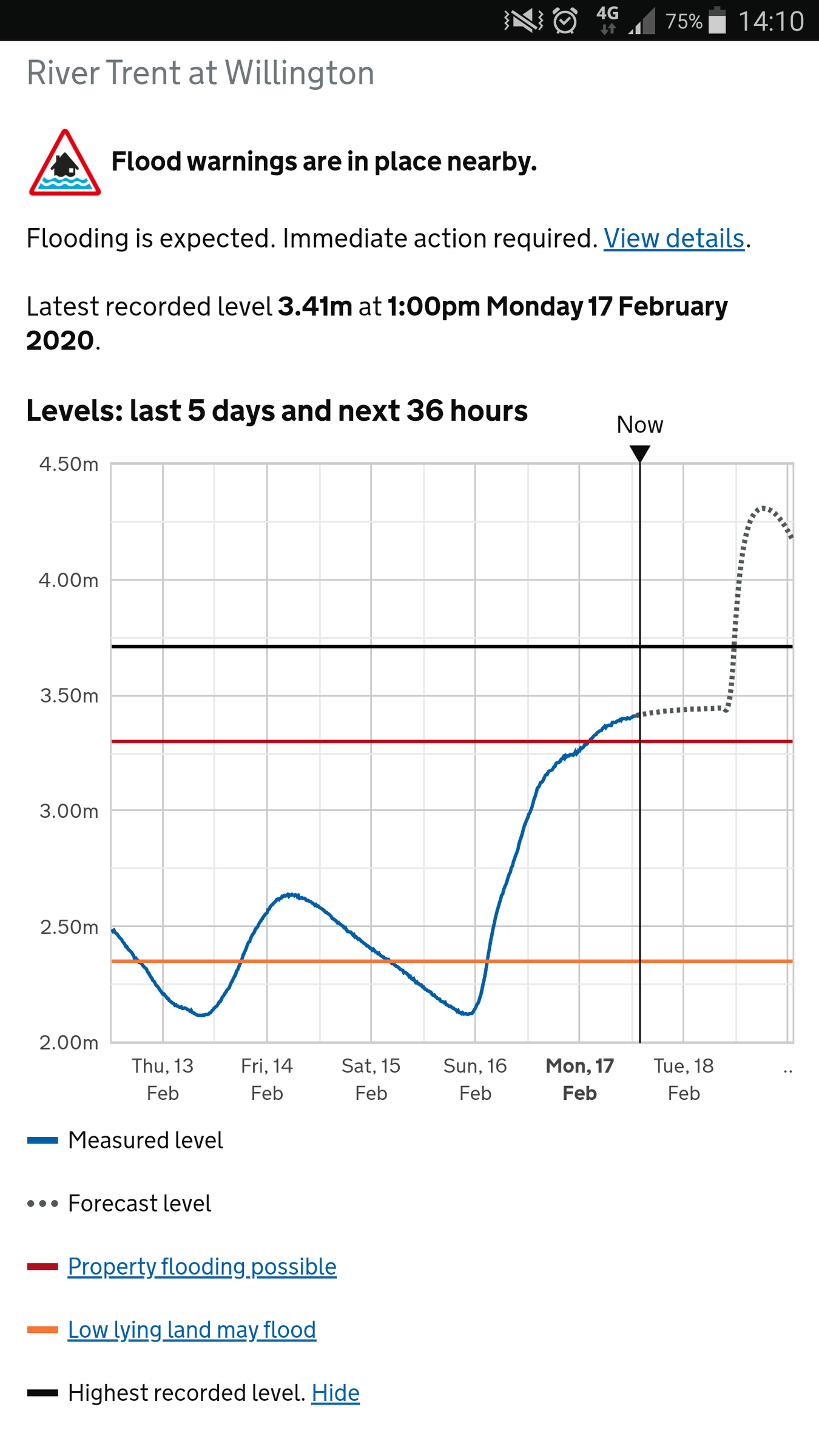

Before it went offline, the Willington gauge prediction was showing a bit of a bump. See attachment
We're moored on the pontoon at trent lock, and there are a couple of narrowboats before the floodgates on the cranfleet cut which have started to break free from their moorings. One is currently on the towpath facing the opposite direction - the owner is aware.
The other also appears to have broken free at one end, but we haven't seen the owner yet.
Access is currently a little awkward due to the water level.
