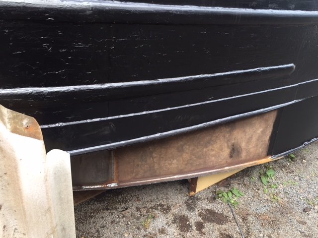

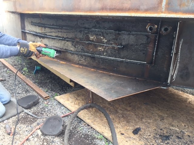

When my boat had its pre-purchase survey it was pointed out that the base plate had 'a rash of pitting' and the sacrificial chines had been eroded to such an extent that the only economically sensible option was to overplate the base. (surveyor's recommendation), the other sensible option was to walk away and let it be someone elses problem - but I really liked the boat...
I'd read on here (thanks everyone) recommendations for Kedian Engineering so approached Martin for a quote. Followed an enjoyable conversation and an exact description of the work that would be done (another company had quoted me also but were so vague in the work schedule that I walked away), how long it would take and when he would be able to do the work. Oh, and a price too...
On the way to Kedian from my home mooring coolant temperature got a bit too high on several occasions - not quite to overheating properly but worrying nonetheless - so a phone call to Martin asking if a skin tank could be fitted while he was overplating. "No problem!" from his end.

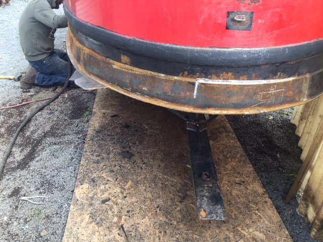

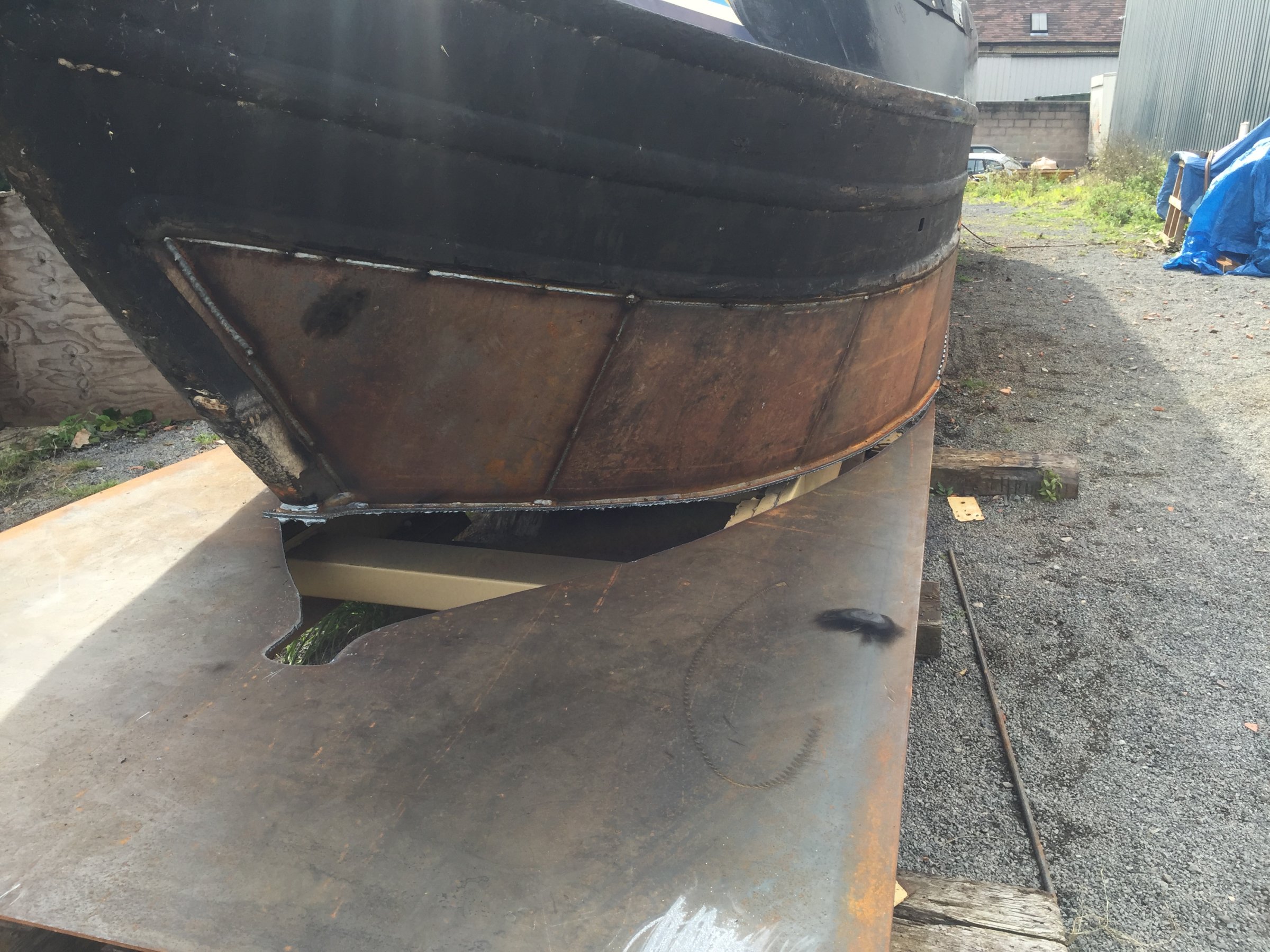

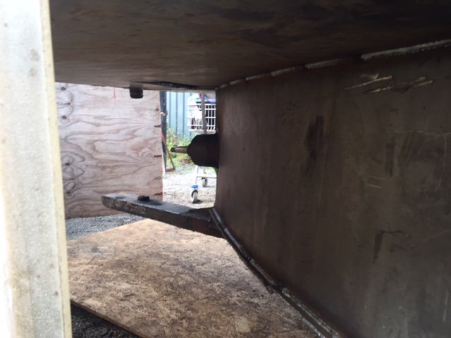

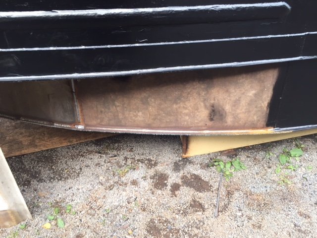

Martin had posted a couple of pictures in the last overplating thread so I thought I'd add a couple more from the work-in-progress collection.
As can be seen, he has done a great job, explained exactly what he has done and finished off with new blacking (3 coats) not just over his work but the whole hull. He also added a 'step up' on each side of the hull at the rear - obviously thinking of the inevitable time when someone on the boat decided to take a dip in the canal - to make it easier to climb back on board, or for the Herons / Cranes to have somewhere comfy to stand...
Now looking forward to the trip back to the home moorings without 'worn welds' preying on my mind

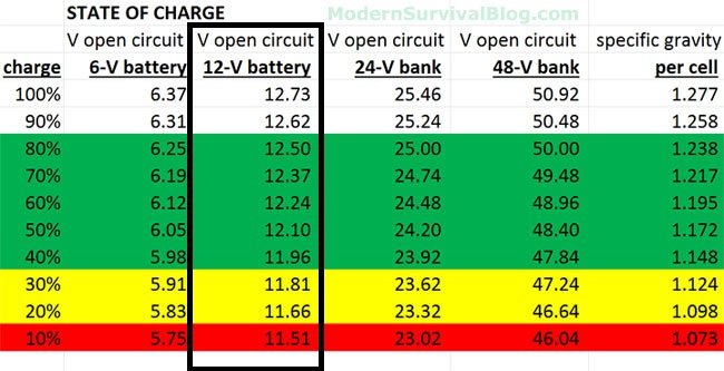

I do have a laminated printout of this chart on the boat - it helps a little
