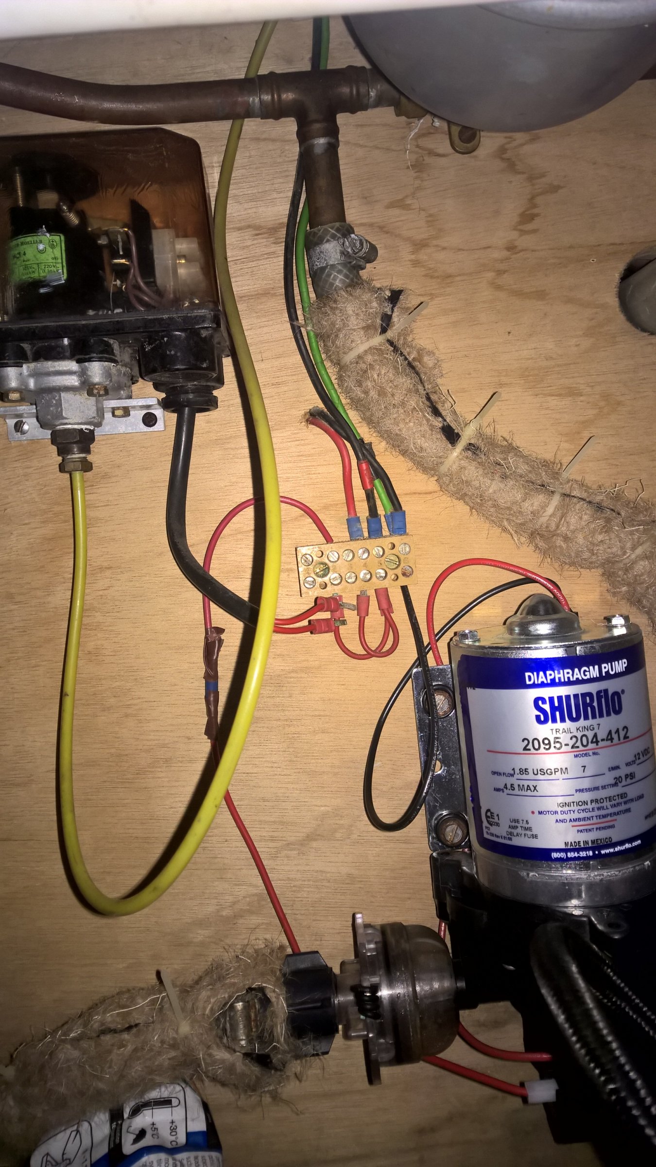

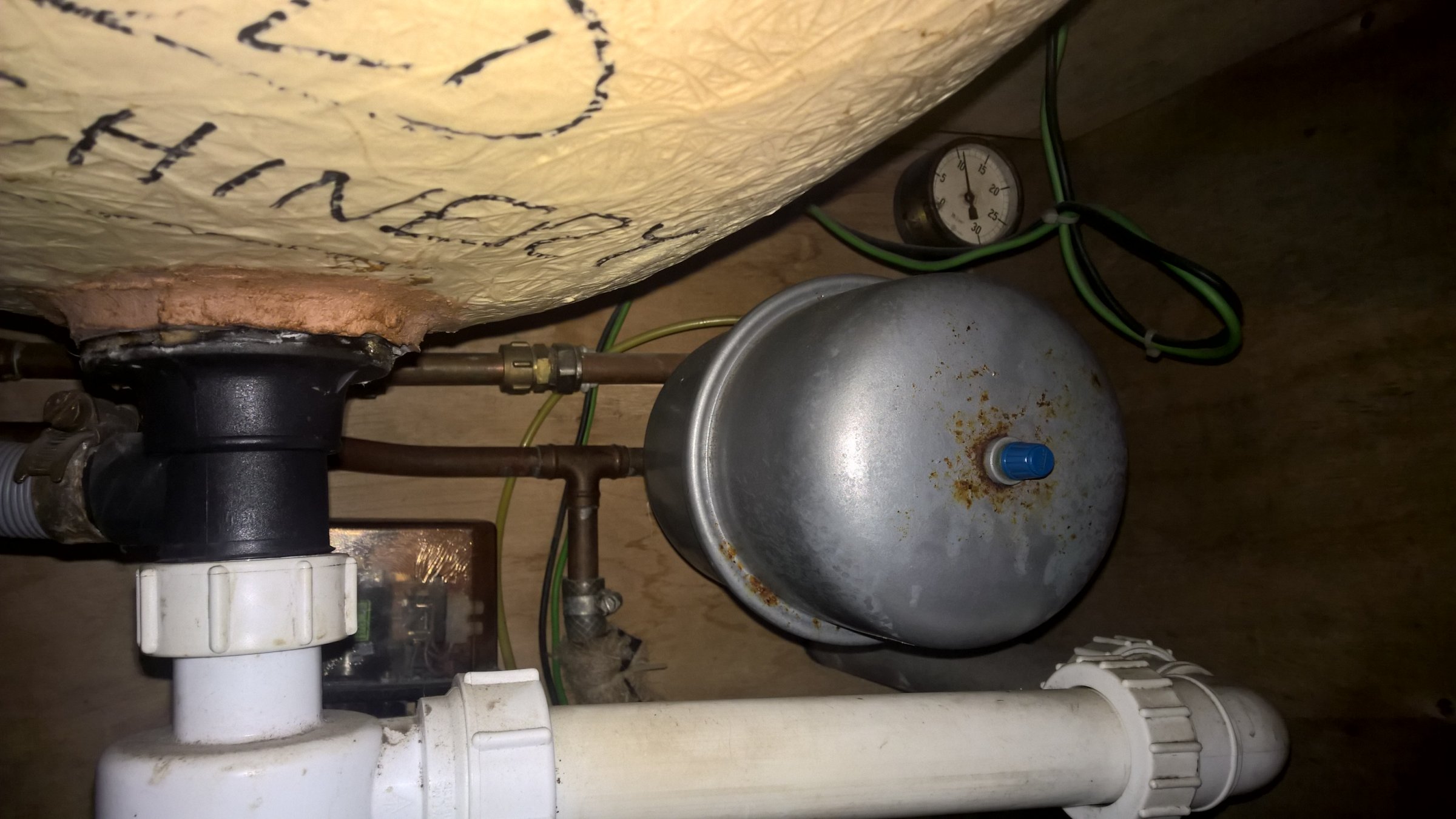

shurflo pump replaced and now shuddering the boiler
purple8 replied to purple8's topic in Boat Building & Maintenance
pictures show the set up. There is a external switch but its never been connected. The diall is on the system though but not connected electrically. -
I swapped my leaking shurflo 2901-0212 water pump yesterday for a trailking 2095-204-412... should be a straight swap. Same 20psi and lpm etc... the changeover was pretty easy, just one for one, same connections and fittings etc... After turning it back on, it self primed and everything was fine for a while, shower worked better than ever and had a good pressure from all hot and cold taps and no problems. now tho is very different. Turn on the tap, pressure fine, pump kicks in, but on ending its cycle it seems to send a shudder through the pipes and rattles the boiler. The boiler is probably the highest point in the system, bar the shower head. I have an accumulator on the system by the pump? Should I pump this? Or remove air from it? I feel it is a pressure problem or air in the system after the change. Any ideas of things to do or check would be great. Thanks
