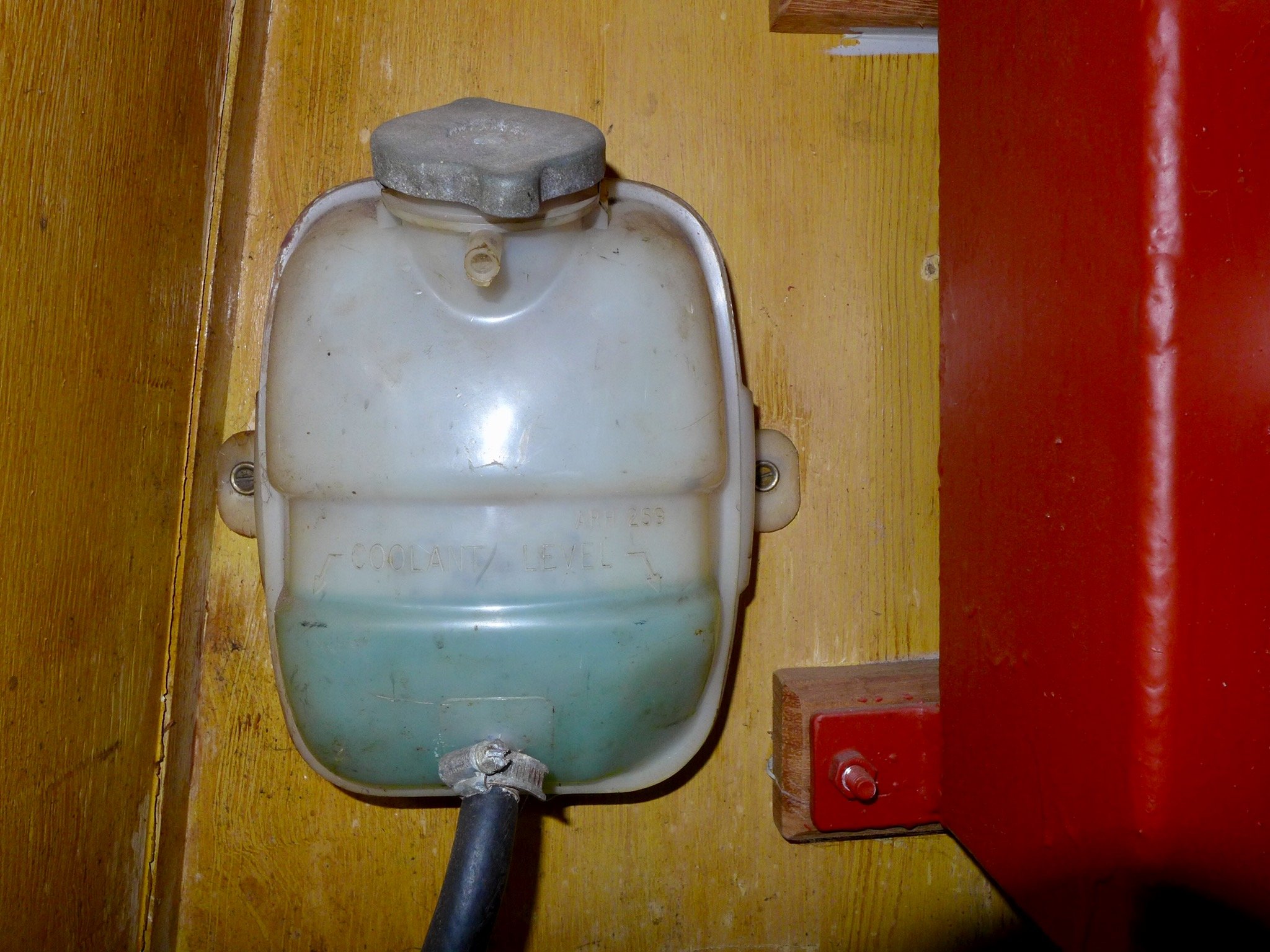

    True about the volume, but unfortunately the sight tube is quite narrow and very slightly opaque, so I suspect the colour would need to be really dense in order to make much difference visually.
    If the tube was a larger diameter similar to my engine coolant header tank, then there would be no problem seeing the level. See the pic - the level is easy to see at 25% even with the tube badly stained and no colour.

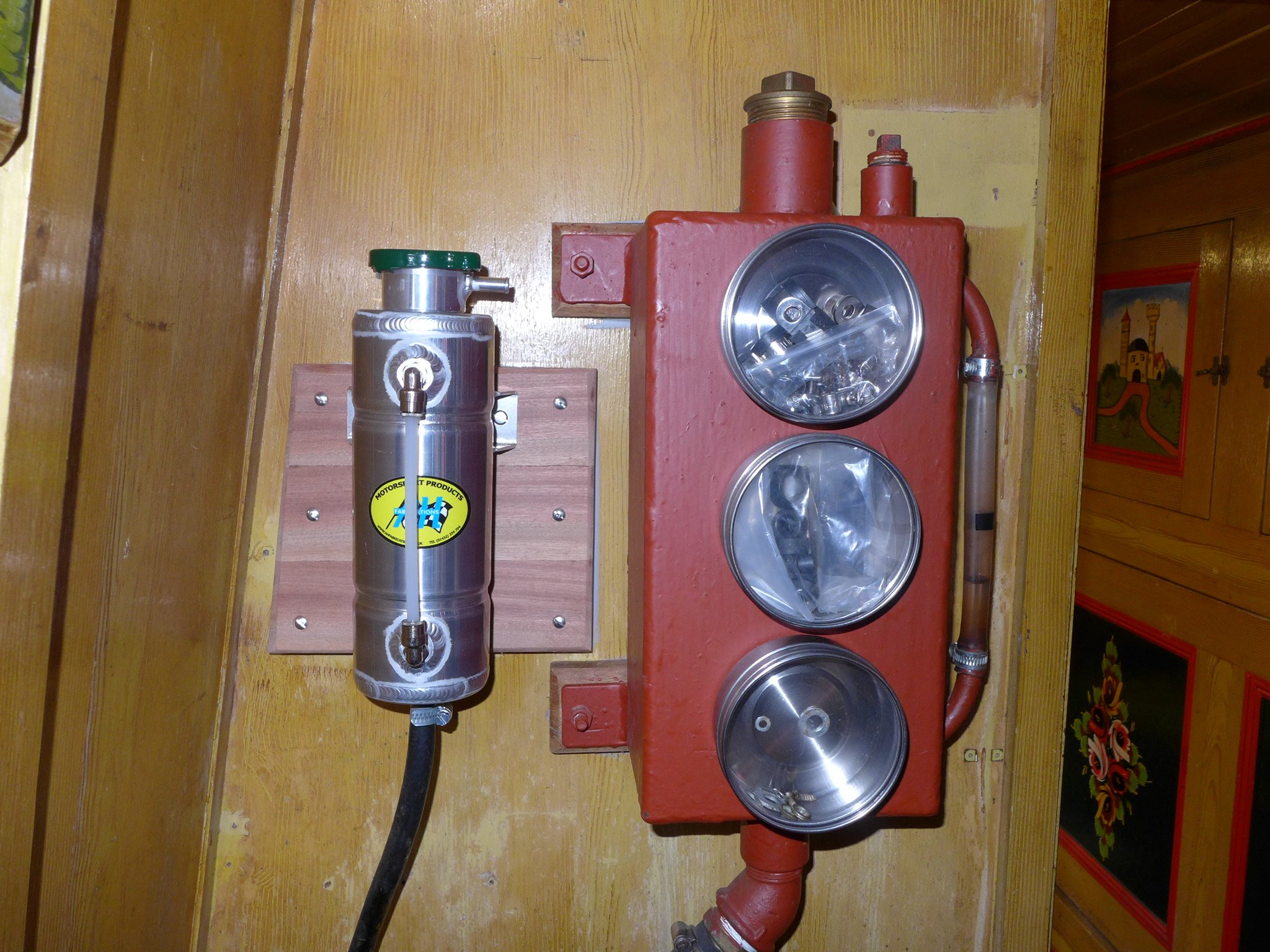

    (Sorry about the glass lid tins - I got a job lot of magnetic ones and then had to find somewhere to stick them ;))
    At one level that really appeals :) but then again, isn’t simple usually best?
    Can you really have too much antifreeze though? Maybe just adding a higher concentration sufficient to make it visible would work.
    Magnets are really useful things, no doubt. We've had about 8 button batteries lying on the boat for about a year waiting for a use. All but one are tiny, about 7mm diameter, but extremely powerful, so much so that a considerable amount of force is needed to separate two from each other. A few days ago i found a great use for a couple of them. Now we've left the marina and the shoreline behind the two things that clobber our leisure batteries are the tv (too big a screen but we already had it lying about before buying the boat) and the fridge. We found a workaround for the latter: we simply use the ice box as a fridge (no thermostat, so you have to keep an eye on it, but it means running the fridge (and inverter) for 30 minutes several times a day rather than 24/7. Anyway, i digress! The fastening clip on the ice box door has been bodged since we've had the boat, to keep the clip in place after the plastic started cracking around the mounting screw. Last week the crack got bigger and the clip wouldn't stay in place, so i cut into the door sealing rubber and glued in two magnets, then screwed a couple of small screws into the ice box body, standing slightly proud, to connect with the magnets. A really neat solution, the door closes with a satisfying pull between the magnets and screws, and no worry now every time the door is opened that the spring might need fixing back in place yet again just as you're about to settle down with a cuppa or something. Two more of these magnets are going to be glued onto the windows in the front of the saloon so that our DAB aerial can be held in a choice of positions to maximise reception as we move around the cut. One bigger magnet has been used to hold a lock hasp onto the rear sliding hatch out of harms way when not in use. I'm sure it won't be long before the three or four remaining magnets are utilised for other applications that just make life that little bit easier, allowing one to mellow out a bit in between the seemingly incessant diy jobs!

  8. 57 minutes ago, gbclive said:
    To be honest as the tube is realy quite narrow and my Screwfix antifreeze is clear, it’s not easy to see the level even before the inevitable staining. I have to shine a torch at just the right angle to pick out the meniscus. Perhaps a suitable dye would help?
    Ah, a new word for the day!  :)
    41 minutes ago, gbclive said:
    Thank you - a brilliant and simple idea  :)
    (However my TEM (threat error management) training has kicked in - what if the coolant level was ever to get low enough that the bead was able to start circulating until it came to a critical restriction?) ;)
    Lateral thinking. Always best to look for worst case scenarios imo. Sods Law has a habit of creeping up on you when you've got your head turned the other way enjoying the tranquility of the moment!

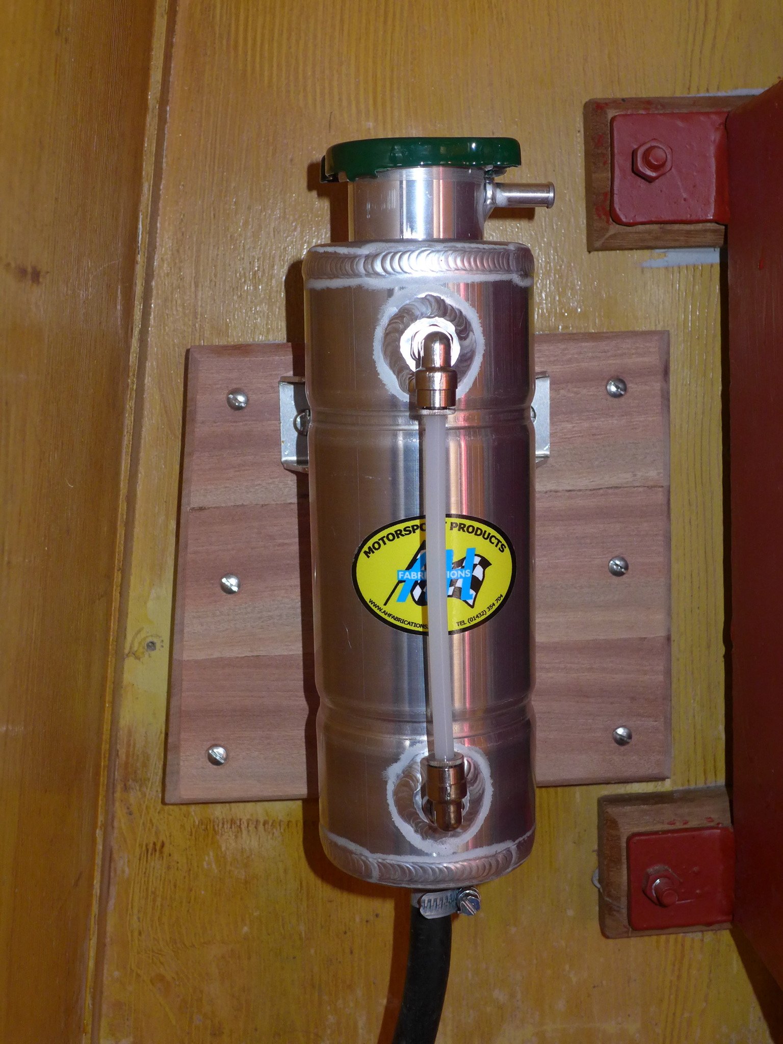

  9. 28 minutes ago, gbclive said:
    I’ve just had to replace a similar header tank for the Webasto CH system.
    The lower spigot had cracked where it met the body.
    I splashed out on one of these from A. H. Fabrications - reused the original cap (not supplied) after painting it.
    Overflow is now connected.
    The only problem I've had is trying to removing the pesky impervious plastic label - probably designed to make this impossible :angry:
    Blowtorch perhaps?
    So I now have a “bling” - Mark99 will be proud of me ;)
    It's amazing how popular these BMC units seem to have been with boat fitters. Seeing yours makes me slightly more confident that our boat's fitters were at least bodging with some knowledge!
    That label looks ok to me, but if you can remove the top layer of it and then gently scrape the layer underneath to break it down a bit, some sticky stuff remover might finish it off.
    19 minutes ago, bizzard said:
    If there is rusty water circulating in the system the plastic header tanks and a plastic sight tubes inner surfaces will soon become stained rust coloured iand the level might not be discernable after a while.
    Well i'm going to bask in the glow of (relative) newness for the time being, Bizzard. :D No doubt there is rust lurking, because when we checked for antifreeze in the middle of winter shortly after buying the boat there wasn't any!

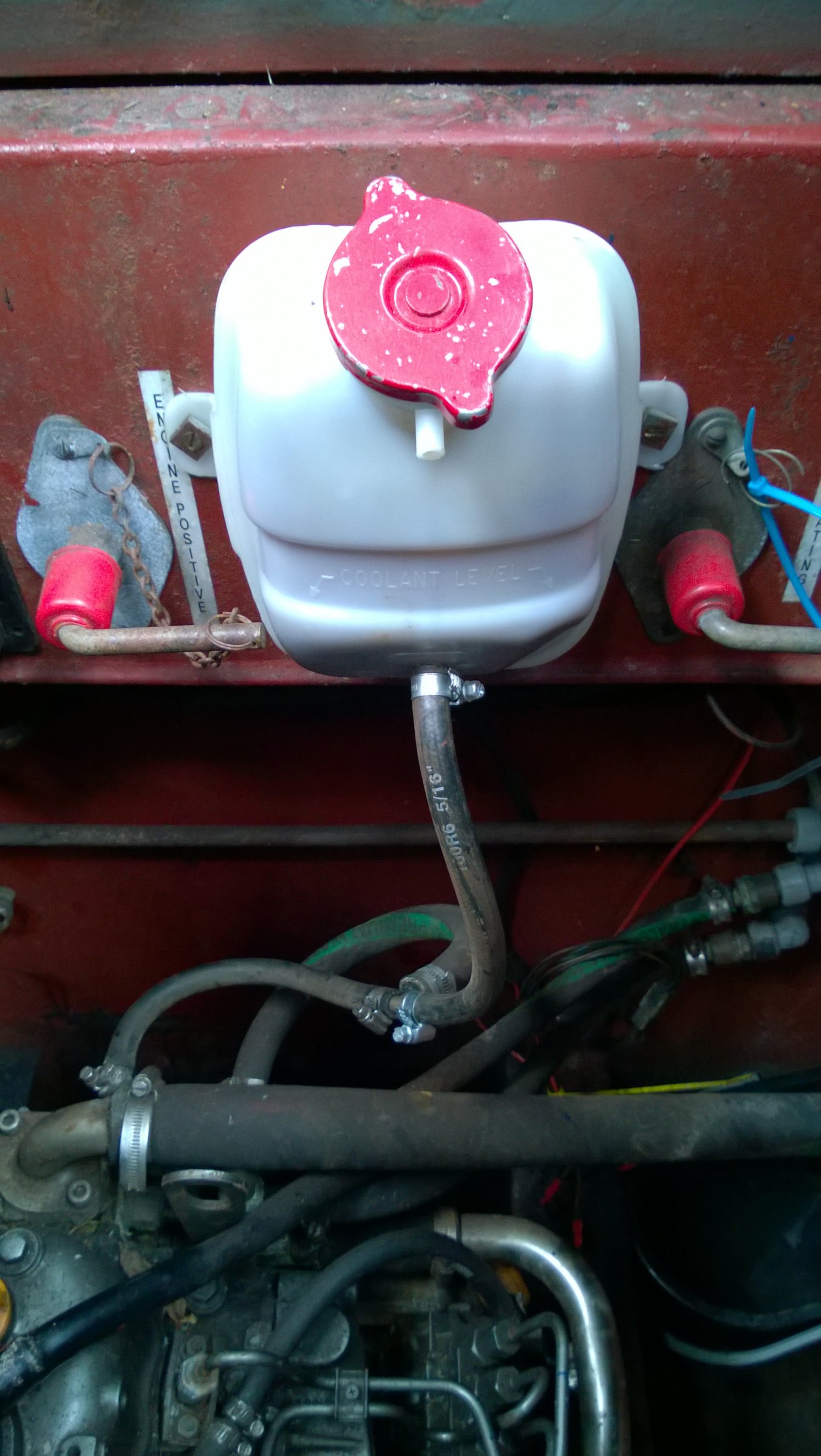

  15. An update to this thread. Here's our replacement header tank in situ. Once again, many thanks to Ray T for the very generous supply of this. It's nice to be able to see the water level without taking the cap off (see pic of our original in the top post), and not have to worry about the bodged Araldite repairs failing! After consultation with a marine engineer, rather than drill an additional hole for the extra pipe these were joined with a T-connector, as in the photograph. I can't imagine why this solution wasn't adopted from the start rather than drill a hole into a plastic body that was always then going to be a weak point for leakage.
    Thanks to everybody who contributed to this thread with their advice and offers.
