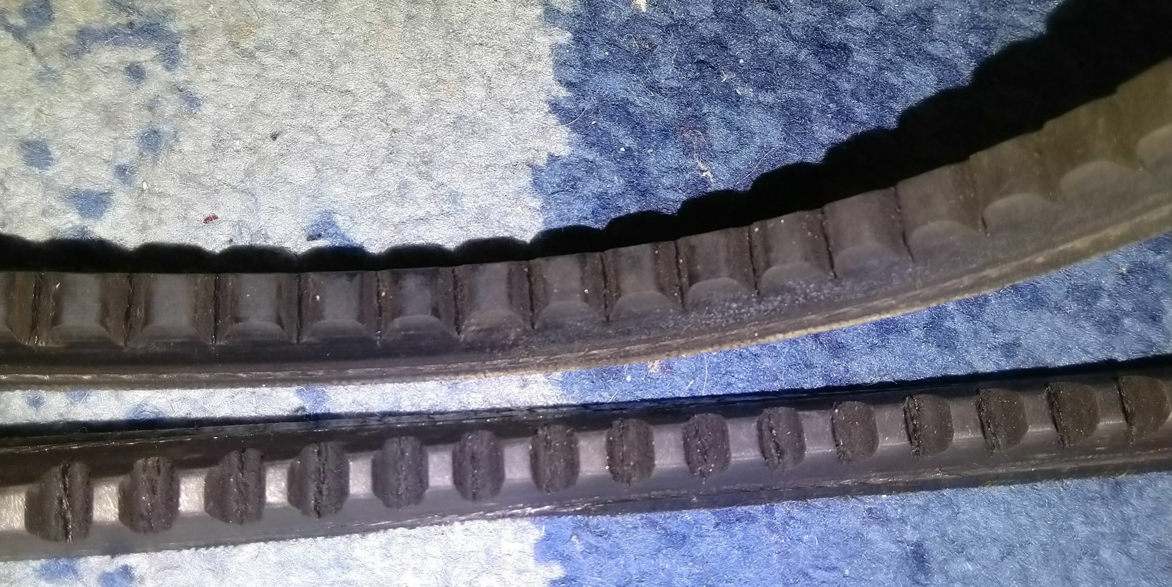

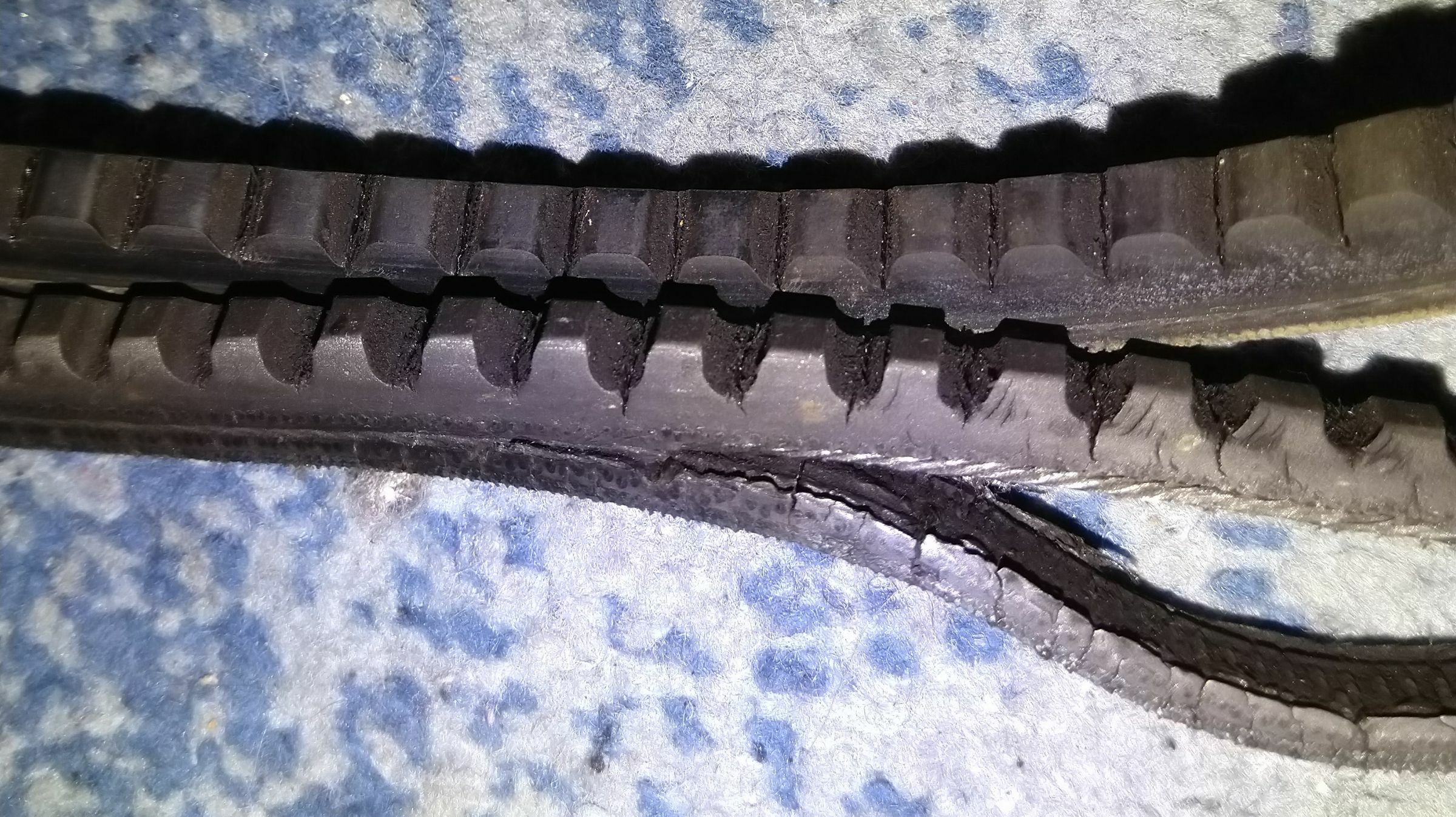

I would suggest the damage on all the belts suggests long term overloading and overheating, probably caused by slip. Just because it has stopped squealing does not mean it has stopped slipping.

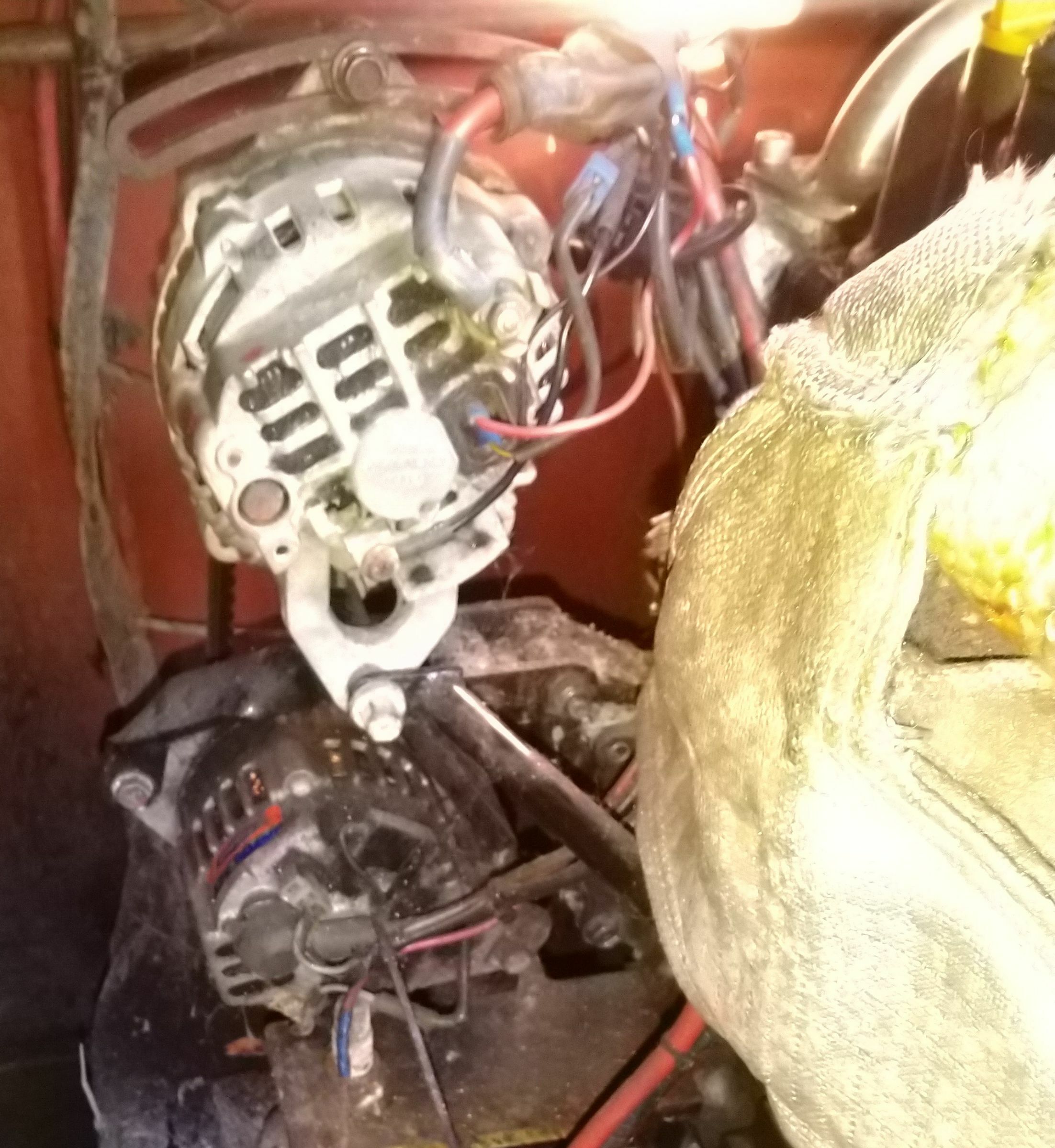

Ok, thanks, i was forgetting how badly blocked those vent grills at the rear were, we were quite shocked when we took the alternator off, it wasn't evident from the top and front when checking oil and water levels.
I'm guessing though that a blown diode might possibly indicate too large a load could have been imposed on the alternator at the time of failure by running too many high-demand appliances?

I think that it is just a manufacturing difference providing the width of the back of the belt is the same,
I would use a Gates belt, they are generally considered to be the best available.
The failed belt looks to me to have failed due to overheating due to slippage ( squealing ) rather than normal wear.
You are correct, belt had been slipping for a while on startup, it usually resolved after 5-10 minutes, i tended to have to readjust belt roughly once a month but hadn't got around to it that time. What can you see in the photos to indicate slippage, is it the way the backing has parted company in the second photo?

Let's get the teeth out off the way first. They are only there to allow the belt to bend around a tighter radius and thus aid gripping on the smaller pulleys we tend to use, so that is very unlikely to be here or there.
What is vital, especially in your situation, is ensuring the new belts match the pulleys because with that belt size there are at least tow different cross-sectional profiles and if you get the wrong one it will not grip across the full side faces of the belt, will wear faster and squeal more. The bottom belt has had it. If you don't know the belt profile/part number I think I would buy a couple from Barrus but even then I had a case where they supplied the wrong profile.
Ok, thanks. Profiles looked more or less identical although photos don't really show this, but old belt has been binned so can't double-check. New belt ran about 6 hours before alternator failure. Hopefully just coincidence, there were no obvious indications of belt slippage.
Latest update on this is that a diode was blown. Alternator is getting an extensive refurbishment in addition to the diode.
Is it possible that fitting a belt that isn't an exact replacement could cause issues? The replacement belt was already on the boat but i did note the teeth were a little chunkier but just assumed it was due to wear on the older belt and/or different manufacturing tolerances. Both belts were as good as identical in terms of width and circumference. Taking a closer look at these close-ups now though there does seem to be a real difference in the profile of the teeth. The older belt is at the bottom in both photos.

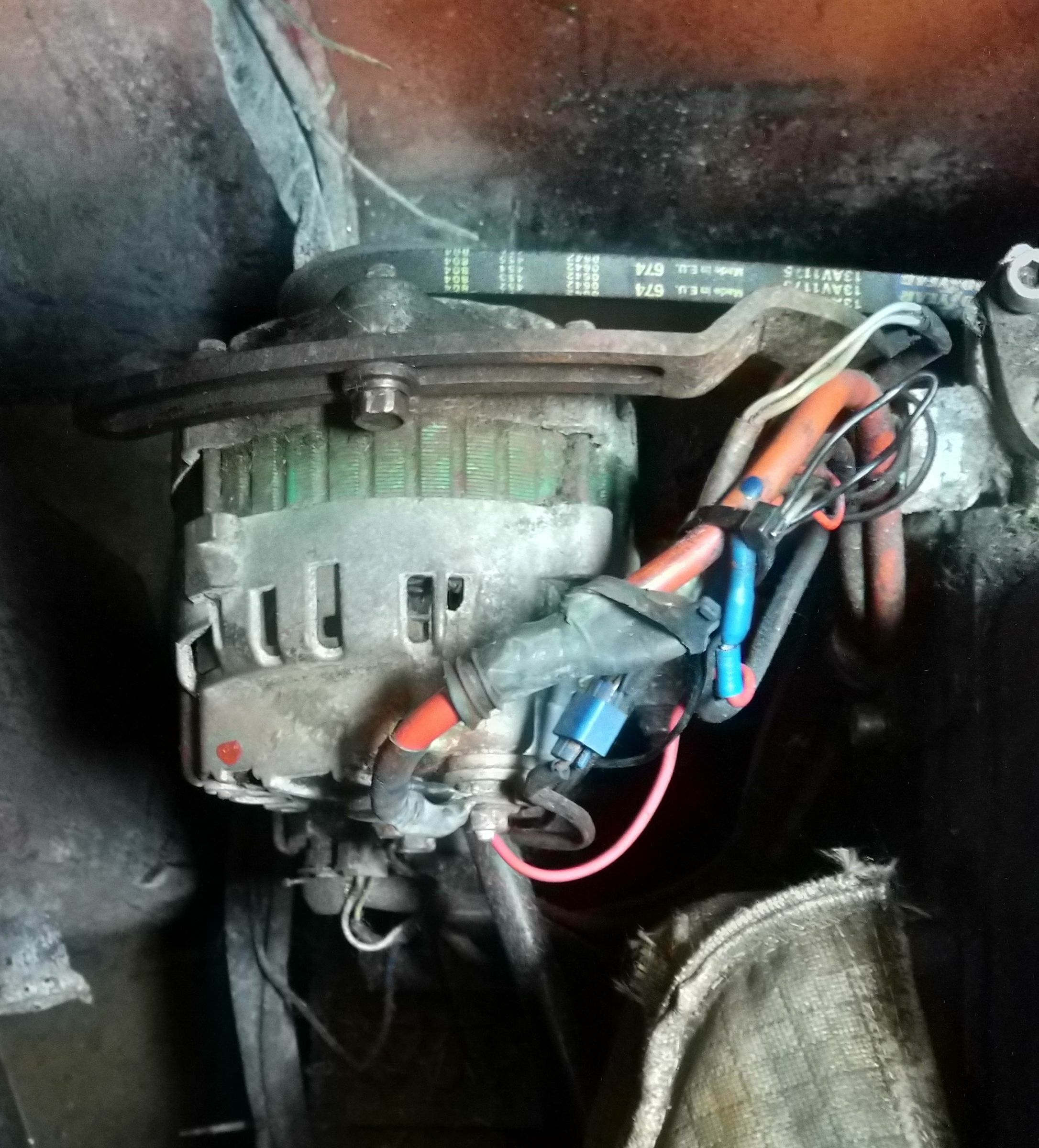

Ok, i've managed to edit the file sizes of the pictures i took in order to upload here. The alternator is a Mando brand, this is embossed into the casing at the back; however there is no other information visible regarding a serial number or amp rating.
I'm taking this to a refurbishment company later today but your advice might help me make a decision as to whether to refurbish or replace it. There's one very similar on eBay rated at 50 amp. That might well be the rating for this one, but i've been led to believe that 50 amps would be insufficient to supply a service battery bank, and if this alternator is actually higher than 50 amps i certainly wouldn't want to downgrade. If this actually was 50 amps though, and we went for, say, an 80 or 90 amp alternative, would there be any downside to doing so? Our system includes a Victron inverter rated at 1500w. -
Tin alternator? How very, very dare you!
Yes, i can remember reading some criticism of that design a few years back, possibly on another thread i posted. It works well enough, although the belt needs tightening every few weeks, which may or may not be related - it could just be that the last belt was of poor quality.
