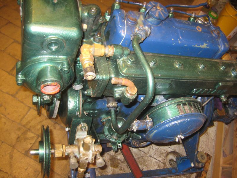

  8. Hello Toni, first of all thank you for the information. I now understand, Thorneycroft, CT marine, JR Meaks, Tempest and Newage etc. are the ones that marinised the engine. Exhaust manifold and heat exchanger are simular. Rear mounts seem to look better than mine. To answer your questions, beside a picture here also a few numbers: Numbers I found stamped on my engine: 1500 D / 15BB/V/D 2123 / B14E0 / 12H1999 Diesel Injection Pump: DPA 3246E857 MOD / SER 47260 PM / Hydraulic Heat Exchanger: Bowman FH100 , 3182-2 , Date 11 82 , FH11 I have often obtained general maintenance parts from Calcutt Boats or ASSP, but things like exhaust manifold coolers, timing chain covers are hard to find. Injection pumps are also quite expensive. I will buy the engine if the compression is good. Should it run well, I will replace mine, if not a good amount of spare parts will keep mine running a bit longer. Thanks for your help, Doug

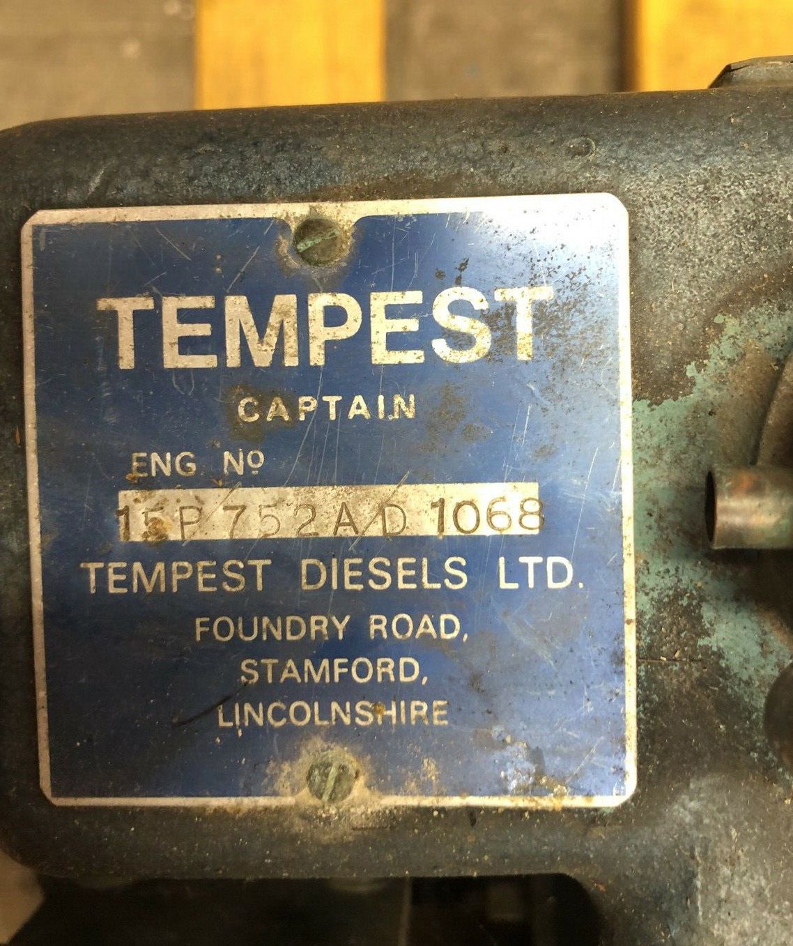

  9. Hello Forum, I could really use your help again. Living in Hamburg its hard to get BMC engines, parts etc. Someone fairly nearby is offering a BMC Tempest / Captain in ebay (https://www.ebay-kleinanzeigen.de/anzeigen/s-detailansicht.html?adId=1621890588) I have a BMC 1,5 litre Captain engine in my Sail boot, which is again and again giving me troubles. (see earlier Posts). I have heard of the Captain 1,5 and of the Tempest 1,5 or 2,5 but never heard of a Tempest/Captain. (see picture) Can anyone tell me if the Tempest / Captain is the same engine as my 1,5 litre Captain. How many horsepower does the Tempest / Captain have? Will the parts all fit on my Captain 1.5? It would really help me to make a purchase decision if I knew more about the engine. Regards Doug
