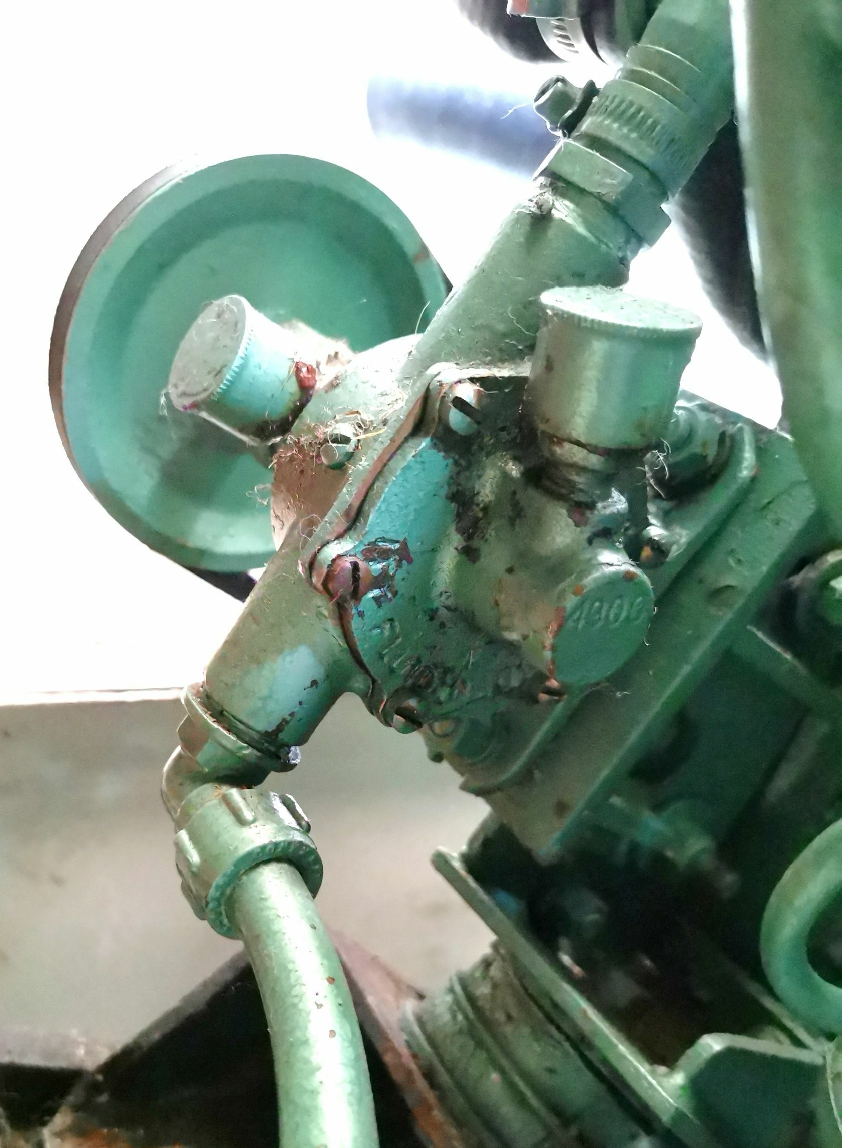

  1. Can someone please tell me if I need to remove the woodruff key to change the impeller on the Jabsco 4900 200 pump, or can I just pull the old impeller off and replace it without touching the key? Rather strangely whoever changed it last time (not me) put the cover on at weird angle!
