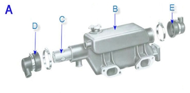

I've finished this job and all is well. I made up some studs that go from M12 in the head to 3/8" where they run through the manifold flange and then M8 as they come poke out the end. I've done this so I can have a small nut and be able to get a ring spanner over the end. The M8 nuts are 13mm across so that's perfect. Anything more than 14mm and it would have proved very tricky to actually do up again. Why they didn't make them with a touch more tolerance I don't know.
The studs are in the head with metal epoxy and this has proved a good seal and solid fit. Obviously the long term plan will be to find a new head but I'm in no rush for that now everything is working as it should again.
The heat exanchger I have is a 'Polar Engineering Ltd' one and it turns out they went bust a while back. The core/ tube stack was gone on this but I couldn't find a replacement so I decided to fix it. I tested each tube individually by blocking one end with plastercine and filling them up. I found none of them leaked so were not fractured. I then turned by attention to where they are fixed into the plate on either end and found a few to be a bit loose. I peened over the ends with a ball pein hammer and then decided to metal epoxy the end thoroughly after a very good clean up. I would have asked my neighbour to braze it normally but he is extrmemly busy and I had to get the boat moving again.
Obviously I took care to not get epoxy in the tubes or to block the ends. All tubes were cleaned out and everything went back together agian with some RTV on the joints of the reused end caps.
This seems to be a good way of sorting old tube stacks. If the odd tube is broken it can be sealed up and used again. The little cooling capability you would loose with one or two tubes blocked would be negligable I'd say.
Thoughts?
I also rebuilt the water pump while I was at it as that was weeping, seals and gaskets from ASAP for £15. Job done.
The whole heat exchanger repair job has cost me the price of some new hoses at £21 and 4 new manifold gaskets at 93p each. Plus a few quids worth of epoxy I guess. Not bad considering new ones are going for £600+.
I also got a complete, good nick Bowman heat exchanger for a BMC for £40 in the process. A good spare.

I have now removed said heat exchnager and found that not water is getting into the exhuast manifold from the header, the casting here is still solid. There is however water dripping from the head on both stern manifold fixing studs. All studs are loose in the head so it looks as though someone has done a rubbish job of helicoiling them in the past and broken into a water gallery. Im hoping to make up some new studsand then drill and tap thehead. The studs will prob have to be half inch in the head. I will then metal epoxy them in and hopfully cure the leak. I know this is essentially a bodge but I really dont want to pull the head!
It looks like the heat exchanger cire has also gone as the header keeps filling up with water when cap off. I have since picked up a complete Bowman heat exchanger in good nick for forty quid that I am hoping to use the core from.
Any advise or suggestions would be really appreciated!

I took a quick look at this heat exchanger today and it strikes me that it wouldn't be an overly hard thing to fabricate. I thought using some 316 stainless and getting my mate to TIG it up should be straight forward. Seems to me that making them out of ally is only going to end in tears on an old diesel like mine that ratlles around, not helped by the added weight of the water inside. I have the same problem with some ally parts on my old Triumph, they justy give up after a while under the vibes (not balanced yet!).
The other thing I was wondering was why the exhaust runs through the tank? Surely that'll heat the water? If I were to make one I'd consider fabricating a seperate exhaust manifold.
What are your thoughts on this one? It's all new to me.

I have a 4108 running a raw water cooling system. I have a water leak where the heat exchanger bolts to the head but only on the forward most mounting. As the engine revs increase so too does the leak until it forms a substantial jet. I'm new to marine diesels but it seems to me that this should be the case!
The exhaust system is home made and someone has suyggested to me that where the water is injected back into the exhaust after the heat exchanger could be a problem becasue if it is not done at a suitable angle then the water could find itself back up the exhaust. Anyt thoughts on this theory?
Could it just be a damaged heat exchanger?
