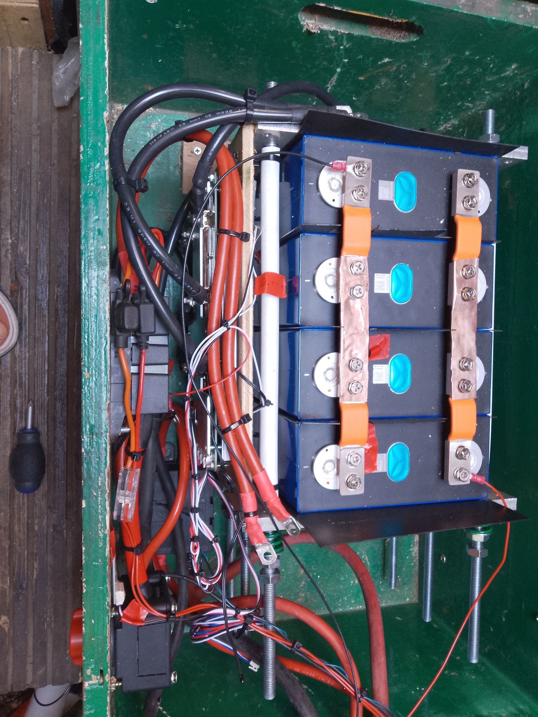

  4. 7 hours ago, Jen-in-Wellies said:
    When I needed an extra two bus bars to connect my cells in parallel for top balancing, I made them by hammering some 15mm copper water pipe flat, drilling holes and polishing them. They were similar cross sectional area to the Fogstar ones, but without the flexible hump. Worked fine for doing the top balance, where the current.was under 10A. See below, connecting cell 2 to 3.
    The reason the battery manufacturers use those multilayer humped busbars is to prevent stress on the terminals if the batteries move even slightly, for example when a boat hits something.

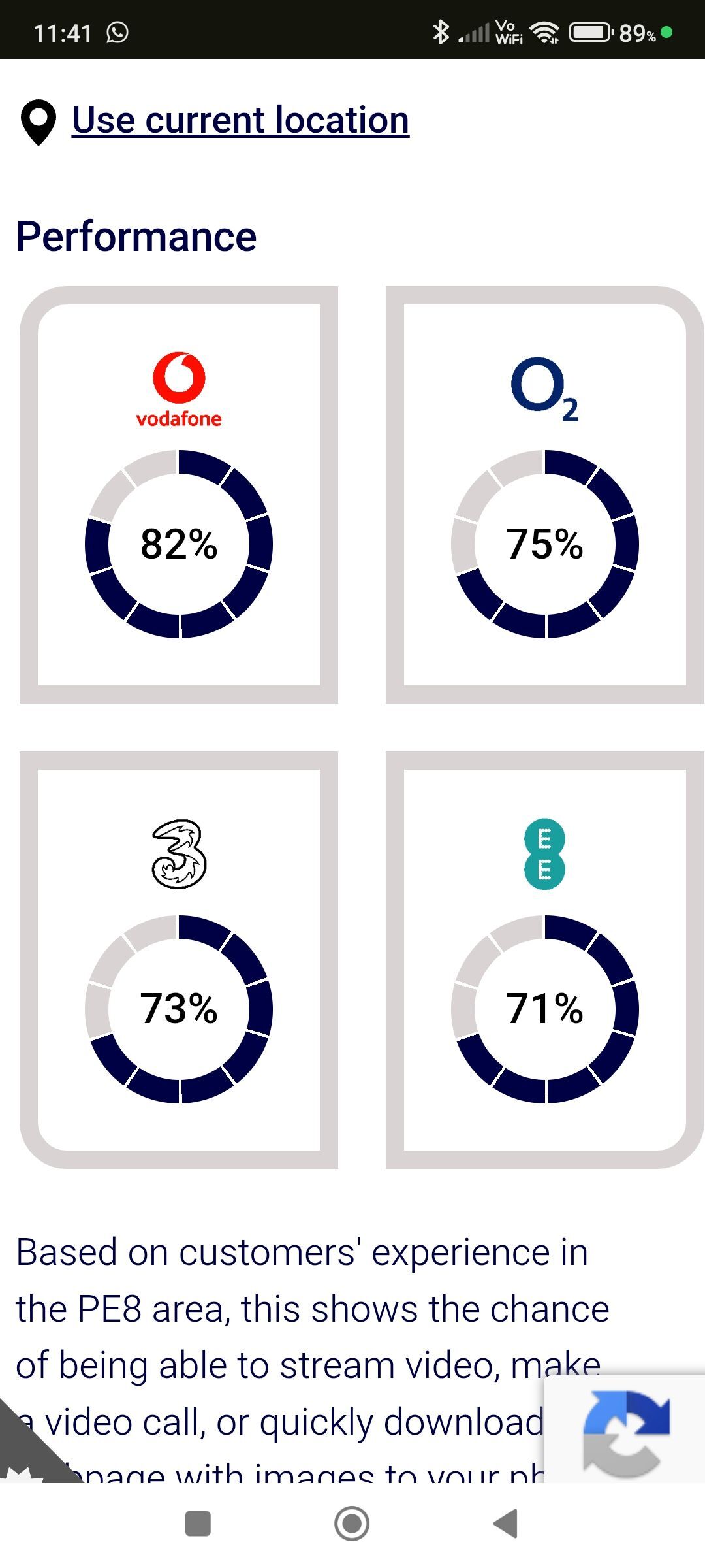

  6. 2 minutes ago, blackrose said:
    Thanks, are you streaming TV?
    Everyone's on 3 around here but I'm not sure if that's because we're all misers.
    According to Ofcom 3 is slightly better than EE in this area and I heard 3 have just merged with Vodafone so once they sort out the technical issues they've been having after the merger hopefully things will improve.
    I'm sure the Ofcom website used to show coverage of mobile voice signal and data signal separately but they don't seem to do that anymore. Maybe it's all the same these days.
    The problem with coverage checkers like that is that they're looking at signal strength, not network congestion which is often a bigger problem -- especially on 3 because lots of people use this as it's the cheapest network for big/unlimited data, result is it slows to a crawl at busy times.
    EE has better overall coverage for signal but also suffers less from congestion than 3, because it's more expensive and has fewer data gobblers using it...
