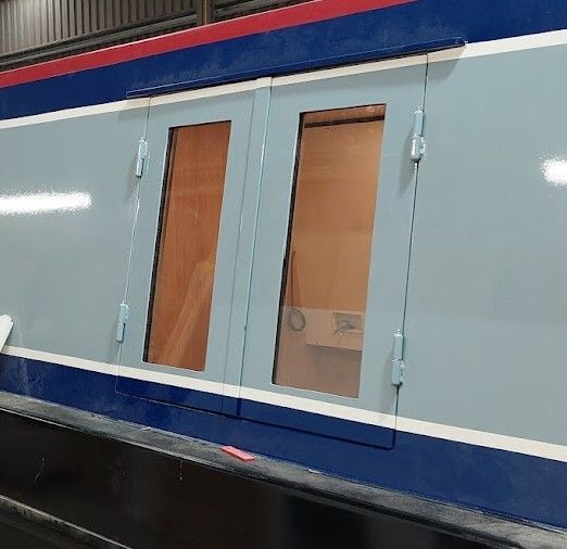

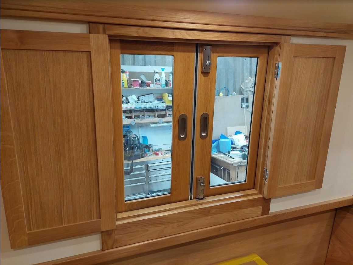

  17. Mine are the other way round -- steel doors with windows on the outside (lined with oak internally) with wooden shutters inside.
    Not as secure as solid steel, but means you can have the outers closed to keep the rain out and still have light inside the boat -- with solid steel doors outside and glass/perspex ones inside it's very difficult (maybe impossible?) to make the inners water/rain-tight with the outer doors open.
