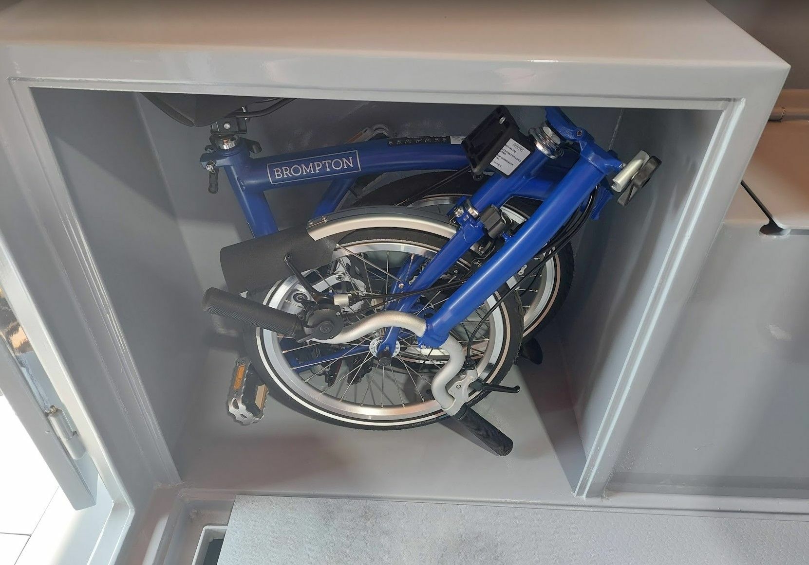

  8. 28 minutes ago, David Mack said:
    I seem to recall that someone on the forum had a bike locker built into a newbuild. As I recall it was a semitrad stern with a conventional seat locker on one side and a full height bike locker on the other, with the locker accessed by a door in the stern bulkhead. With handle bars turned through 90 degrees and folding pedals the locker could be quite narrow yet accommodate a standard (non folding) bike. Secure storage, with no need to bring a possibly wet and muddy bike into the cabin. Although presumably a bit difficult to clean (or repaint) the inside of the locker.
    That was me, and the locker was designed to fit a Brompton -- and it does, and the locker is just the right height to perch on while steering... 🙂
    A towpath has to be pretty bad to make a small-wheel bike like this unusable -- I had no problems last year with the Brompton anywhere between Sheffield and Anderton, and I've cycled the towpaths for several years in the past on a Moulton with similar wheels/tyres. Yes if it's *really* muddy a bike with bigger wheels and chunky tyres -- like I use regularly near home -- is better, but then you have to find somewhere to stow it, which is no problem given a shed at home but more difficult on a boat.
    It's the same issue as with a camera -- yes if you want ultimate quality and are willing to hump it around a DSLR with the appropriate lenses will undoubtedly take better photos, but what matters most is having a camera with you in the first place -- which is why most photos nowadays are taken on smartphones.
    A small folding bike like a Brompton is not as good in really bad conditions as a bigger one, but it's a lot easier to fit in and have handy when you need it -- and great for taking on trains and buses on the way to/from the boat. OTOH they're expensive and allegedly are thief magnets... 🙂
    Guess what -- usual issue with boats, every solution has good and bad points, you pays yer money and you takes yer choice... 😉
