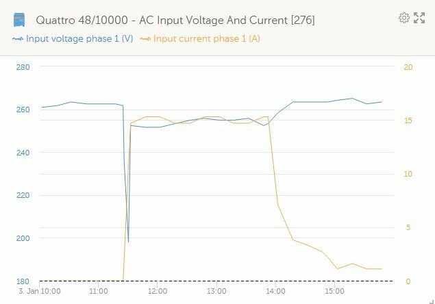

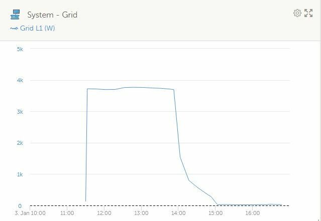

  16. 57 minutes ago, Tracy D'arth said:
    Trying to get 260A plus inverter losses out of batteries is not a good idea..............
    I have found practically no marinas where you got the full 240V @13A supply to a boat.  Some are only 5A
    Best I found was a dairy farm where the electrics were straight off the overhead into their own transformer. You could see 256V when they were not milking cows or cooling the tanks.
    The marina I'm at (Uplands) will happily supply 16A/230V (3.7kW) for several hours continuously...
    (this is after the isolation transformer which has a slight step-up, so shoreline input is 230V/16A when charger sees 250V/15A)
  17. 52 minutes ago, Tony1 said:
    Obviously I'm no expert, but my hope/expectation is that placing a B2B charger between the LA and the lithium bank will resolve point 3.
    I use victron 30 amp B2Bs, and my understanding is that no current can flow from the lithium back into the LAs.
    The fourth issue is managed by setting a safe bulk charging voltage on the B2B, e.g. 13.8 or 13.9v.
    From what I've observed, when the lithium gets up to about 90% full its voltage will start to rise above the bulk charging voltage in the B2B, and this causes the B2B to go into float mode.
    If you set float voltage to something like 12.5v, it means effectively no further current will pass into the lithiums.
    So maybe a B2B does provide a step up in terms of safety from a simple 'long wire' setup?
    Certainly it allows more precise control of the charging that is done to the lithiums.
    On the downside, as has been said here many times, B2Bs are very inefficient, and not really very a cheap solution, and who knows whether they will be deemed acceptable by potential future regulations?
    A decent B2B isn't inefficient (well over 90%?), and should be accepted by future regulations since you're treating the LFP properly/safely, not connecting it in parallel with LA and charging from an alternator. Make sure the B2B does have settings suitable for charging LFP not just LA.
    Not sure that 30A will be enough though if you want to minimise engine running time when charging, something that can use more of the alternator's output (without overheating it!) would be better, so long as it doesn't exceed the maximum charge current of the LFP. What size alternator do you have, and what's the LFP charge current rating?
