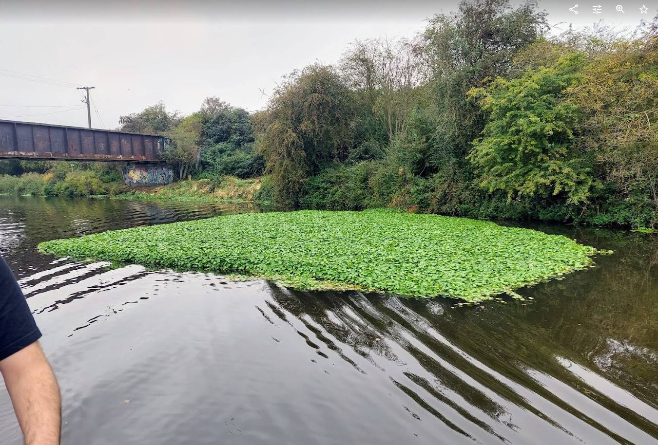

  19. 5 hours ago, Ken X said:
    Don't know about duckweed and algae but the floating Pennywort at Alvechurch is thriving. Saw some at the Shirley lift Bridge as well.
    Floating Pennywort is probably the biggest hazard nowadays because it grows into massive mats really quickly, we've seen some huge ones -- this is actually one of the smaller ones... 😞
