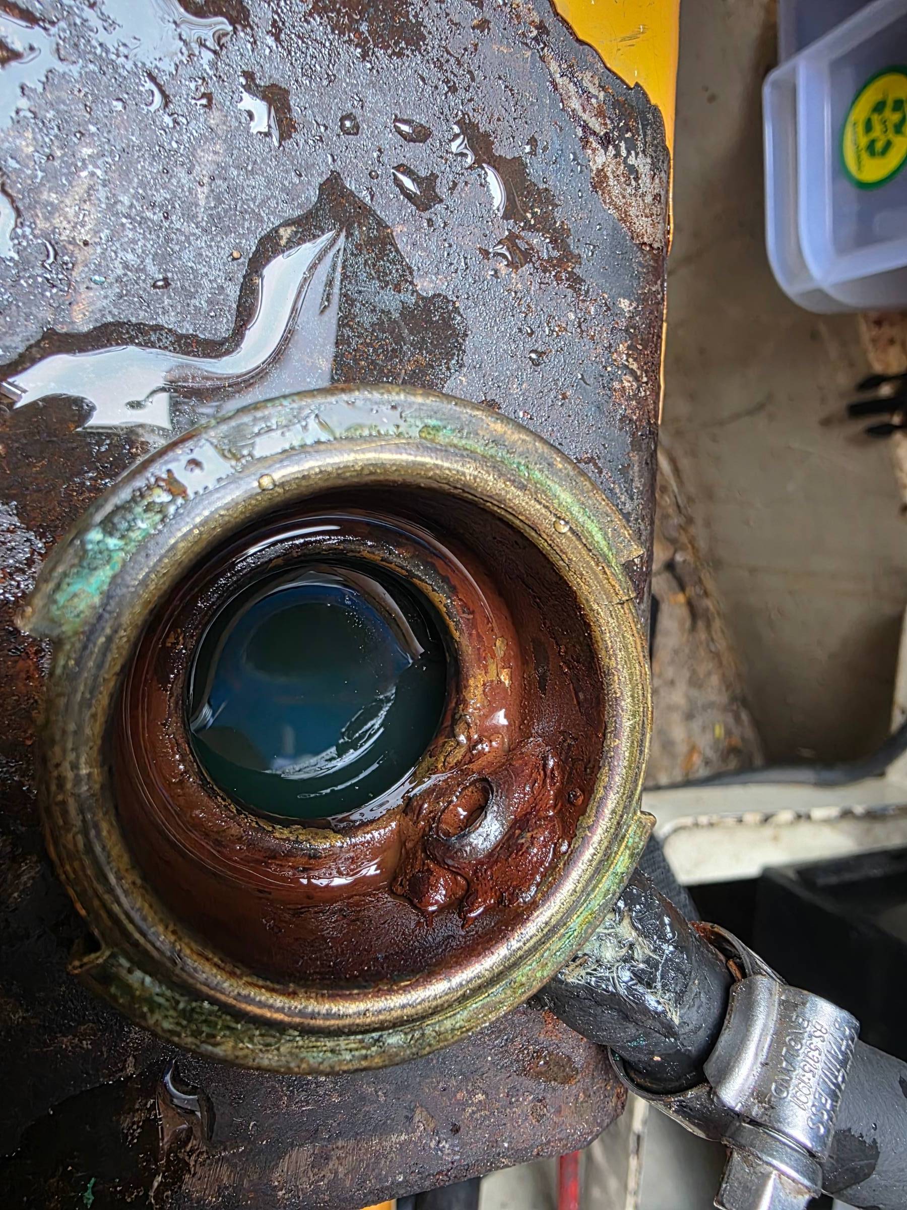

7 hours ago, Emilyandrose said:
It might be possible to replace the entire neck, speak to a vehicle radiator repair company first, they will require the manifold to be removed and taken to them.
The brass neck will fixed to the cast manifold, soldered?
Bod
