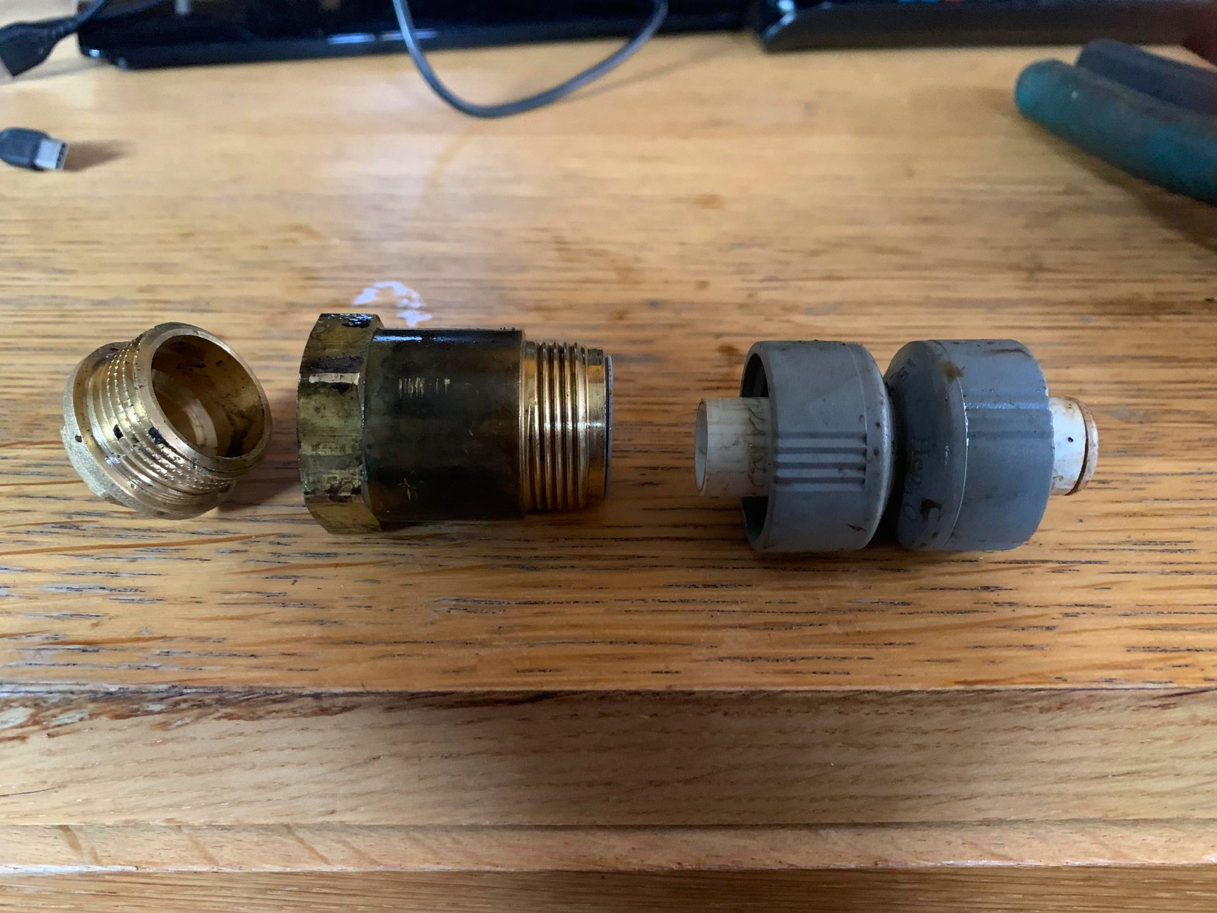

    11 hours ago, Tracy D'arth said:
    So now when you get your new accumulator, tape the thread, 3 full turns, wound  the same way round as the thread,  and screw it into the Hep2O fitting on the plastic pipe.
    You have a 15mm Hep2O to 3/4" BSP Female fitting on the pipe.
    Difficult to make you a plumber overnight, it used to be a 5 ear apprenticeship, but you are doing quite well !
    You will need to set the air pressure in the new accumulator. Fit it as it comes pre charged (hopefully! ) and switch the pump on. Let water out of all the taps to get rid of the air. Close all taps and let the pump run until it stops.  Very, very, slowly release air from the Shrader valve on the top until the pump just starts again. Done.  If you let too much air out top it up again to about 40 psi with a bike pump. And try again.
    I've read this a few times and I think I understand.  Thanks.

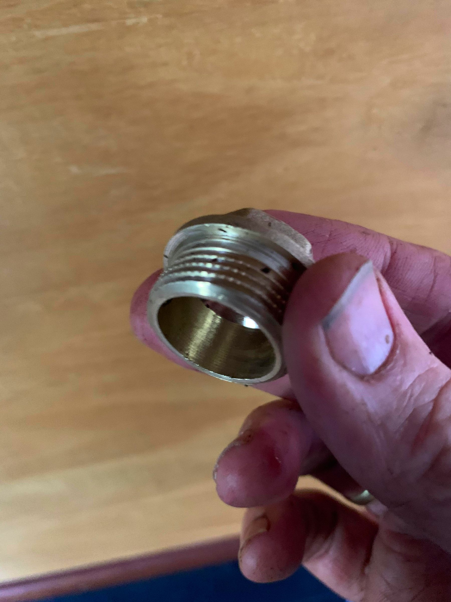

  8. Update:  At 3:30 I discovered that the nearest place I could get PTFE tape was an hour and a quarter walk away.  And the place closes at 5:00.  So of I went at a brisk trot to get there before it closed.  I made it, and after a 2 and a half hour round trip, and returned with a roll of tape - cost 60p!  I've now refitted it all and, hallelujah, it seems to be holding (touch wood).  Well it's been a rather tiring day.  My phone tells me I've walked 28,000 steps, which is good exercise, and best of all, I get to have a shower now.
    Thanks everyone for all your help - especially Tony, I think I owe you a pint some time.

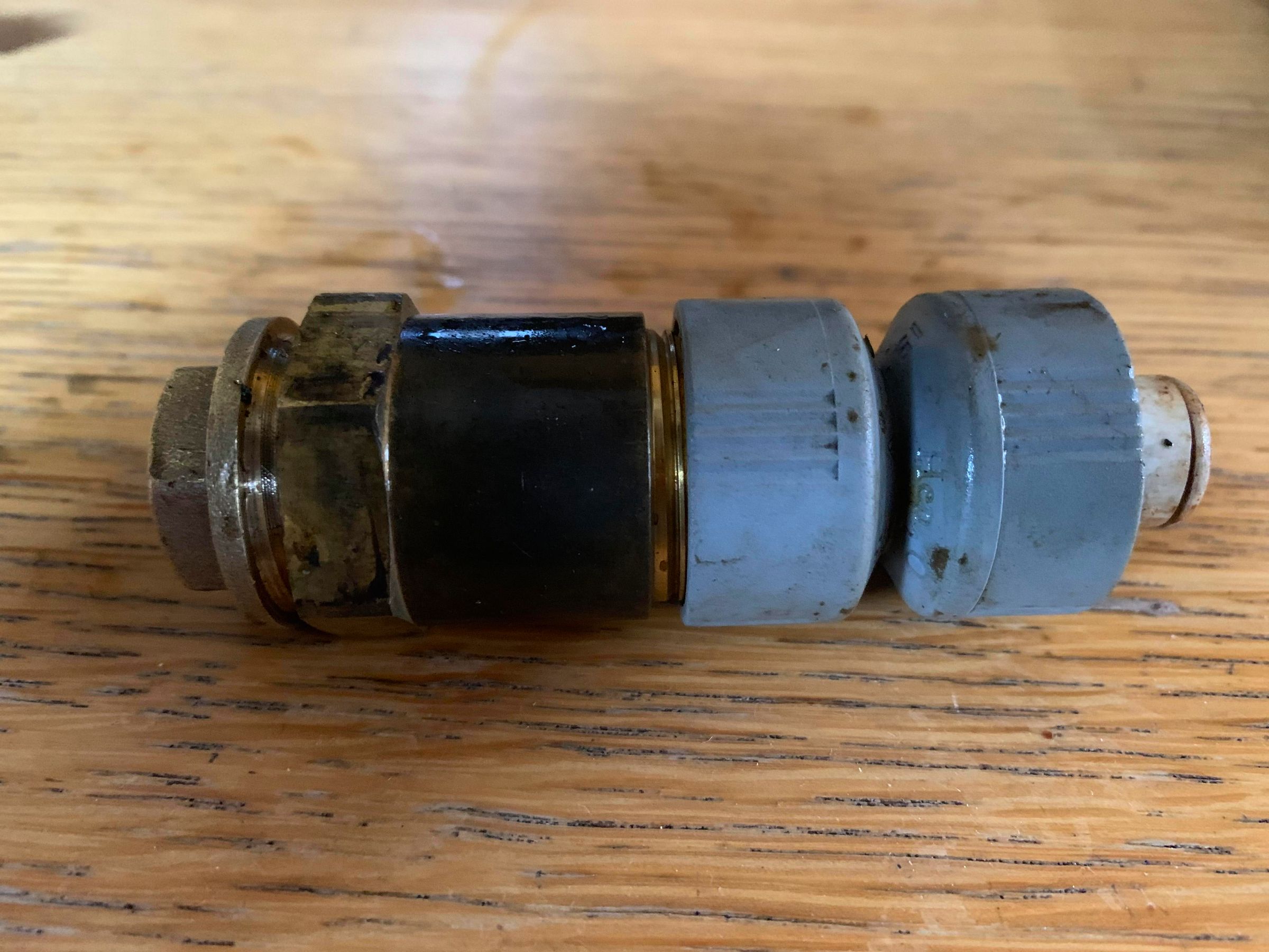

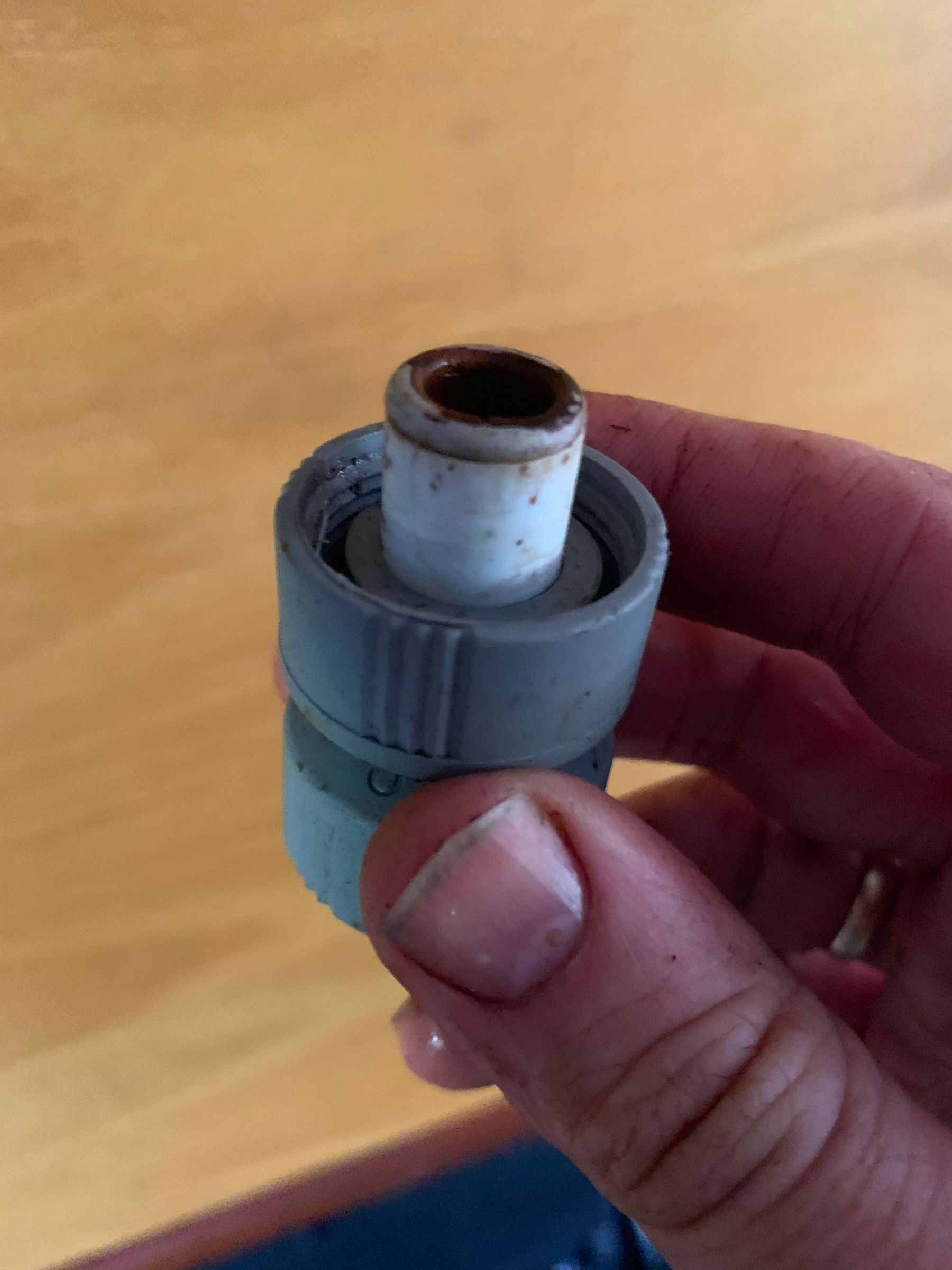

  9. 1 minute ago, Tony Brooks said:
    I think we really need to see all that parts laid out. I think there may be a rubber washer missing but can't be sure. To be honest it looks a bit of a bodge to me and I can't think of any "houshold2 items that would take the place of PTFE tape, not that I think the lack of  it is the problem.
    I'll take a picture.  The brass fitting I took off the accumulator has ptfe tape in the thread, so that's why I assumed that.  Give me 2 minutes

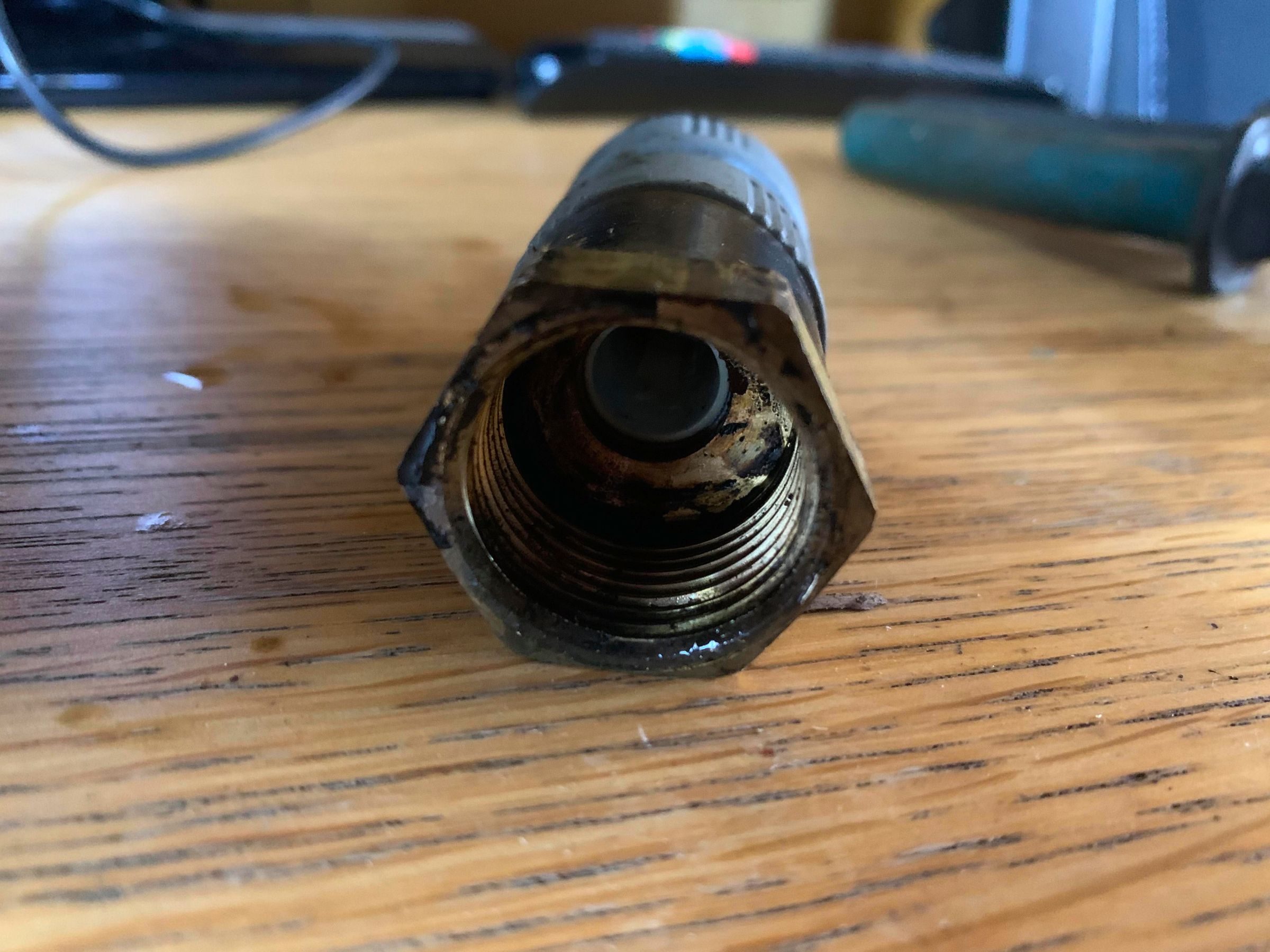

  10. 7 minutes ago, Tony Brooks said:
    That looks like a plastic pipe equivalent of a compression fitting, I don't know how it sealed to the accumulator and the new one may not screw onto it. Lets see the bottom of the accumulator.
    There's another piece which I've found which I thought was part of the accumulator, a brass fitting.  I've taken that off and it all goes together now!  So I  put it all on and it's weeping.  I suppose there should be some ptfe tape in the thread?  I don't think I have any of that.  Any clever ideas?

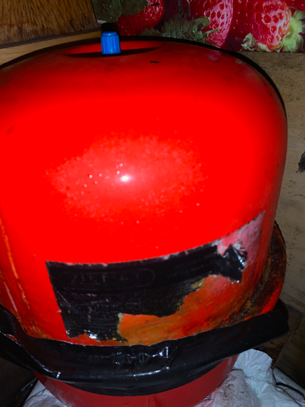

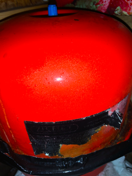

  13. 6 minutes ago, Tracy D'arth said:
    If its loosing water from the steel shell it has already leaked from the rubber bladder inside, its scrap, you need a new one.
    Incidentally the red ones are usually for sealed central heating systems and not for fresh potable water at all.
    If you cannot find one quickly, put a treaded plug, most likely 3/4" BSP thread, in the tee that it is screwed into instead. Then you can have water but will have a burping pump and may be an initial weep from the PRV when you warm the calorifier up.
    Is it this what you mean? https://www.plasticpipeshop.co.uk/34-BSP-Threaded-Plug_p_4270.html
    The problem is I can't even see anything.  The accumulator is sitting on a wooden base and is boxed in underneath.  I can't even work out how to remove the accumulator right now.  And I'm tired!  I'll be able to look again in the morning.
