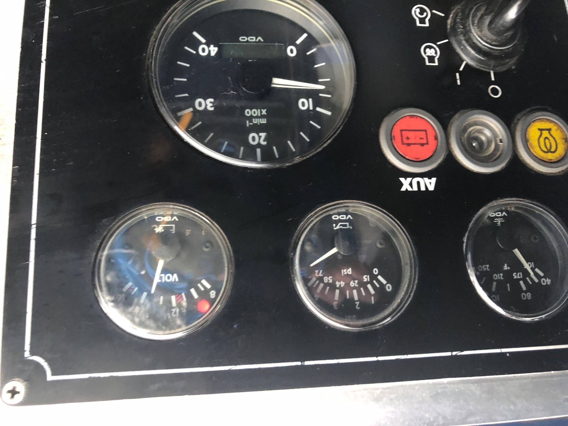

  7. 1 hour ago, ditchcrawler said:
    Is that on when the engine is running or prior to starting with the key switched on or with everything off
    That’s when engine is running.
    1 hour ago, Tony Brooks said:
    They/it are usually controlled from the alternator, but turned on by the ignition switch, so do you have a single or twin alternator engine? In the later case, the BVM would be looking at the domestic (larger) alternator, while the engine start alternator could have failed.
    The normal operation is turn ignition on, light should illuminate, start engine and possible give it a rev and the light should go out ast he alternator starts to charge.
    Things are not quite hat simple unless we know the alternator(s) make & model or photos to identify them.
    It could also be a wiring fault but lets see what you actuall have.
    two alternators, have never seen the light come on before.i think they are 120 amp domestic and 90 amp start alternators, but will check and photo tomorrow. The light stays on throughout a cruise.
    1 hour ago, nicknorman said:
    Do you mean the small red light inside the Volta meter (it’s hard to see whether it’s on or not). If that one, it means the engine alternator is not charging, which is rather born out by the sub-14v showing on the meter.
    Oil pressure looks very high for engine idling, does that gauge work?
    Yes that light is on. The meter reading is always about there, also the oil pressure reading has been like that over ten years. I trust the victron battery meter which shows leisure’s are charged appropriately. Starter battery has worked fine last two days, only noticed light last night when running for charge.
    Both showing 12.8v on internal engine battery monitor.
  8. Could anyone tell me what the red light coming on in the control panel means? It’s on the battery monitor control panel. My battery monitor Bmv tells me everything is charging fine, ie leisure batteries. Never noticed the red light come on before, what would it usually signify ?IMG_1779.thumb.jpeg.3236989a0d6c3032b93f4d7eca1231f0.jpeg
    Upside down for some reason, but you get the picture. Never lit up b4.
