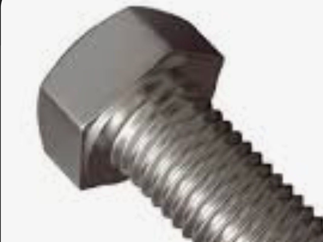

  23. Agreed, but you can get pretty close and you don't need a recessed area in the shaft between the thread and the flat face.

  25. They do, but for some reason that specification isn't disseminated to their customers with the product information. You have to go looking for it yourself on their website. I think it would be weaker than threaded part because it's wider than any part of the thread of the same diameter. Which is precisely why it sheared at that point. If a thread extends the full length of a bolt or doesn't prevent one from tightening it.
