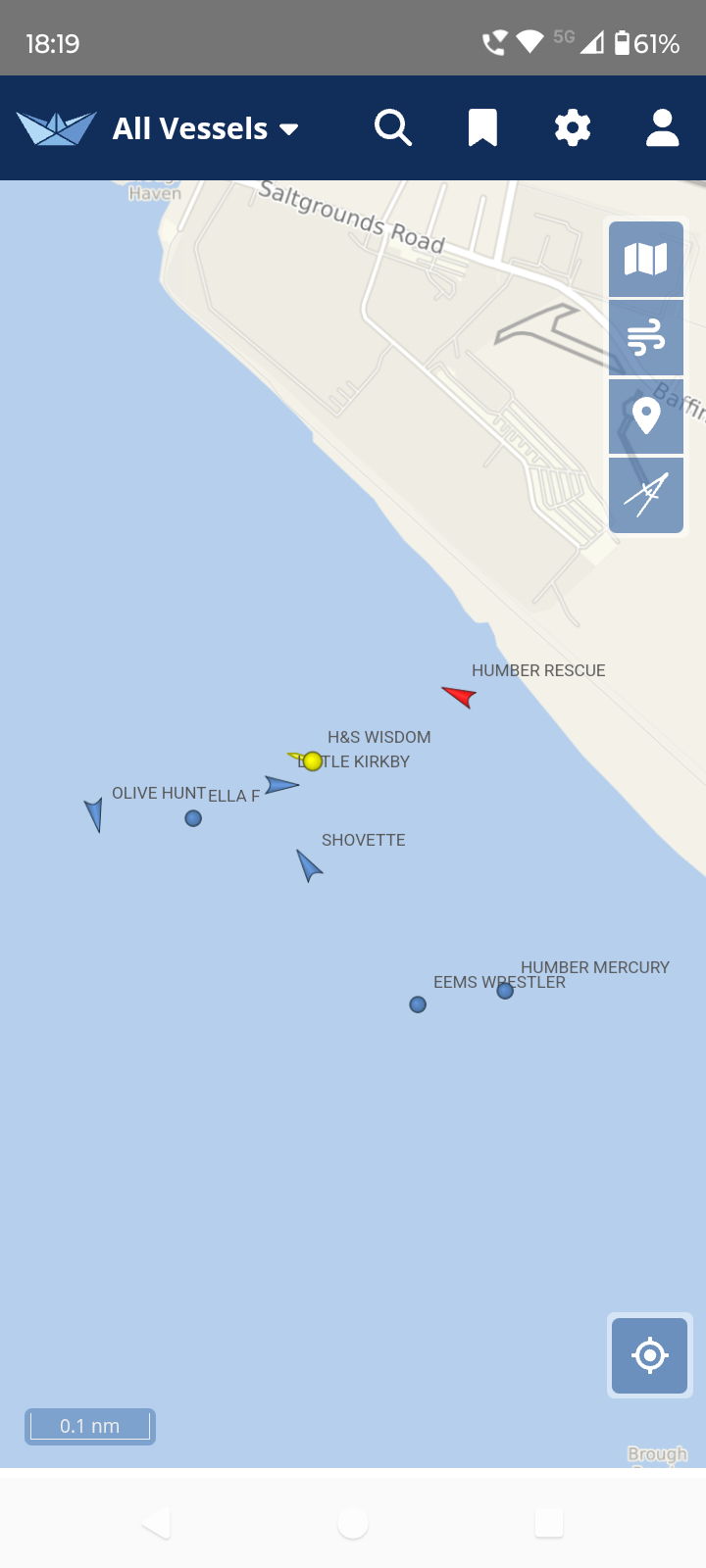

  4. I was wondering that too. Or are they just showing them the way through the sandbanks 😅

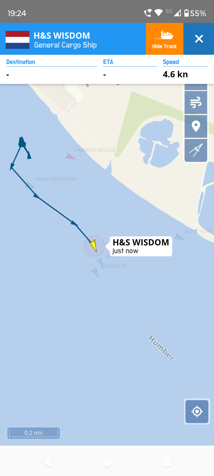

  5. Four tugs, a pilot boat and a Humber Rescue boat all milling around the stuck ship at the moment. High tide is due at Hull at 1910.

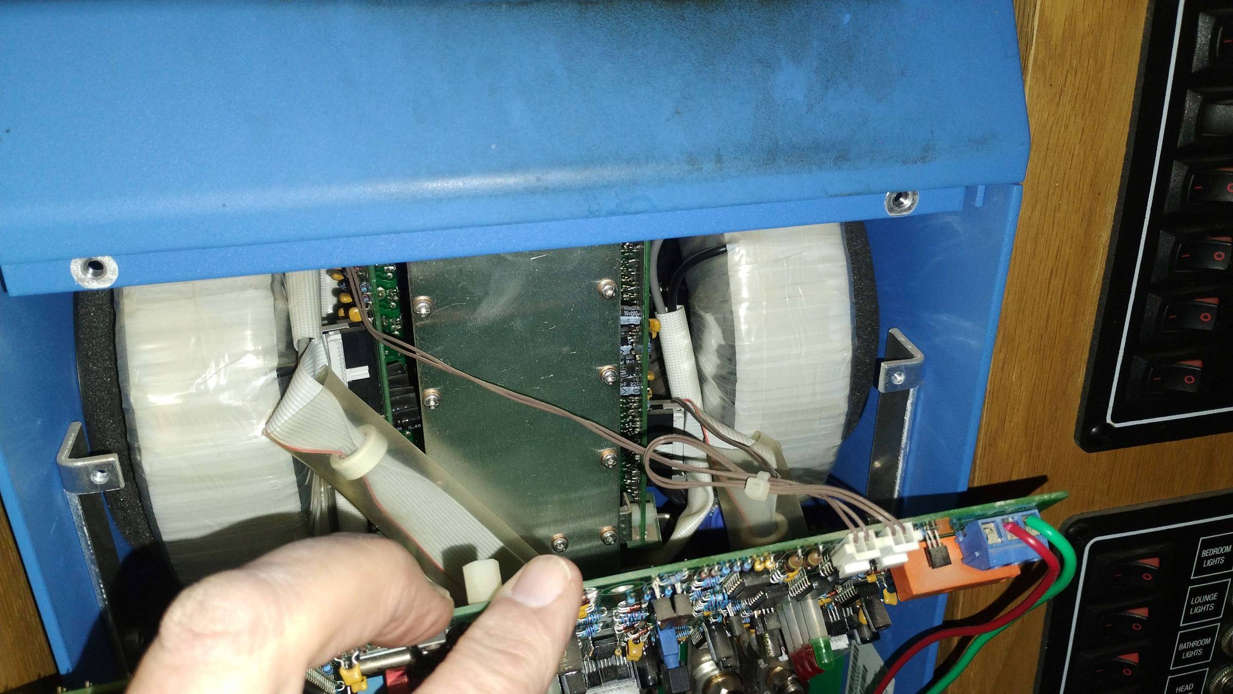

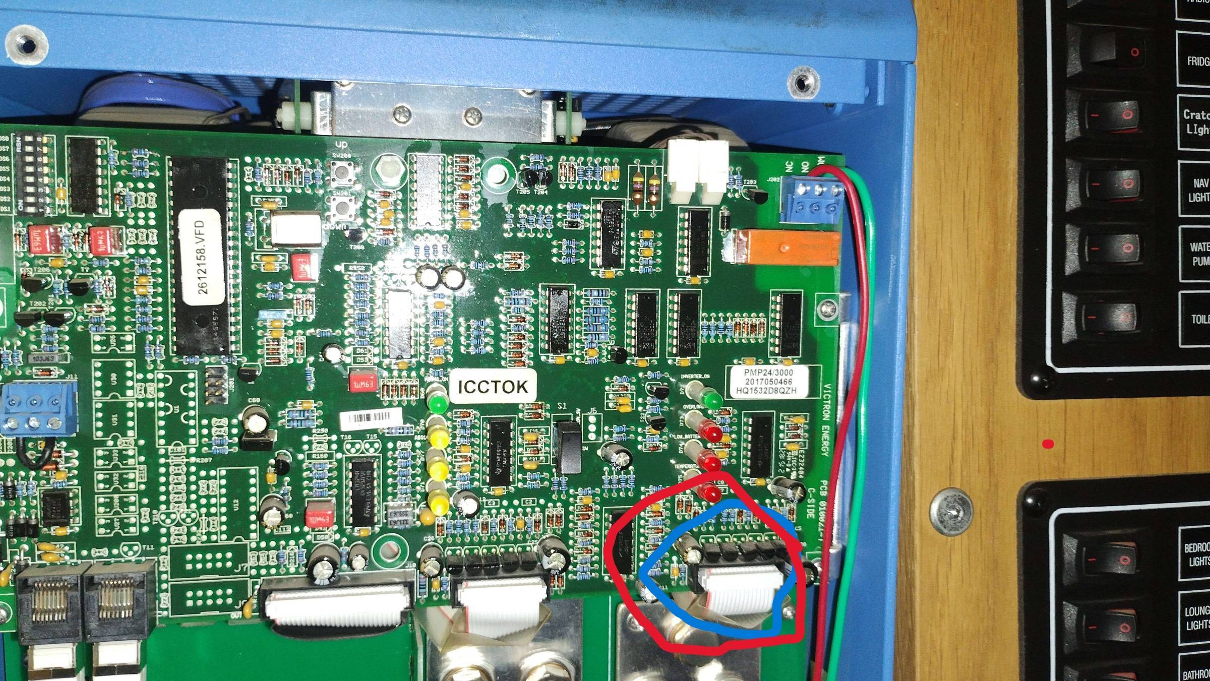

  7. Hooray!! 😊Ribbon cable was the culprit. Thanks all especially @cheesegas and @IanD. There's some chunky hardware behind that daughter board! Telephone systems from 1983 to 2014 never had such chunky stuff!
  8. Thanks @IanD I have now reverted to 2.53 and the old v1 GUI. No change I'm afraid.
  9. Thanks @cheesegas for the info. Do you mean the ribbon cable on the bottom right in this photo or do I have to take off the main board? I haven't got ve.config connected yet, I'll let you know. Also it's not a Compact, but a standard Multiplus.

  12. Yes... I have come to that conclusion too 😞. I'll take the cover off tomorrow and see what I can see. I can't find a reference to "current sensor" in the manual though. All those high hopes dashed!! 🙂

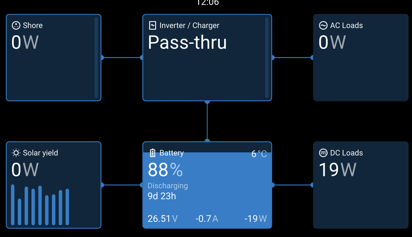

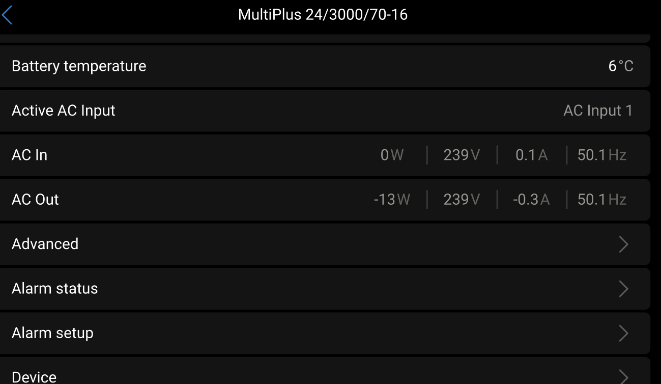

  17. I forgot to mention that when the shore power is disconnected all the readings including AC out are correct. This does sort of point to incorrect detection of incoming AC current.

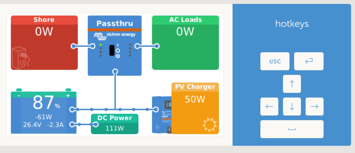

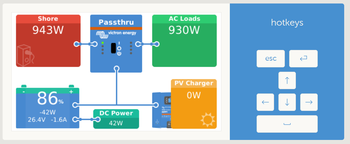

  20. Well this is interesting. These have been taken just now via the remote console. The first one shows an AC out reading that I would expect right now, a couple of remote cameras etc. but the second one is of the overall view screen and doesn't match the first.

  23. The readings are the same locally so yes it's a local issue. I've been trying to think of such little things but can't think of anything.
