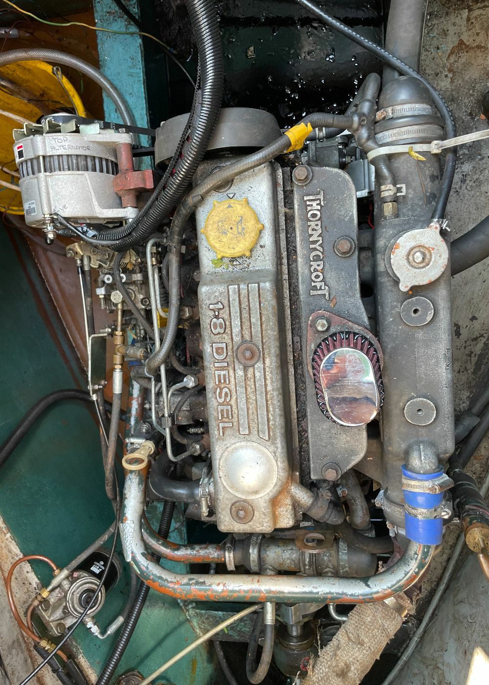

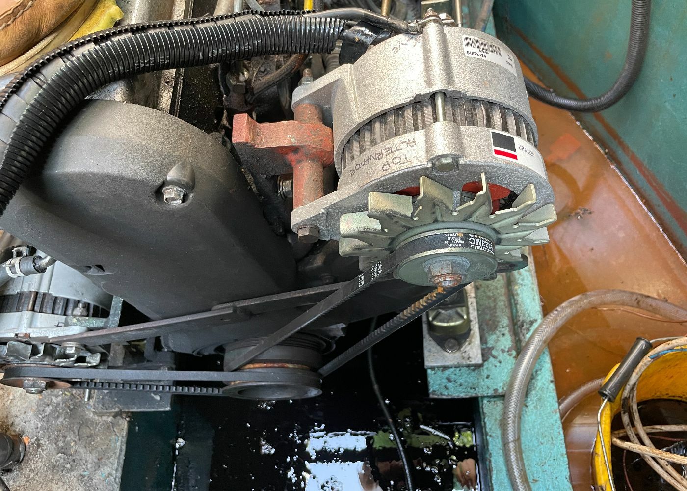

Hi all, thanks for your input, very helpful! the plan is to remove the crank pulley which is actually 120mm diameter and send it to a workshop to machine a new one to the exact same specs but with 6 V ribs for each belt and 190mm diameter. the whole thing is to have a better grip and higher speed from the alternators. I don't see anything else driven by this belts, no water pumps, nothing. the engine is Thornicroft 1.8 but when I contacted Calcutta I have been told that this is not an ordinary BMC or Leyland but looks like a Mitsubishi engine, branded by Thornicroft. So I'm with decision to make, does it make sense to take the pulley off and send it to be copied in larger version, and could this later on damage the engine cause of a higher torque? And would the fact that I take the crank pulley off will create some issues, especially if I run the engine in the meantime? Cheers -

Hi all, Just removing my crank pulley to send it to a workshop to re-manufacture one with V ribs, but still will need to run the engine on daily basis for heating the water. So this is the question, can this possibly damage the engine, running at some 1000-1100rpm with no load? The double alternators I actually have still create some load and and disconnecting them, does this change anything? Thanks for replies.

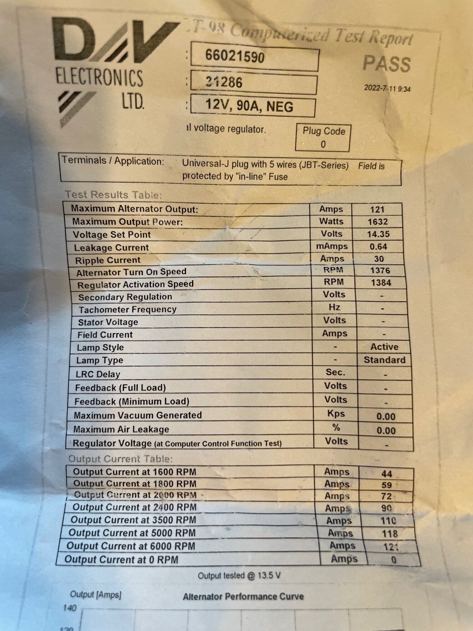

Hi all, just got a new alternator to replace a dead one and out of the box I find out that the opening rpm’s for the regulator is 1384rpm. the whole idea is to use it as a battery charger at idle at 800rpm so my question, will it work as it and will still produce something anyway or I need to replace the regulator (by which one? Any suggestions?) ? Thanks in advance
