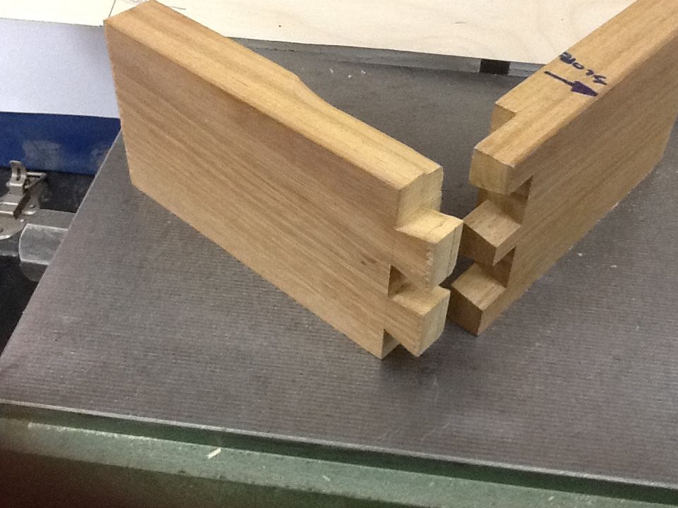

That's the name used for the type used on a drawer front so that the ends of the tails are covered and not visible from the front.
The advantage is that it avoids the problems caused by dovetailing a rebated timber section. I've seen similar joints used for the same type of job but I have no idea of its proper name. I'm sure I've seen some with an angled shoulder which I think is for water checking the joint, again I can't remember where!
Mike.

I was about to post an easier method of dovetailing the corners of the deck lights but I was interrupted and failed to complete the post. I couldn't remember exactly how it went so I made a model with two bits of scrap timber.
The missing bit of the top edge is where I tested a cutter shape. In the event of me making another deck light I intend to try this out. It's simple enough and easy to do, but hard to get my head round without the model to hand.
Mike.
