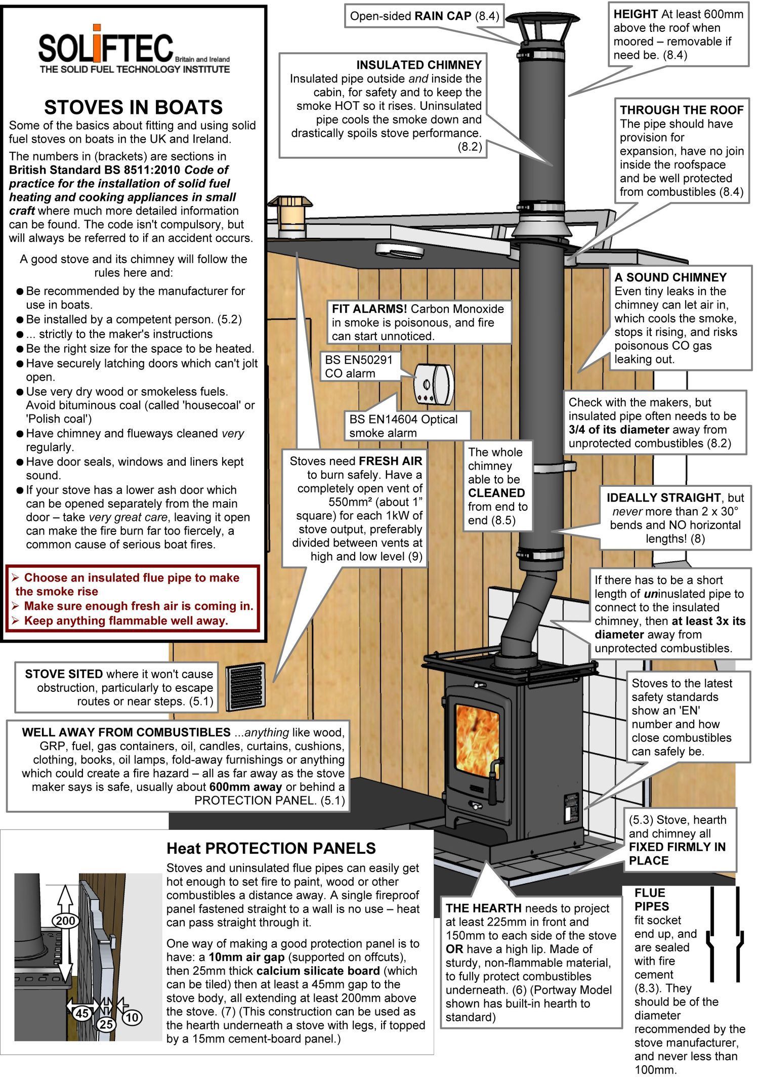

  7. Hi we basically was sold this system when we knew little and have only realised now the issues so just want to get it right now. To be clear we have 3 sections of flue 1 x 1000mm and 2 x 500 mm the 1000 mm is in the cabin, half of the 500 mm is between the cabin and outside with no join and the other 500 mm can be removed when cruising as is scre on attached to the section sticking out through the flashing. The main issue it seems is between the ceiling and roof having no support there so if we get that additional support for that area such as the picture I sent then this should stabilise the flue with the other supports internally am I correct if not will call someone in as dont really want to change the flue system my husband falls a lot and dont want him to burn himself he has a disability that means he is very unsteady.

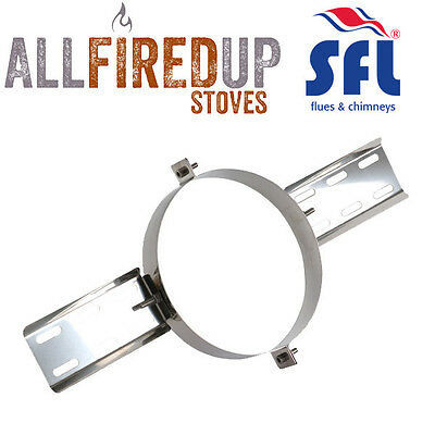

  8. Hi thanks am using a twin wall the only part I can see for between the roof and ceiling is pic attached there is rubber flashing on the roof but there will be no join between the roof and ceiling of the flue so will be one flue section going through .
  9. Hi everyone we have decided to go for a chilli penguin stove as overall this stove is not right for us anyway and am ordering it soon when I get paid. Just wondering as want to make sure this is right this time in looking at the diagram online for stove fitting frI cant see a roof support between the ceiling and roof like the pic attached do people fit these types of supports in boars and are they necessary? Thanks
  10. Hi we have decided to order one of these stoves thanks for the recommendation can I ask do you have a roof collar with yours I.e something that holds the flue in place through the ceiling and roof ?

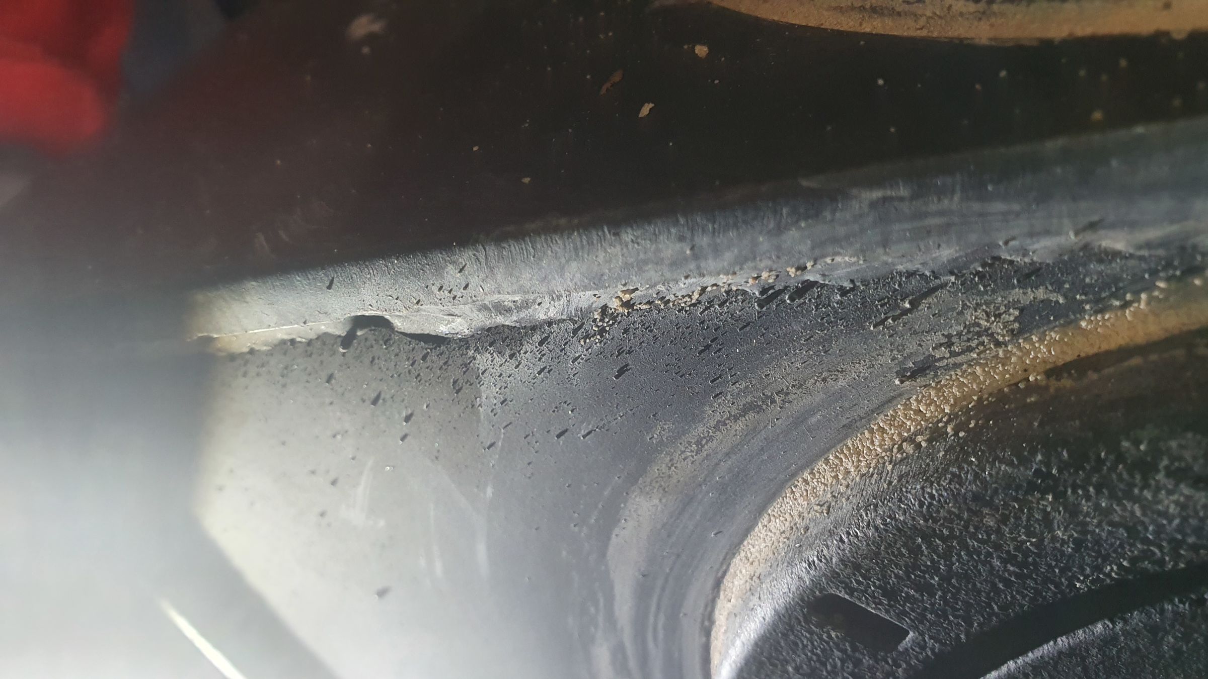

  12. Hi this is the top of the stove where it joins the back of the stove there is a pin prick size hole am going to fill with fire cement. Have got the spigot off and there was no fire rope behind and neither was there any on the plate at the back I am disgusted with the fitter. I am going to put fire rope where it should be where the spigot meets the stove and reseal it all am thinking this was why the flue was expanding so much
  13. I have just taken the stove apart again with a view of getting the spigot off to check rops I can see a tiny hole where the weld is daylight is coming through wondering if this can be filled with fire cement or is this not useable it is a very small hole hard to see from the pic

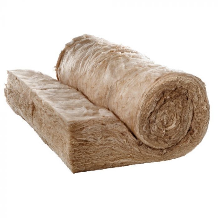

  15. Hi thanks for the picture that is exactly what we have and it is tight. The whole ceiling is filled with insulation the one in the pic the person installing the fire took it out from that area but I have some left so can easily stuff that up there does it matter if it touches the flue ? This is the stuff it is called knauff earthwool
