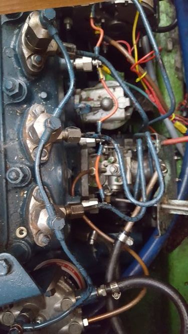

  10. Thank you. The oil level is ok. I don't think there is any air in the system as it normally revs up before dying if it has air and i had a friend look who said it seems ok. I am baffled as to why the revs wont go over 1500 when in gear as they go to 2100 when in neutral.

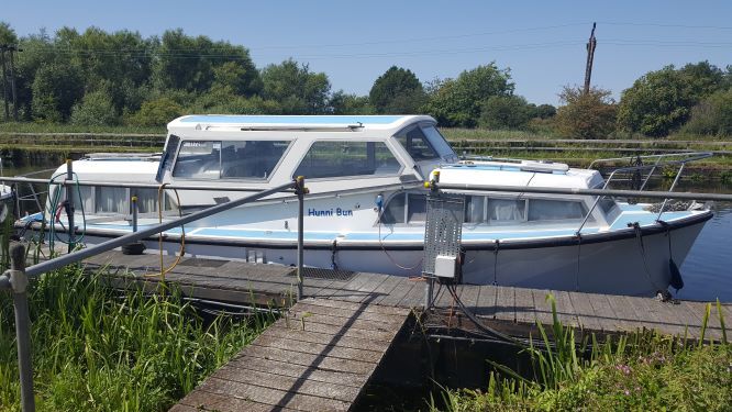

  13. It was definitely the oil pipe. I said they were useless! WE had someone interested in buying the boat as well! t is a 30 ft broom skipper so too heavy to tow far.

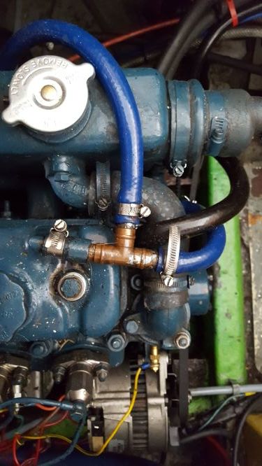

  14. I also forgot to mention that after temperature got up to 95 degrees the water level had not gone down when we took the header cap off! The revs wont go over 1500 now used to go to 2100. Any idea what this means? I will try the London Facebook to see if they know of any engineers. Thanks
