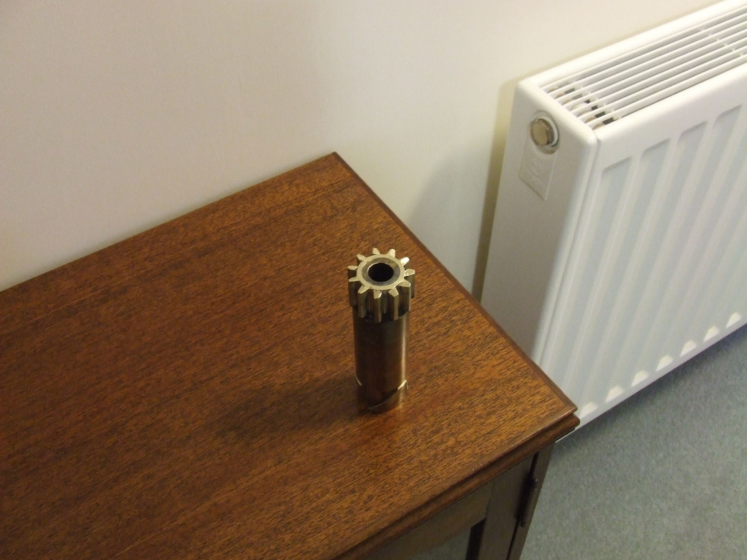

  5. The pinion housing has a screw plug for inserting lubricant - what should I put in it? 3 in 1 ?

  8. I have had the teeth brazed and filed them up as best as I can, then put a 20 degree lead-in on the ends. Next to re-assemble, put the motor in the vice, and see if the trip is operating too early.

  11. Interesting to see that your flywheel teeth have a square front. Mine have a definite lead-in. My bronze pinion is considerably worse than yours, but I have left it with J.B.Place & Son in Tyseley this morning, and hope to get it back tomorrow or Wednesday suitably made good. Then I have some filing to do.
