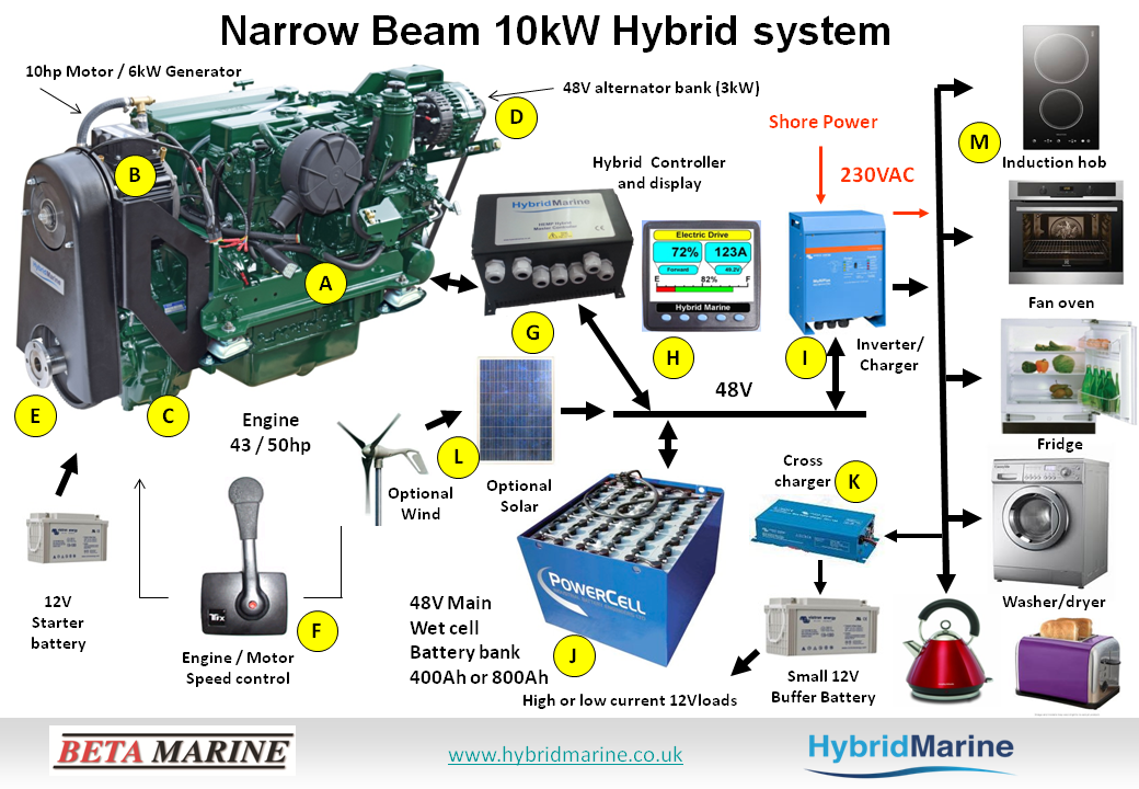

Based on their math and generation of 7KW I don't see an issue of getting 1 hour of electric propulsion from 1 hour of diesel propulsion (but that doesn't include any other consumption). As for the benefits - I see some: - having 3 hours of 'silent' cruising every day (we tend to cruise for 6-7 hours a day) - going through the locks without diesel exhaust - no need to think about gas bottles - I find non-gas hobs and stoves much cleaner (and we all are a bit OCD when it comes to clean kitchen). - We plan to have half of our cruises to be short trips (2-3 days) - so batteries can be charged from the shore, where diesel generation is an addition. Having said that - I do understand that it all could be better, and the price is frightening. And I'm sure in a couple of years hybrid generators will produce more, while batteries will cost less. So my original plan to get a second-hand NB and only few years after that get a new build with a hybrid system seems the most reasonable to me (I do understand hybrids are not everyones cup of tea, of course). -
Budget for a second-hand boat and some questions
MajorJones replied to MajorJones's topic in New to Boating?
400ah will set you back in a region of £24k and they have a 'double the battery' offer with the larger inverter ( 5kVA / 10kVA peak) for around £27k so you can get up to 12h cruising. Also, The nice side effect is that you can remote control your boat (handy when you do locks alone). The best way to charge it is when cruising - 1200rpm gives you 7kW generation capability. Plus, I don't think it makes total sense without an array of solar panels (something like 8 x 160W). So for me personally it all sounds absolutely fantastic. The only thing that doesn't - is the price. -

If I go with the hybrid system I'm copying what has done few times already in the last two years using ready kit from Hybrid Marine, but I have no intensions of going "ultra green" - idea of a hybrid kit and webasto doesn't sound wrong to me. -

I'm trying to understand what's the difference between 'finished' boat and what LMBS is offering as lined+, so far I understand I'm missing: - "kitchen" (galley, appliances) - dinette, furniture - webasto - radiators I don't want/need stove - it's a holiday boat for us, so I'd rather have more space and go dust free. As for the gas - I've decided that if we go second-hand it will be a traditional engine+gas, but if we decide to take lined+ to finish it I'd go with the Hybrid Marine 10kw system (so no gas at all). Have I missed something still? -
