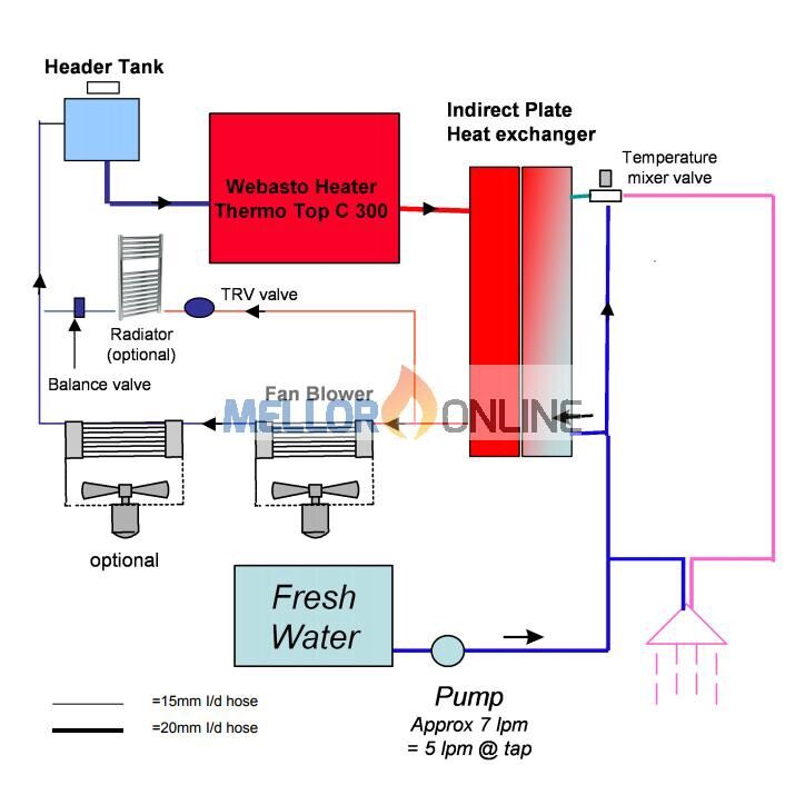

It was the god damn cheap pump, finally got it working. Lesson learned. So you recon it’s worth fitting bore bypass to the header tank in the near future. The header tank we have is is the same as what Awayonmyboat has talked about with a cap on top two hose barns on bottom and should pressurise as water heats up

It’s installed with one fan blower and one radiator/towel rail. Will reset webasto again just in case it locked out but it didn’t seem that it overheated the time it worked after installation. Ran smoothly and was turned off on the control by us until the next day. the header tank has a screw on lid after system was bled Was closed so I don’t know how air would be introduced and entering into the system

While it’s not common in boats we consciously choose this install as our friends have had this system for years on a boat. Will take into consideration fitting bypass valve into the system

Installation guide for heat exchanger system does not show necessary bypass valve. Header tank used to feed in and out on two ends (I have been assured is one of the two options )

That’s a system with a calorifier tank no? We have a heat exchanger so no bypass valve
