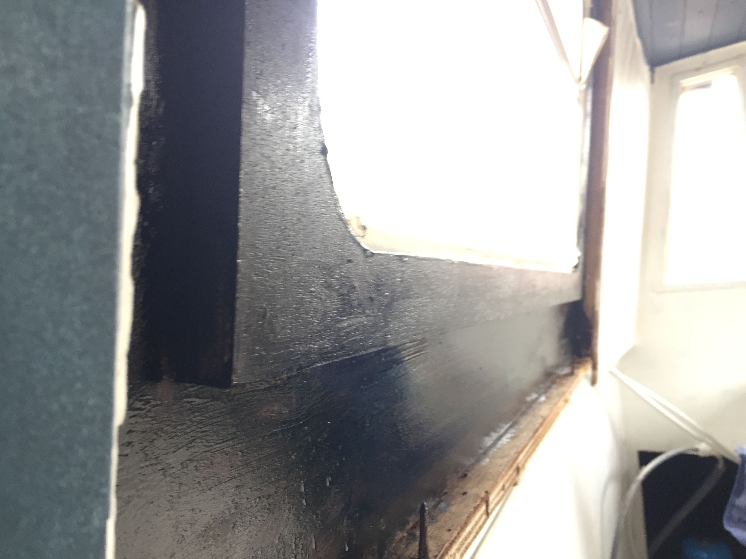

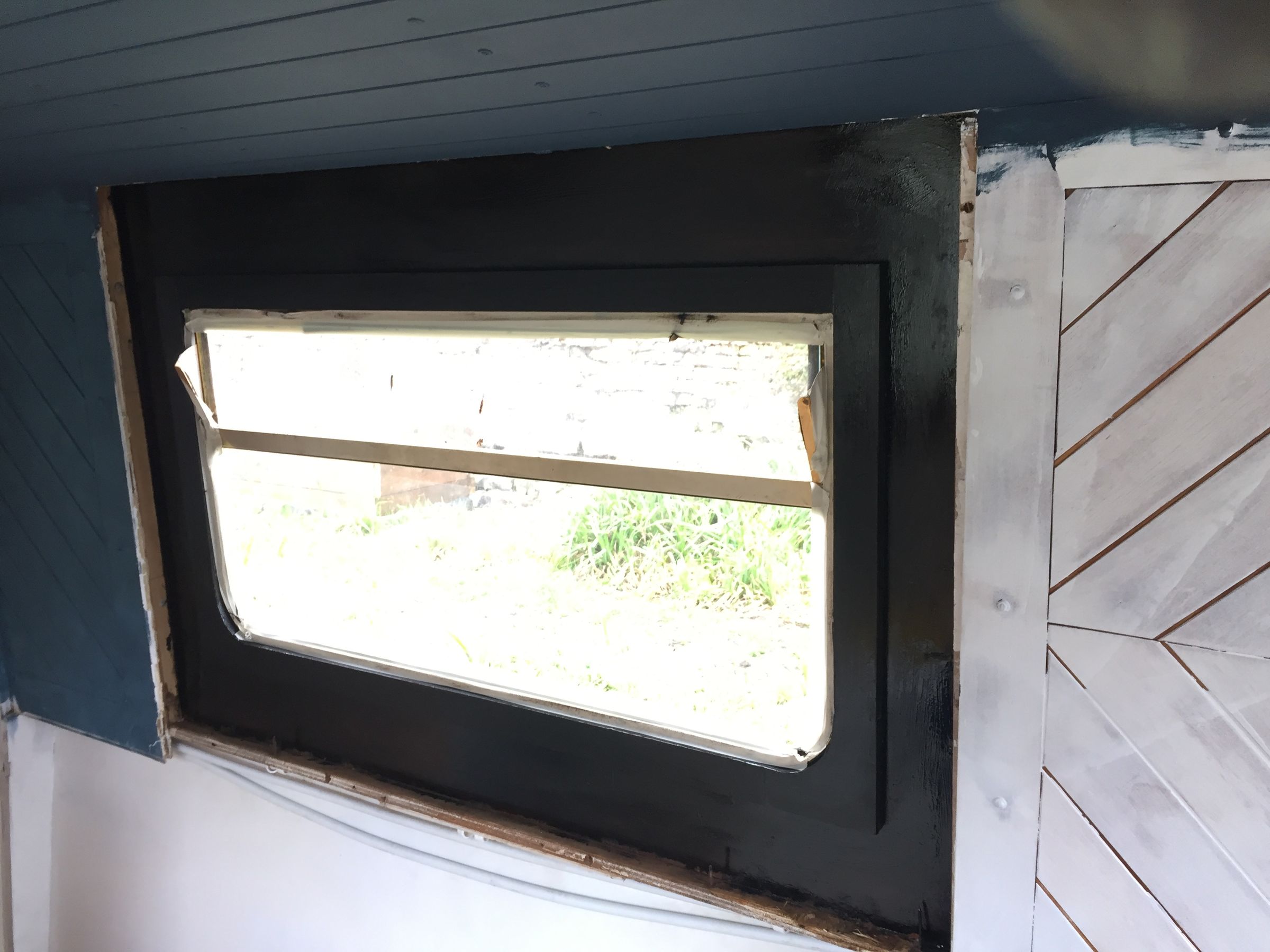

  3. Thanks, was under the impression that when it comes to timber choices then sapele is used as a standard on canalboats. At least wheelhouses and pigeon boxes usually are made of this material. Iroko or teak would definitely be the best option due to its composition, but these probably suit more on yachts costing over 6 figures. It is going to be a continuous cruiser, with a generator, solar system and largish battery pack. Never actually used a de-humidifier in life, but would it suffice in reducing any internal condensation to minimum and how long would it need to be running for to perform well? After learning more about this topic, it appears that it would best to fit aluminum ones, and was thinking about double glazed with thermal break system. So far found that Channel Glaze and Caldwells are what most of community talks about - would anyone know what their primary differences would be?

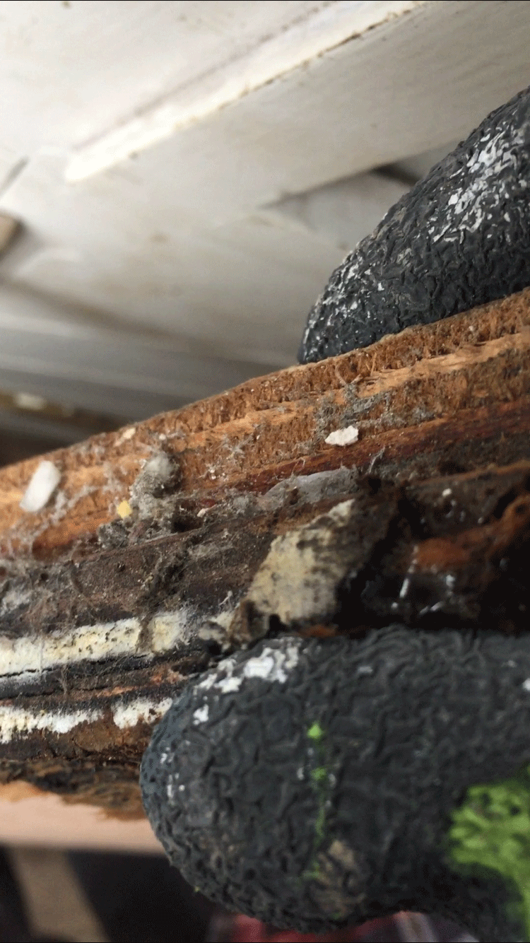

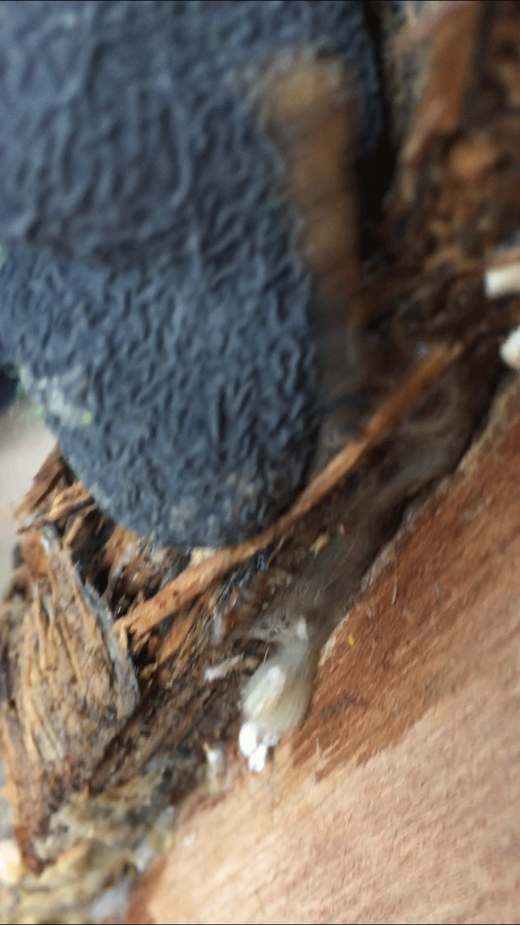

  4. Making a passive boat would be a great idea. Although its another power-hungry device, wouldn't a proper de-humidifier dramatically reduce the amount of condensation given there is an ongoing access to power? How about 3M strips? Cheerio Looks like a nice setup. Although i wouldnt mind retreating the frames every now and then as a small day project during the summer (accepting it as a part of boating lifestyle), the biggest concern is the fact that steel is a great conductor and having timber frame windows may impact their life in longterm, especially without having proper thermal break options. Have you done any internal refit around the windows since owning her? Some time ago was doing work on a 1990 41ft narrowboat where it was stripped down to bare steel around the windows (made of aluminum frame), the holding frame and battens around had plenty of damage on them- some even holding so much moisture it could actually be squeezed out (despite having no evidence of this on interior wall linings) see the pictures below. When stripping everything off and removing old ply holding frame from steelwork, where the wood sat was totally damp on the plate itself- leaving a wet imprint in the shape of the wood piece on the wall Perhaps back in the days they didnt have high performing sealants/ paints available on the market to improve on waterproofing, but seeing the state of holding frame/ battens underneath everything was the main reason for reconsidering the original idea of having wood frame windows and posting on here.
