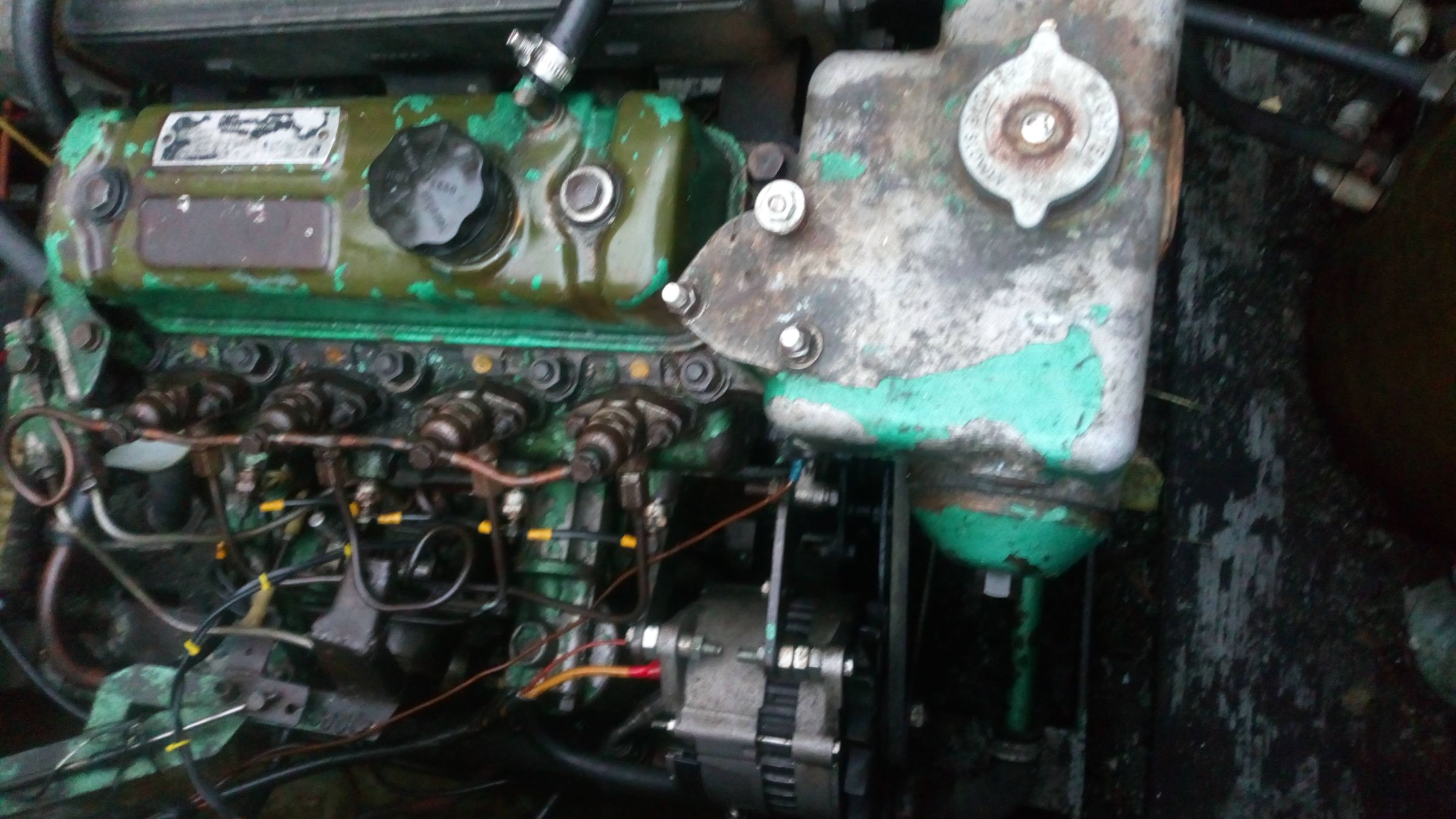

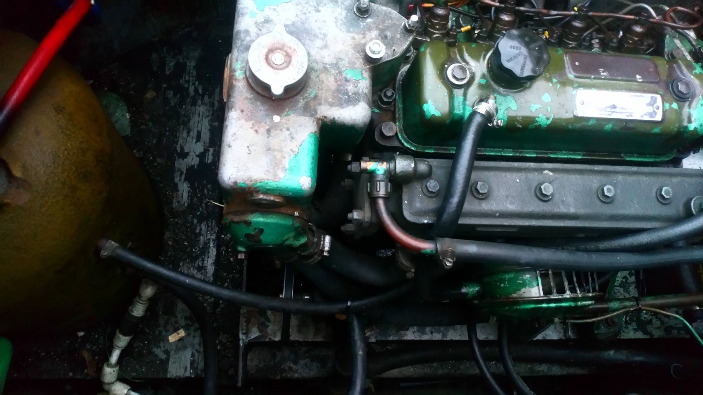

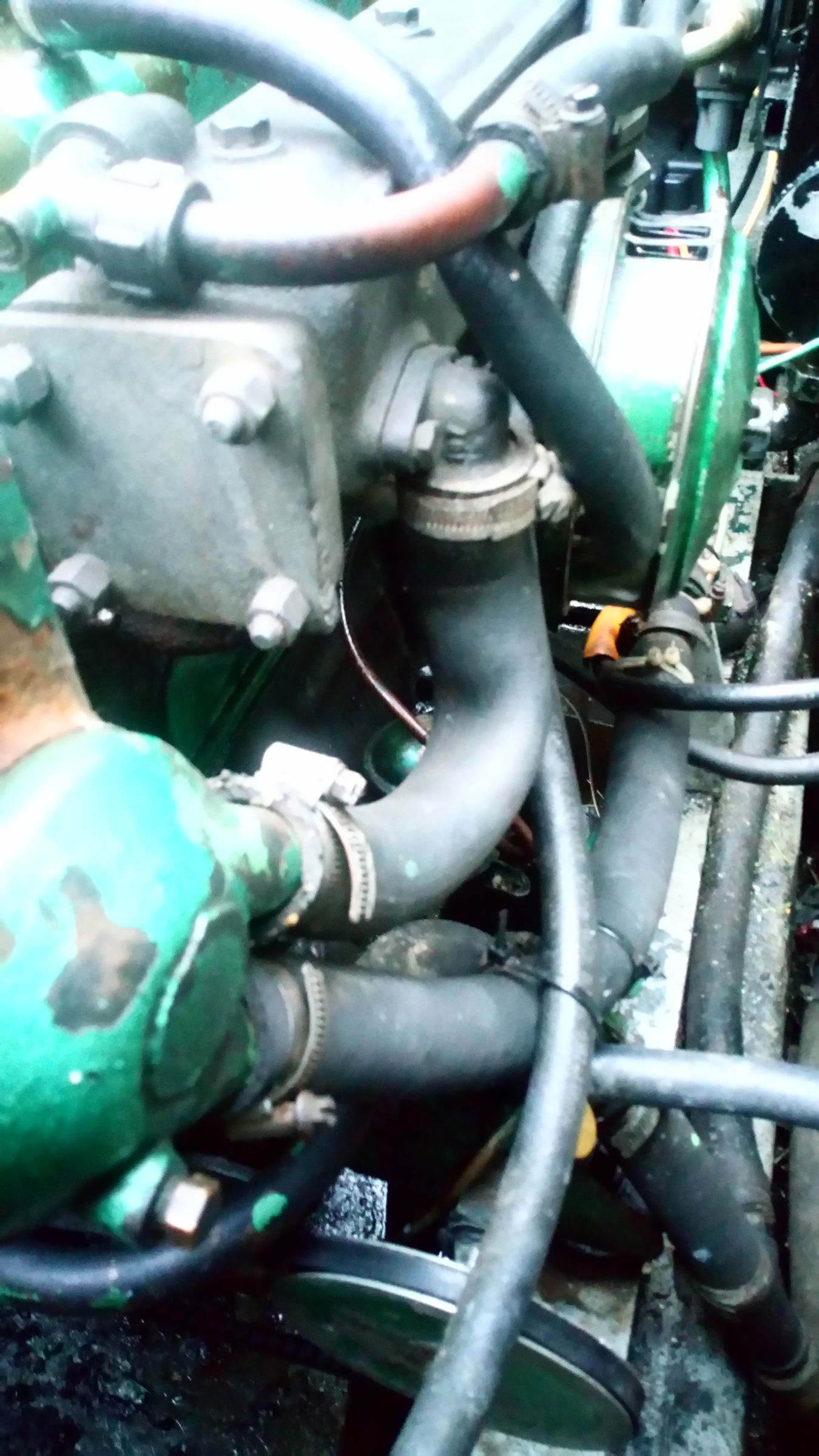

  7. Hi, can anyone help me work out where the thermostat is housed on my BMC 1. 5? My engine has been intermittently overheating- I've checked the filters on the raw water inlets and bled the system and it hasn't resolved the issue- and there's still water coming out of the exhaust. The boat runs fine for about half an hour (until the calorifier has heated the hot water tank?), then the temp gauge invariably starts to creep up accompanied by an increasing amount of steam from the exhaust. Running the hot water tap sometimes brings the temperature back down temporarily. Occasionally the engine will run for hours without the temperature gauge moving above normal, and a couple of times, stopping the engine and restarting has cured it. I'm thinking it might be an issue with the thermostat, and wanted to take it out and test it.. But having spent hours trawling the internet, I've found plenty of pictures of the thermostat itself, and diagrams of where it's located on other engines that look nothing like mine, but nothing showing where mine would be housed. I've had completely different advice from various other boaters which has left me more confused than I was before (there's a difference of opinion as to whether what I thought was my heat exchanger is actually just a header tank...). I would be extremely grateful if anyone could point me in the right direction...
