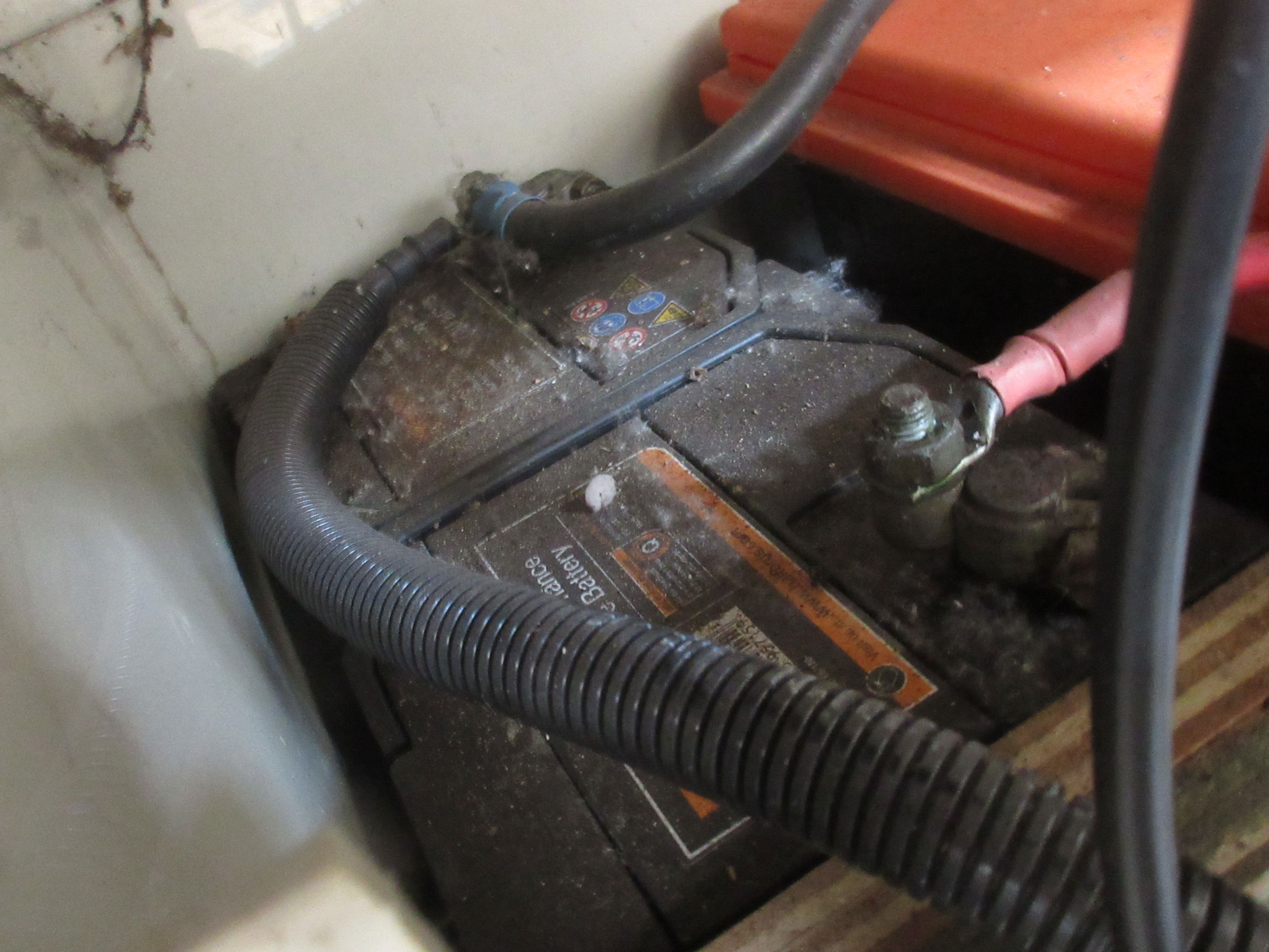

  12. The picture shows the engine start battery with its + & - cables connected to the first of 6 x leisure batteries. When we got the boat the previous owner had issues with one of the leisure batteries and bypassed this battery to the other leisure batteries. I can't fathom why this would mean connecting the engine battery to the leisure bank...but maybe this was already set up this way.. Anyway the main point is that if I disconnect the engine starter battery when I next replace the leisure batteries, I imagine this would not create any further issues with the current charging setup?
  13. I have cut and pasted this question from another topic of mine as it deviates from the original question: I have noticed that the engine battery is connected to the leisure batteries (see photo) which has raised a few questions.. After scrutinising the boats Electrical System Schematic, it appears the setup from the builder is as follows; - 2 x 80A alternators with a Sterling A-B charger and a Bat-Bat charger *Alternator 1 goes to the B-B charger which connects to the Bow battery and also the A-B charger *Alternator 2 connects to the A-B charger which then connects to the Engine battery via the Engine Battery Isolator & the Leisure batteries via the Leisure Battery Isolator So while the schematic has the engine battery and leisure batteries completely separate, why in reality are they connected? Maybe I'm reading something wrong here? I always thought that the 2 x battery banks should be separate so if the leisure batteries ever die, the engine start battery is still good to go as it's on a different system as such. Thoughts? I would normally take a picture of the boats electrical system schematic and post it here but it's very blurry and wouldn't be clear, maybe I'll do another PPT..

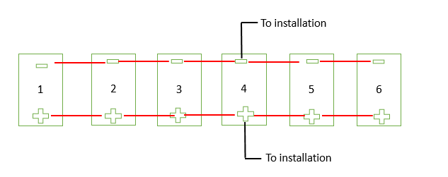

  14. Thanks all for the responses and I if I have enough cabling I'll go for the 2-5 setup As I'm unsure of the ratings of the cables and interconnects, is there a recommended rating? Also I have noticed that the engine battery is connected to battery 1 (see photo) which has raised a few more questions.. After scrutinising the boats Electrical System Schematic, it appears the setup from the builder is as follows; - 2 x 80A alternators with a Sterling A-B charger and a Bat-Bat charger *Alternator 1 goes to the B-B charger which connects to the Bow battery and also the A-B charger *Alternator 2 connects to the A-B charger which then connects to the Engine battery via the Engine Battery Isolator & the Leisure batteries via the Leisure Battery Isolator So while the schematic has the engine battery and leisure batteries completely separate, why in reality are they connected? Maybe I'm reading something wrong here? I always thought that the 2 x battery banks should be separate so if the leisure batteries ever die, the engine start battery is still good to go as it's on a different system as such. Thoughts? I would normally take a picture of the boats electrical system and post it here but it's very blurry and wouldn't be clear, maybe I'll do another PPT..
  15. OK - so my current set-up is like this but is it best to have the installation feeds from batteries 1 and 6 instead of both from battery 4?
