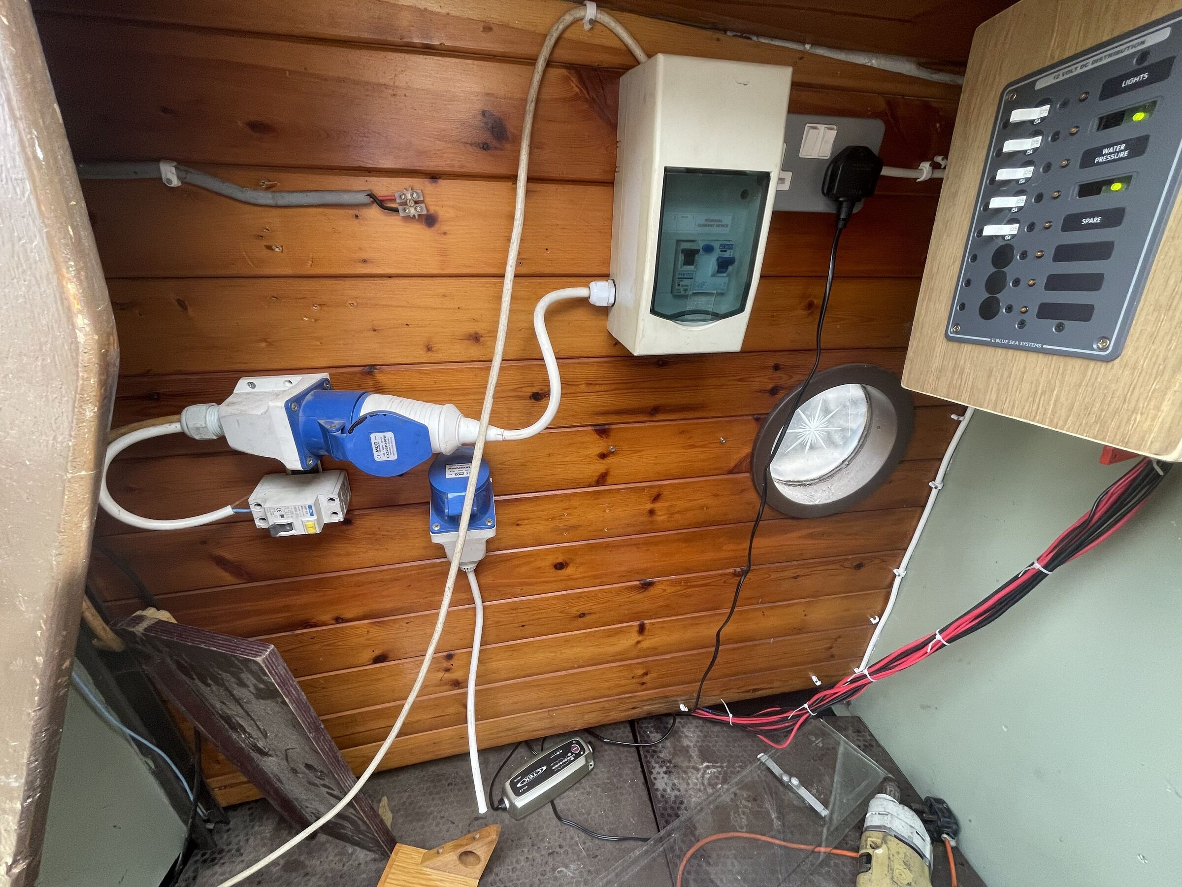

There are some figures floating around showing the increase when tilting, particularly in winter but you’re correct in that it would then require tilting throughout the day, which may not be practical for me as I’ll be at work. Does this look like the best way to wire the 230v side? I wasn’t sure whether to put the RCD before or after the inverter but with wanting to isolate the immersion from the inverter side, this seems to make sense? Switch not required as the victron auto switches between shore power and inverter.

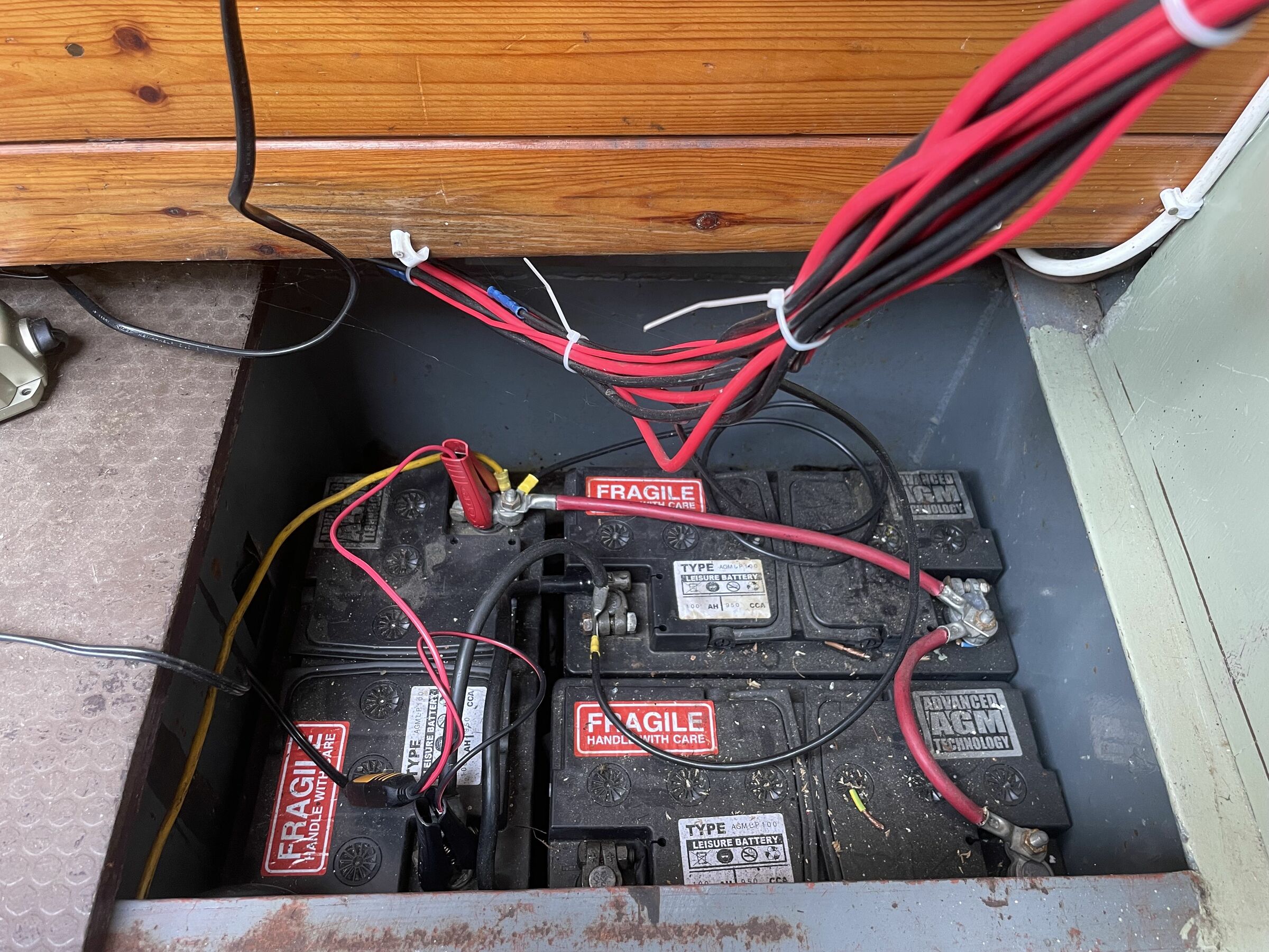

Here are the panel specs: Watts 400 Maximum Power Voltage - Vmpp(V) 41 Maximum Power Current - Impp(A) 9.76 Open Circuit Voltage - Voc(V) 49.5 Short Circuit Current - Isc (A) 10.12 Panel Efficiency (%) 21.3 Height (mm) 1646 Width (mm) 1140 Thickness (mm) 30 Weight (KG) 19 Cell Type Mono Percium So 41v? The boat was full of grey twin and earth when I bought it, couldn't work out what was 12v and what was 230v, all been ripped out since. I think that's probably the last remaining remnant. That's the plan and is why the solar installation has expanded somewhat to include rewiring the batteries, shore power etc as I'm fairly certain it's all on the cusp of being unsafe.
