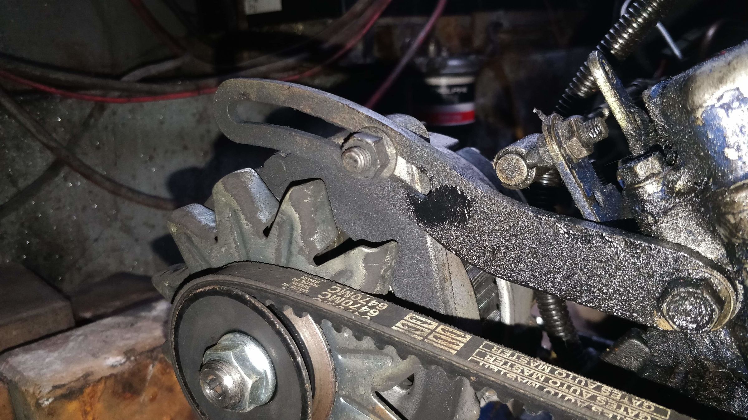

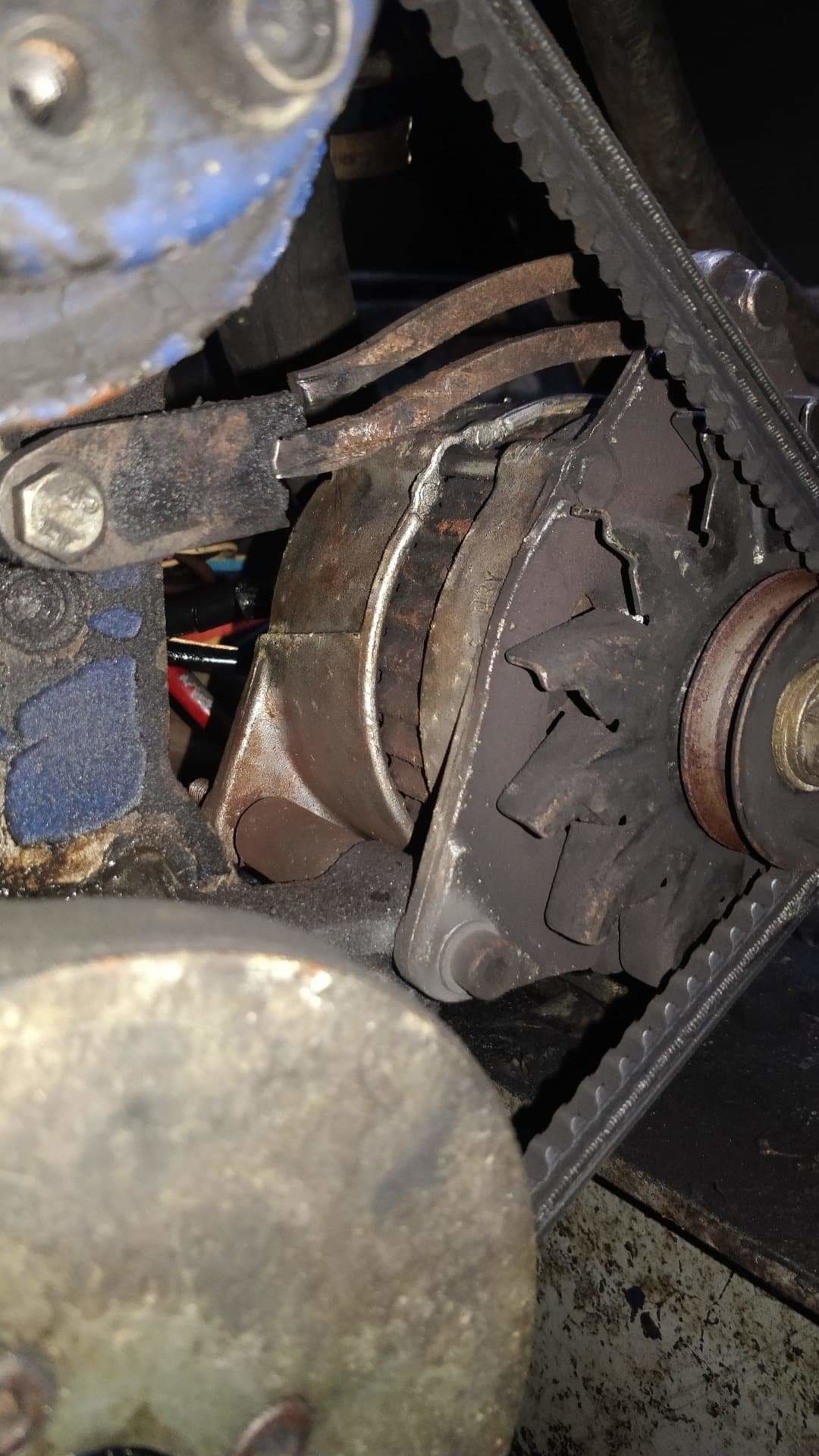

Thanks both. The welding is a great shout! We'll try and fix this, replace the belt, and then sort our wiring which needs a look at. Forum advice as wonderful as ever ?
Great thank you! We have got new belts, just need to fit them. We'll try these brackets and see how we get on. Fingers crossed!
Hi guys, can anyone help us with this... One of our alternator brackets has somehow snapped resulting in a number of cables shorting. Engineer is quoting £64 for replacement alternator plate which seems mad for a piece of metal 18cm long. It's an Isuzu marine 4LC, I think similar to the canal line beta marine engines. Do I need to replace it with this 65 bracket that has to be shipped from Belgium, or does anyone know if this universal plate would do: https://www.ebay.co.uk/itm/Alternator-Mounting-Brackets-Car-Van-Truck-Chand-Type-Curved-Slot-Adjustable/322864183673?hash=item4b2c347979:g:z2MAAOSwhDBZ~f0e Thanks!!!
