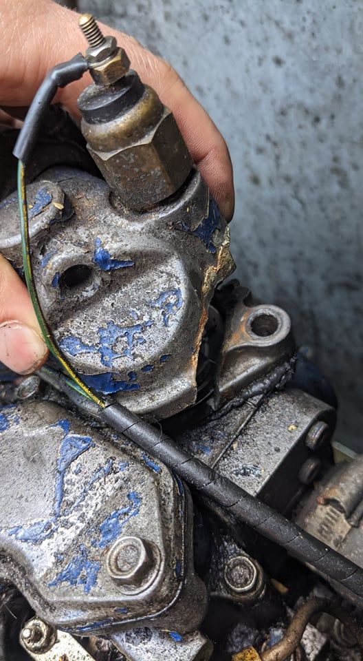

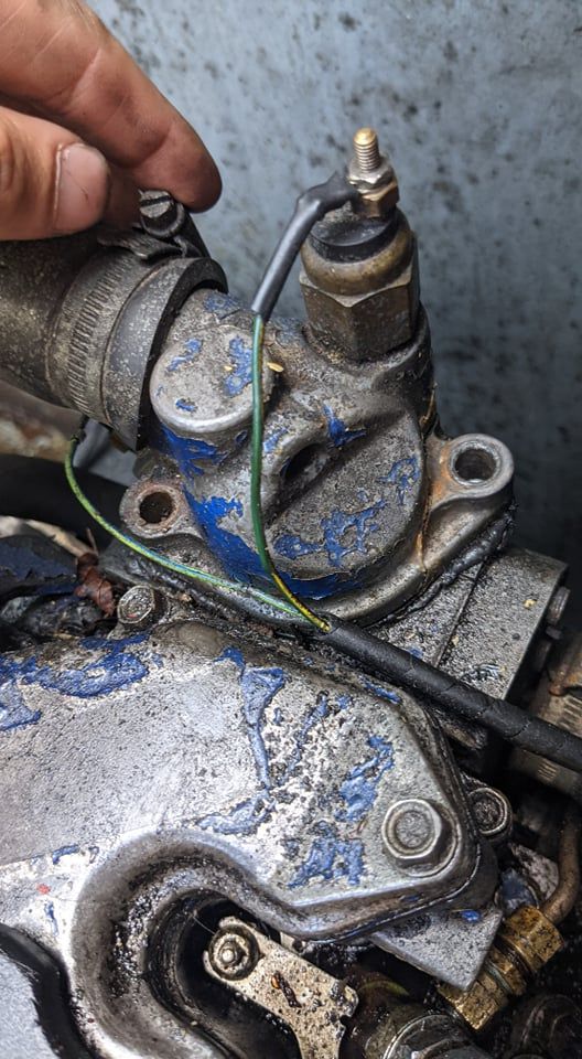

  11. Hi - Could somebody help us out with this please? We've had leaky thermostat for a while and presumed the gasket had gone. Went to replace it today to find the housing has actually cracked and the previous owner has patched it up with some waterproof gunky stuff. Weirdly, there was no actual thermostat in the housing. Our engine is an Isuzu 4LC38 - I've tried searching around but can't find any parts to replace the housing. So I've turned to the wisdom that is this forum! Does anyone have any solution for how we can fix this? Shall we just reseal with whatever gunk was used by the previous owner? THANK YOU!
