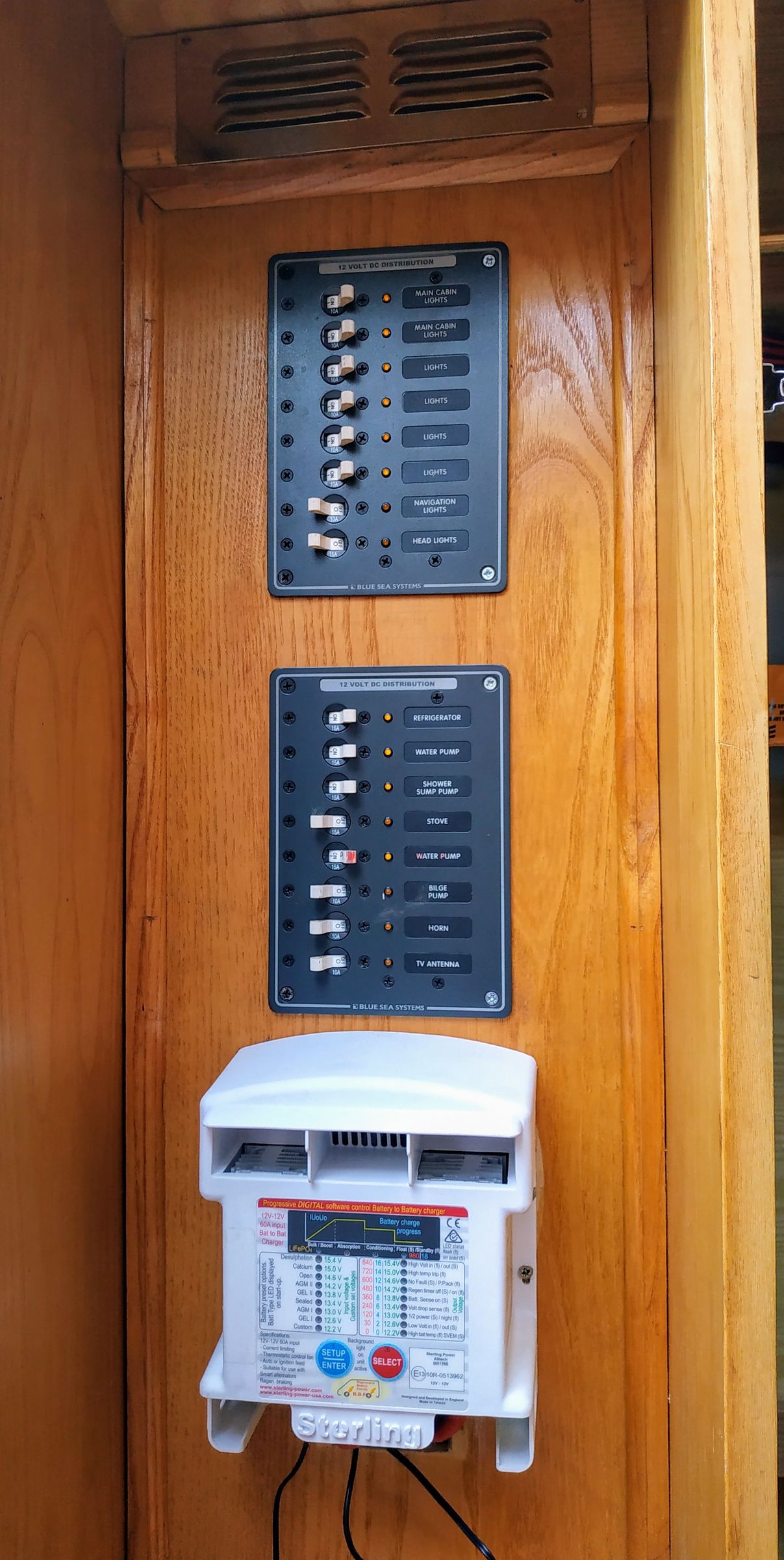

  3. The Sterling has a Lifepo4 setting plus I'm pretty sure it also has a custom setting if not happy with those parameters so it's fully automatic. I was getting 45/50 amps charge from the alternator to the LA bank originally so I went for the 60a b2b and it charges the lithiums at around 50 amps which is what I wanted. It also has the "half power" function that charges at around 30amps if I'm going on long cruises. Mine is similar to yours but it's dc to dc so you can hook it up directly to any battery. It's quite small and cheap but very good quality I only mentioned the low temp protection as many bmss and most cheaper drop in lithium batteries don't have this function. On my bms you can set it to whatever you want (I set mine to 5 degrees C) and it will shut down the charging side of ever it goes below this temperature. The load side fets will still be on. That's in case the ambient temperature will drop below 0c (very unlikely as my batteries are inside) and you can irreversibly damage lifepo4 by charging below 0c. My cheap Chinese Hall effect (or you can get one with a shunt if you prefer) battery monitor has two programmable relays. They can be set to come on and off by voltage or state of charge. Say come on above 80% soc and turn off below 50% or whatever. At the moment I turn the mcb on manually (240v element) for a couple of hours when I need the hot water but I'll be connecting a relay to a SSR when I have the chance. 14.2v is the charge limit on the mppt (epever) that translates to slightly less at the battery terminals. Also remember that unlike your power supply the mppt provides quite a lot of current and the batteries seem to reach a higher voltage than they really are. Always check what the actual voltage is at the battery terminals and adjust the mppt settings until you get the voltage you want Well I have about 1kw so I expect to be using the sterling quite regularly. This is a useful little table of average daily Amps for any given month in UK from a 100w panel. Jan 4.68 Feb 9.36 Mar 16.29 Apr 25.71 May 34.85 Jun 35.42 Jul 34.57 Aug 28.19 Sep 19.34 Oct 10.85 Nov 5.60 Dec 3.54 I still don't know how much I use daily (as I frankly don't really care) so I'll be turning the engine one when needed ?
  4. Hi Ivan&Alice That's great stuff I have left a lead acid connected to the alternator to which I connected my sterling b2b to charge the Lifepo4 when needed. The sterling can autosense and start charging automatically but I have used the manual function via a little switch so I start it when I want. My model charges at about 50 amps with the option to go half power at the press of a button. It works just fine. For top balancing I used a cheap (but pretty nifty) power supply that works with anything up to 32V DC. Like you I got the bank charged with solar and stopped when the first cell got up to about 3.5v (that's when the out of balance increased quite dramatically). Then connected the power supply to the lead acid and top balanced the whole bank. I'm also full time liveaboard so no mains either! I also looked at the various options for battery protection/bms but went for the simplest. All my DC goes through a 120A bms that also has low temperature protect. The bms has a little Bluetooth dongle that allows me to monitor all cells and check and change all the parameters I could possibly need. It also has a good coulomb meter. But I've actually disconnected the Bluetooth now that I'm happy the setup is working as I want a fit and forget system and I didn't want to keep looking at the app! Luckily I got a 2kw victron inverter super cheap on ebay that works a treat and it has remote relay inputs. So the inverter is connected directly to the battery as I didn't want all those amps going through the bms and programmed the hall effect battery monitor's relay to turn off the inverter if ever the battery voltage dropped too low. I think the Bmv also has a relay for this function. To be honest that's just for failsafe as I have never gone low enough to worry. I've just installed a 1kw element in my calorifier and been getting free hot water (draws about 80amps) while we're getting a lot of solar. So my system is pretty simple. Top balancing and setting up the mppt was the main concern as with solar the biggest risk is overcharging. A good top balance allowed me to set the mppt to 14.2 and still be perfectly balanced. Undervoltage failsafe is there but as continuous cruisers we're always aware of where our batteries are at so not much of an issue. As for alternator charging the Sterling is plenty good. It probably doesn't have the best profile for Lifepo4s but unlike solar I wouldn't be leaving it charging all day so it probably will never reach full charge anyway. Infact I hope to use it the least possible even in winter. I'm about to order it all again for my friend's boat and at less than a grand for the whole of the above system (not including the solar and inverter of course) is crazy good value considering the capacity (300a) and the performance if lithium! I keep reading the inefficiencies boaters have to endure with lead acids and wonder WHY!? ?

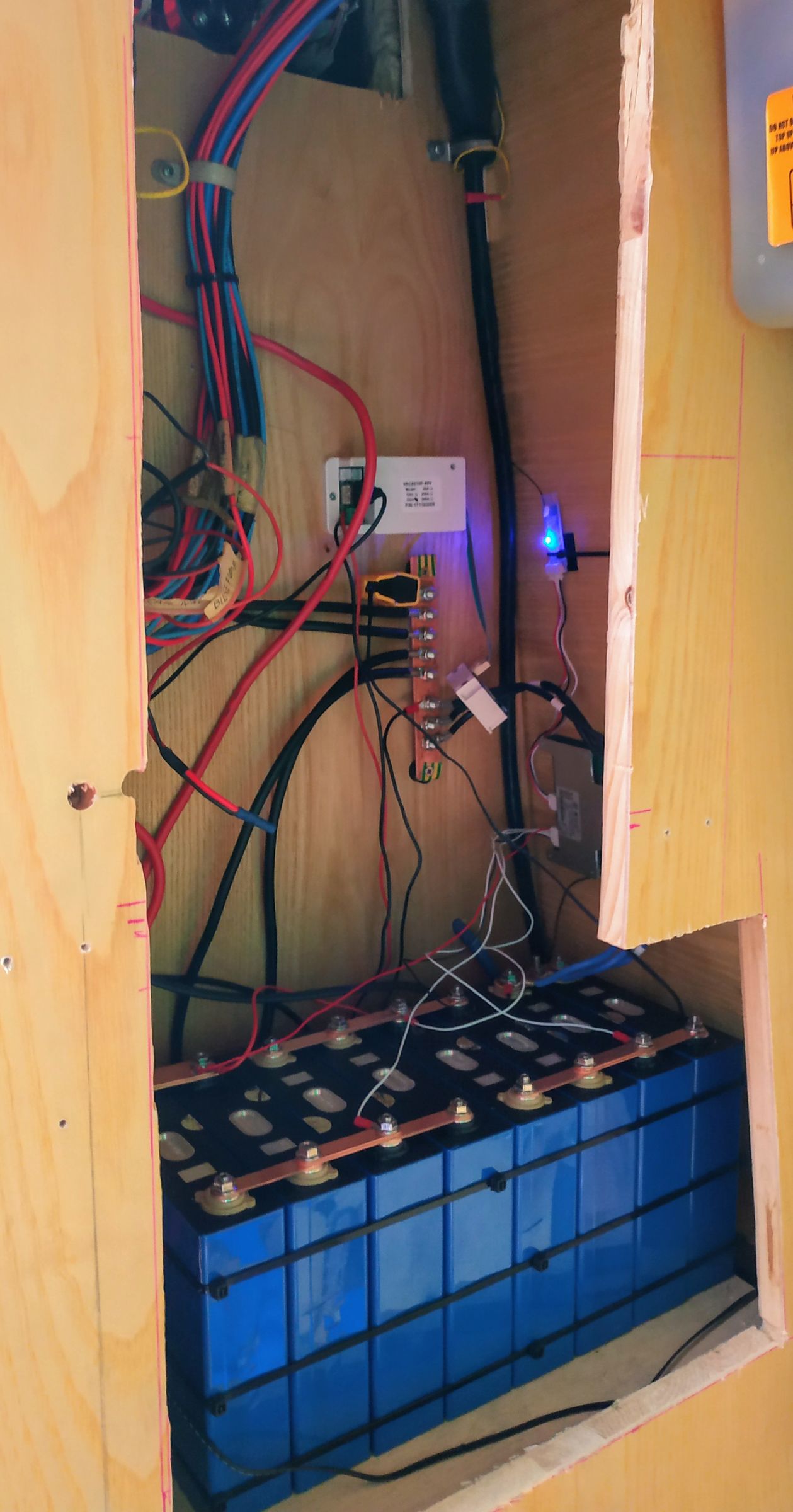

  9. Yes good point but I'm fully aware of the danger. I have a rubber mat that I put on them and they are in the wiring cupboard where everything is well fixed. I really wouldn't like to test lifepo4 max short circuit current ??☠️? I went to Beta Marine to get the right spares and they gave me the alternator sizes..... And a black and white print of the engine ready to leave the factory ?

  12. That could very well be the way we measured the temperature. I reckon this alternator has been charging at around 40a for almost 15 years so I'm not gonna worry about its normal temp. If I really find that I need to charge faster I'll look into fans and cooling and bodging something up but the moral is.... The alternator is the limiting factor!

  16. Great news.... It's all connected and running! At the moment the battery is getting 13.5v and around 50A Ive just checked the alternator and it's pretty hot. I have an infrared temp gun and the hottest I can measure pointing into the windings is 150 degrees C. I've just turned the engine off as I'm not sure about the alternator... Need to check temps when charging lead acid bank only. Happy so far though

  19. I agree! I was thinking of getting those Valences on ebay but I wanted to learn a bit more and also be able to get more matching ones later on. Valences at that price might not always be available and I'd end up mixing very different types of batteries. Also these perfectly fit in the cavity behind the 12v distribition panels where all the cables I need are. I think I might actually get away with just reterminating the existing cables with no new cables to buy or run ?

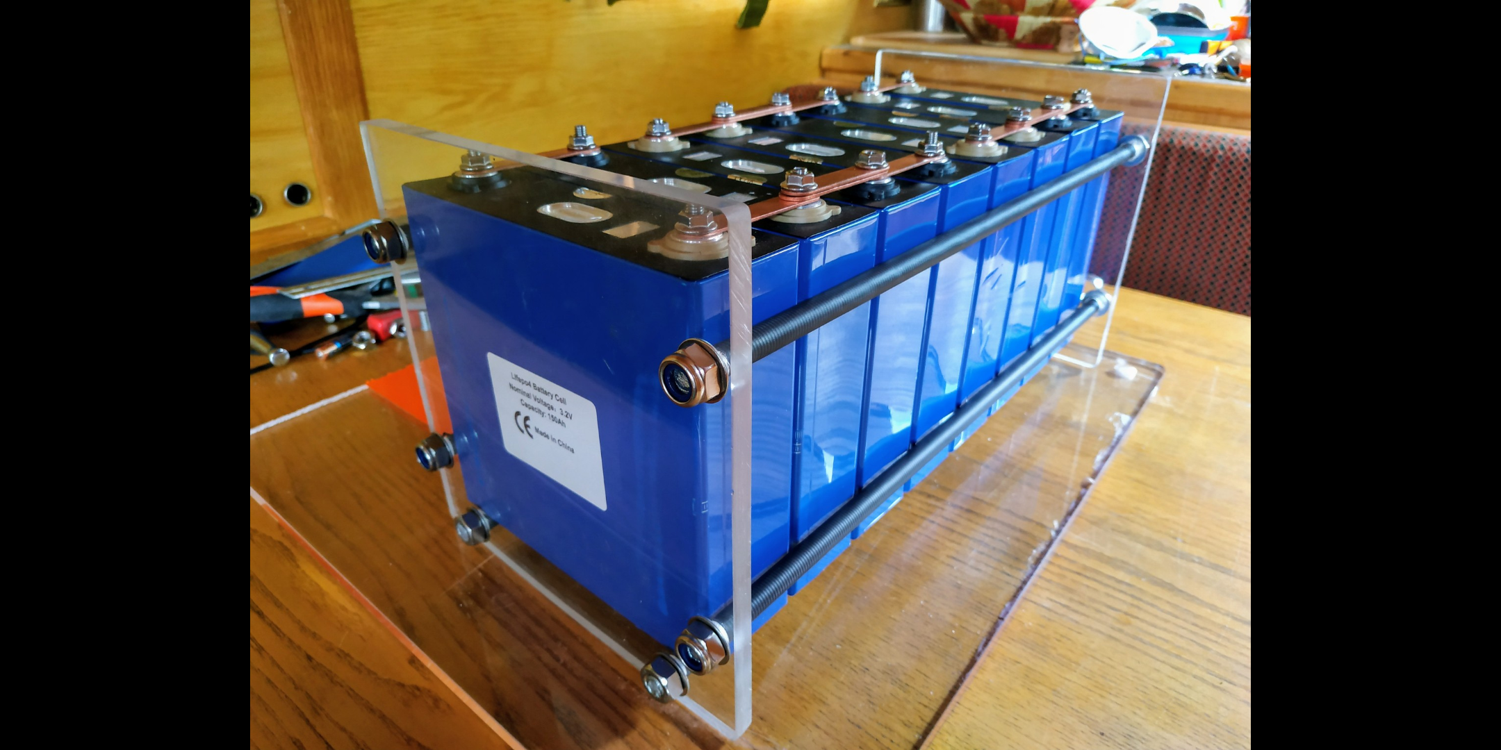

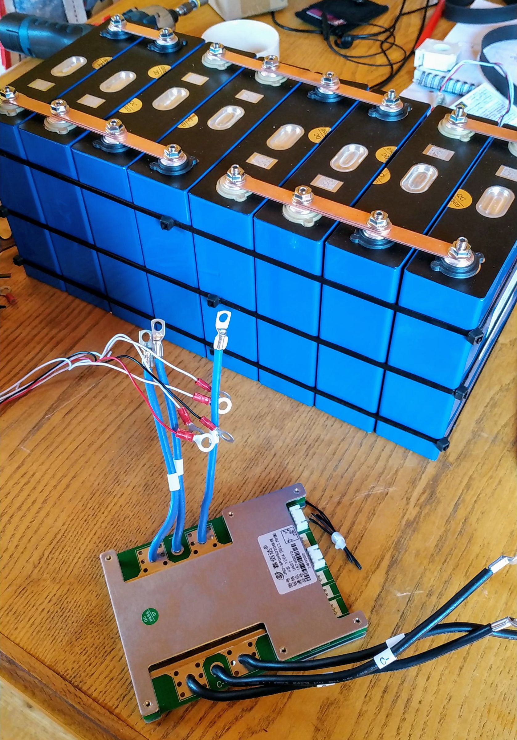

  23. Hey, I received the cells yesterday... YAY! UPS, all individually wrapped and boxed and all perfectly matched in voltage. And they are tiny!! That whole thing is 400mm by 180 by 180 at about 24kg (replacing 5x 110ah acid lumps of 350x190x180 @ 23kg.... EACH) That's 300ah on a dinette TABLE! ? All I've DONE so far is checked the individual voltages which all match to two decimal points. Connected up into one bank of 12v with the supplied copper busbars (not the thickest copper but they gave me 16 of them so I doubled up on the series connections) Terminated and connected the balance and BMS leads and tested the Bluetooth app. App is great and has more parameters that I care for which all seem to work OK. Bluetooth worked straight away. BMS is 120A so I'm planning to add a second one as I would like at least a safely usable 150a for when I need it (my inverter is 2kva) BTW the BMS came with those cables already soldered on the board all I had to do is crimp some lugs on. Cables are 6mm each so you get a nice 18sqmm on each side. Can't wait to cut into my system and install this pretty little thing! Will keep you posted ???
