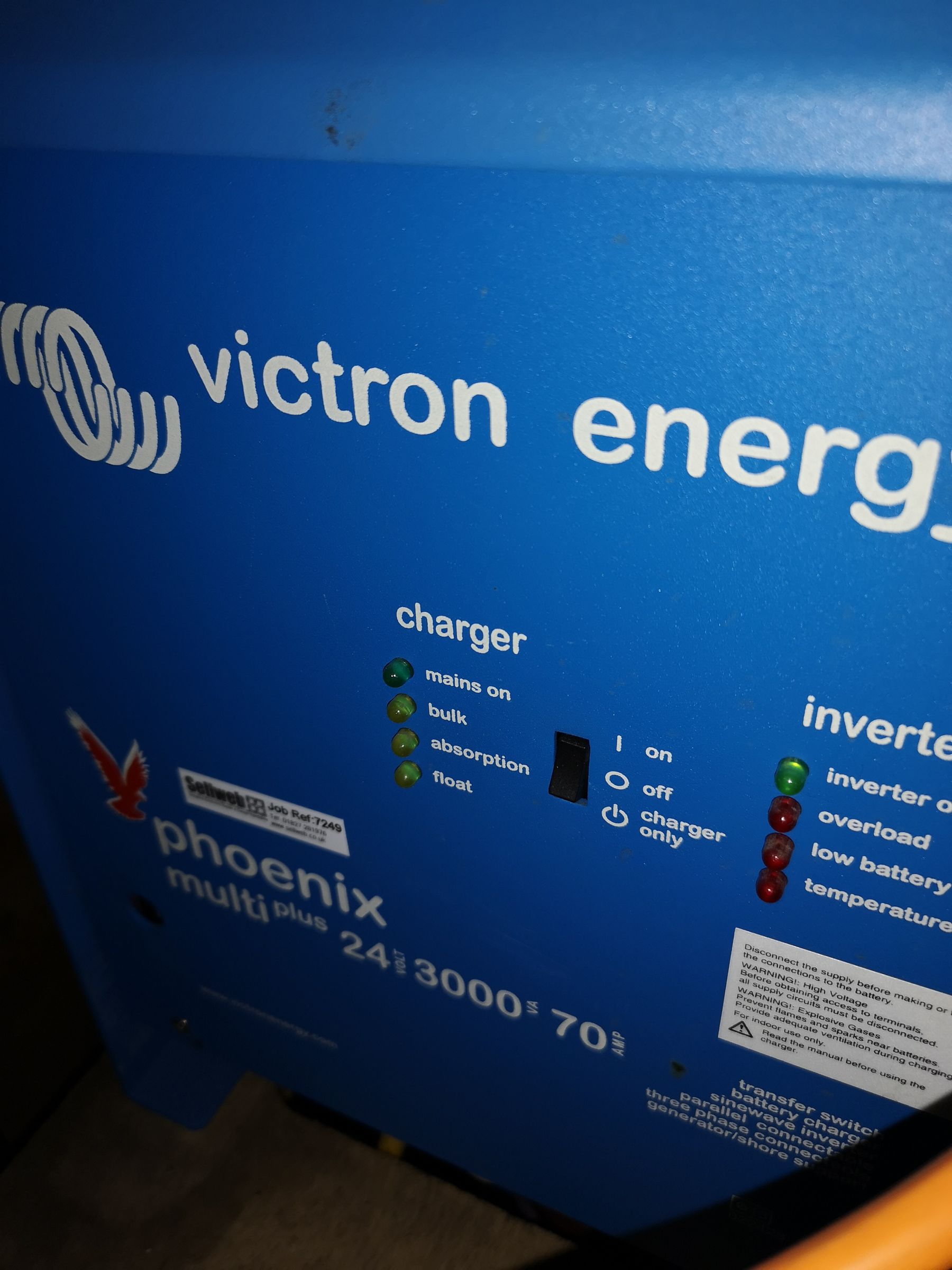

  1. This is my inverter, just had a thought, if I turn off all trip switches on the fuseboard other than the fridge & freezer when I leave the boat or am cruising would that be better for the batteries?

  3. Sorry I thought I'd said fridge & freezer both 24 volts. Yes TV and WiFi router are 240v. My inverter is 3000watt. I will now be switching TV off at the socket after use (2 or 3 hours in the evening) but prefer for WiFi to be on all day & evening. Router transformer plug says output 12v at 2amps. Could I cut transformer off and put cigar lighter plug on it as I've got a spare 12v socket close to where my router is to go? The only other thing that has to be on overnight is my breathing machine for my sleep apnoea. It's basically an air pump that keeps air pressure up in my lungs/throat. That power brick outputs 12v at 5amps. Again could I cut off transformer and run off bedroom 12v cigar socket? Thanks!

  7. Because I always forget to switch off the plug. Having now written this I hope I will remember to do so! But that wouldn't account for such a drop would it? And however much I leave the engine running battery monitor never goes above 98%.
  8. I think so, just by the fact the monitor never shows 100% and will drop to below 80% even if I'm out for the day and only 24v fridge & freezer are on and TV on standby?
