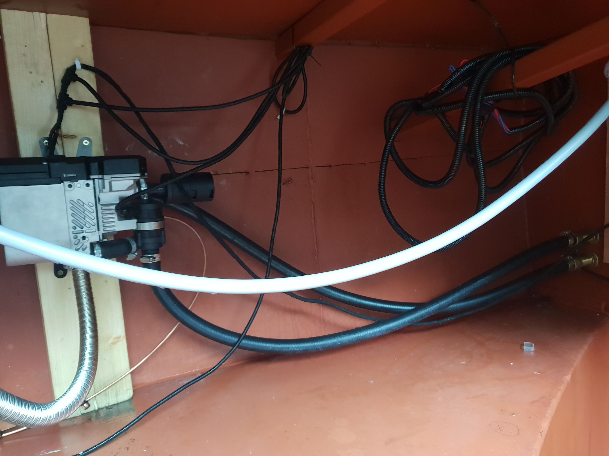

The 28mm pipe is the black flexiable hose running from the webasto to the bulkhead, 28mm external, 19mm internal. After the bulkhead the 22mm pipe starts. I'm assuming that the pump starts circulating the water because within two minutes of the shut down cycle the webasto unit and the black hose go from being too hot to touch to being room temperature again. I thought this was due to tje pump circulating.. It's all terribly confusing to be honest.

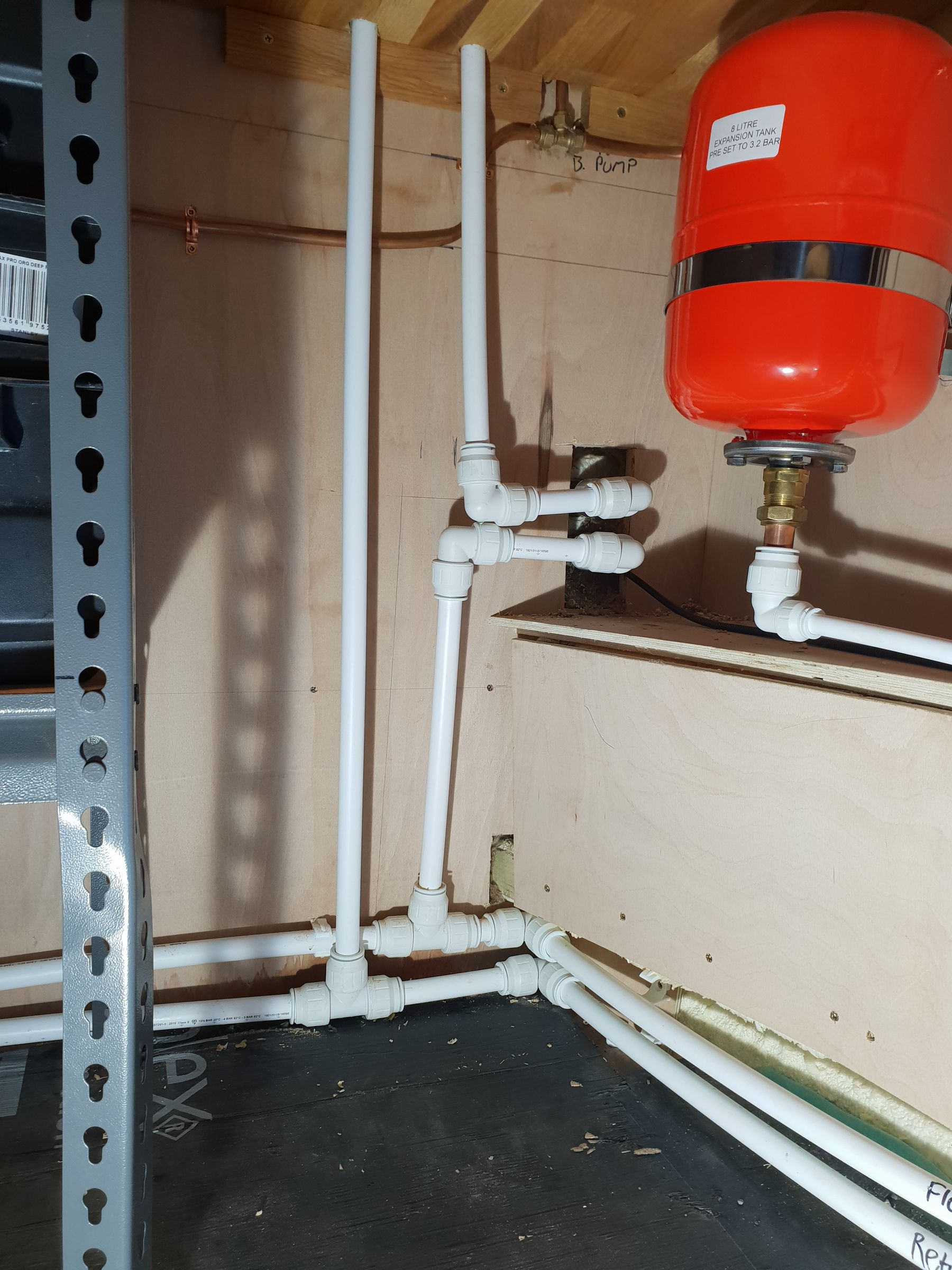

I have flow and return pipes, 22mm, which run down the length of the boat, the rads are all teed off these pipes with 15mm pipe. All the valves are open and the TRV is still fitted but I can't see why it would be a problem on this system as it is teed off the main feeds.
So the pump is attached to the unit, as in the picture. I don't think it's a Webasto pump, as the fuel pump isn't and the unit is a recon so I wouldn't be surprised if the parts were cheap replacements. The return pipe is coming directly from the header tank into the Webasto unit, via two elbow bends. The pipes are most definitely the right way around, as in the flow is the flow and the return is the return.

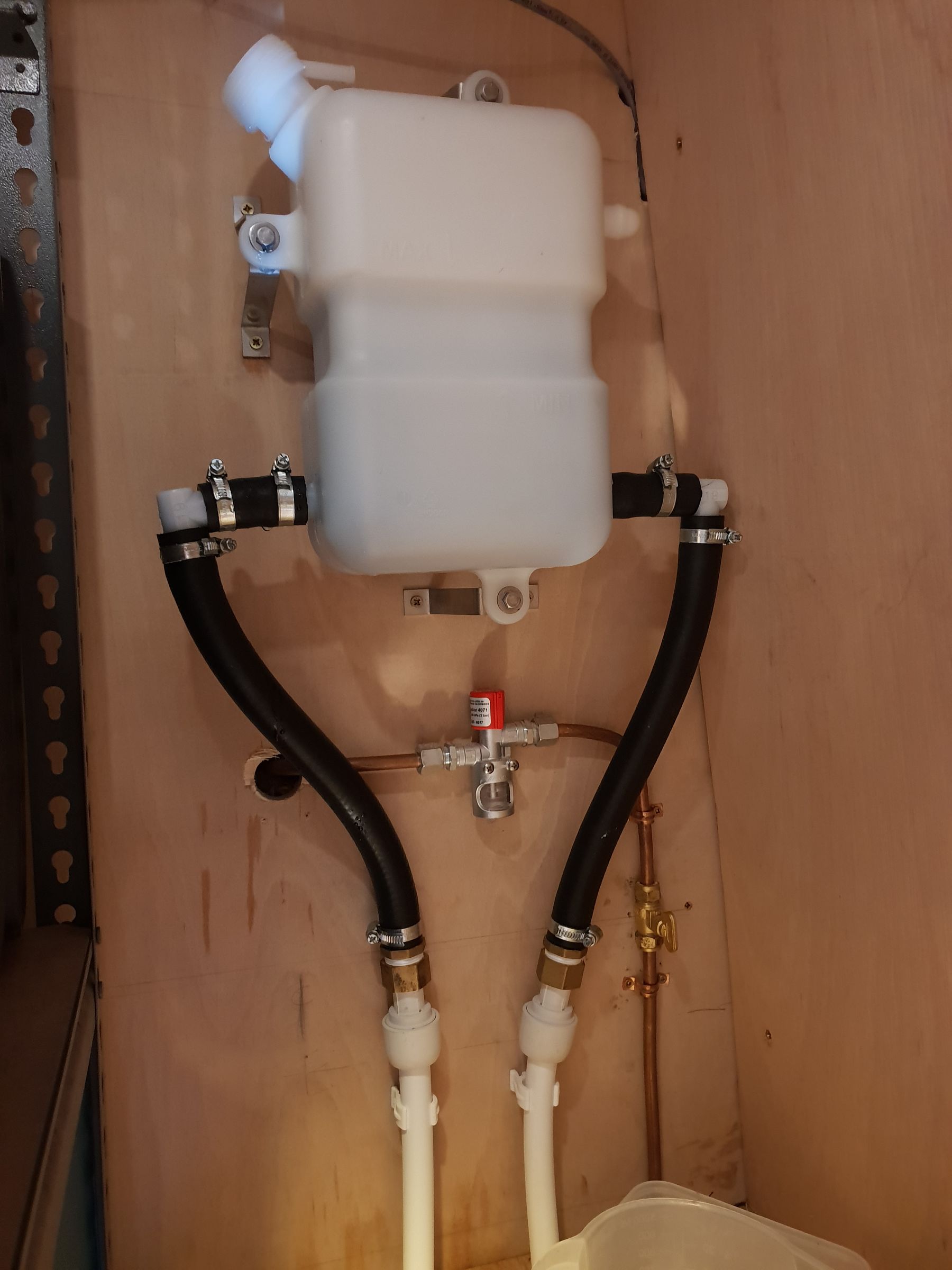

Would the air not move downward even if it was being pushed by water? I think Mike mentioned earlier that once the airlock is dealt with any remaining air in the system should be pushed around and find the natural high points in the rads and header tank etc. The supply pipe to the webasto will always enter on a bend, which means it will have its own little air trap there. Can anyone recommend a bleeding valve which would fit onto the black hose pipe? I will try bleeding the unit again tomorrow when the sun comes back. I managed to get a few bubbles out of my new bleed valve coming off the calorifier but am fairly confident that the airlock has to be between the header tank and the Webasto. I can't work out why it would be after the Webasto on the flow pipe, and even if it was it wouldn't cause any issues as it would be pushed around the system until it finds a high point. The issue must be that there is air in the return (supply) pipe which flows directly from the header tank down to the Webasto.
The water has circulated a number of times but doesn't get very far, as previously mentioned. Surely the air trap isn't in the black pipe leaving the Webasto at the top. This is the flow. Would the air not be pulled to the pump and then start causing a problem with the unit over heating. It was mentioned earlier that the air bubble could work it's way back to the calorifier after the unit turns off. Hence why I've now installed a bleed point next to the gate valve on the return pipe leaving the calorifier..

So why would the air keep making its way back to the calorifier once the pump fails to get going, instead of staying up at the pump? Do I need to drain the 55L of antifreeze from the system, then flush through with water, then top back up with the coolant? Answered my question before I had typed it. Will send one over this evening.
What do I need to do once I've fitted the bleed valve? And why would the air go back to that point? Do we think there is air in the coil which keeps being pulled through to the heater?

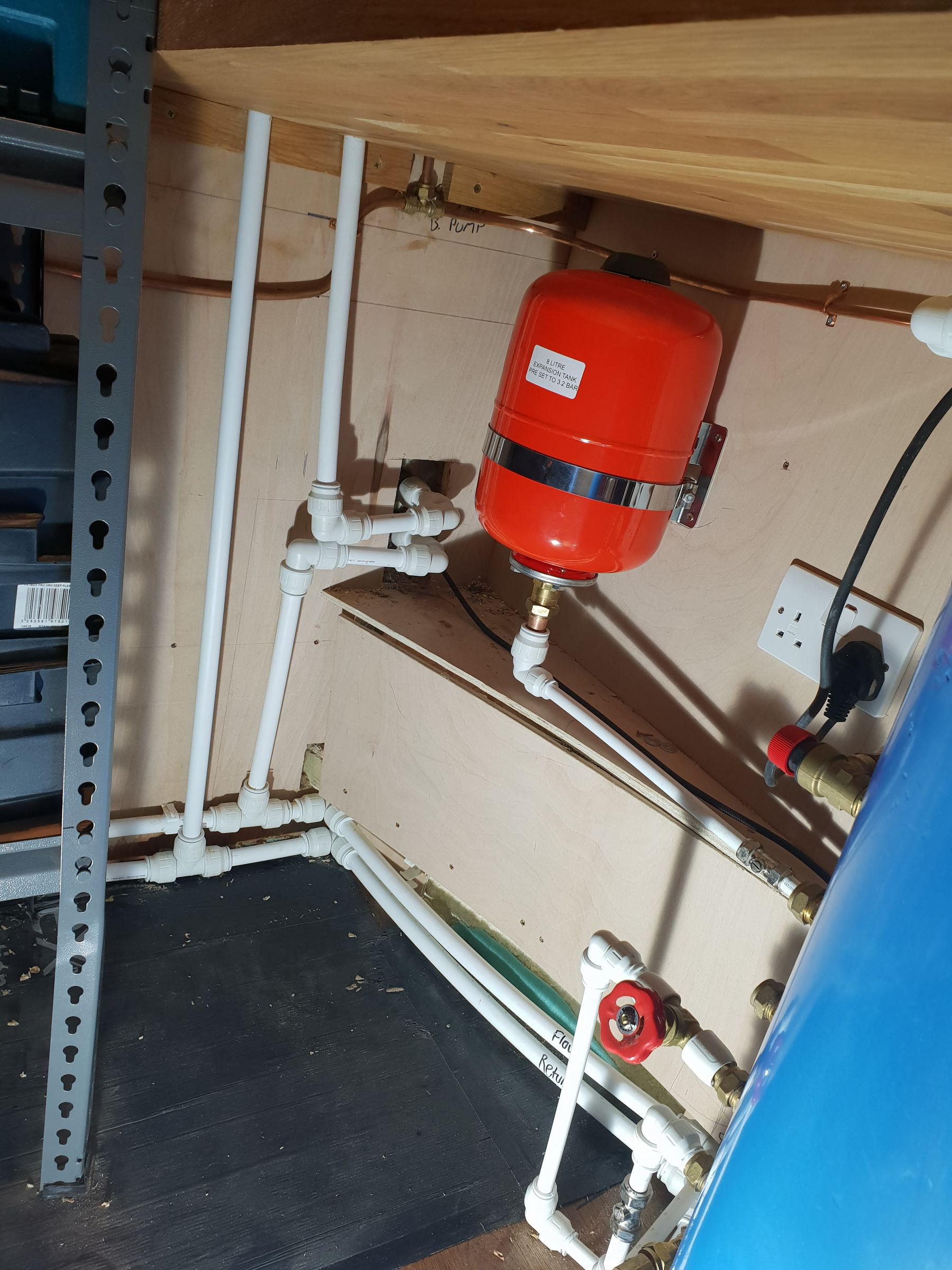

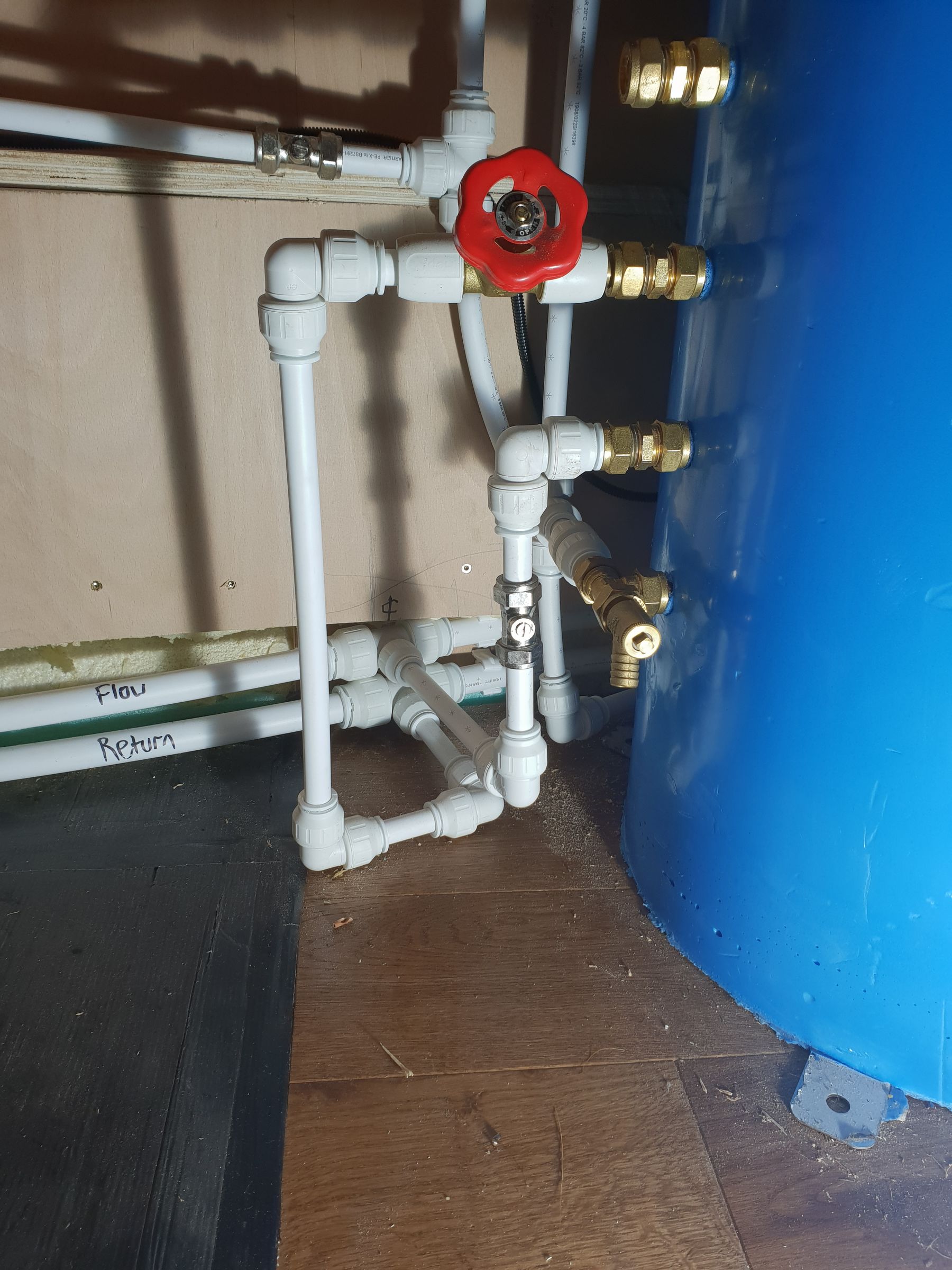

I hadn't considered air being trapped and thought it would always make it's way up to the header tank. Where would I put a bleed valve on this pipework to help bleed the coil?
Thats the hot water pipe coming from the calorifier, not part of the radiator system. I don't seem to have any air trapped in that system, possibly because the expansion tank holds pressure?
I am struggling to draw out the plumbing but that's the brains of it. The Rads just tee of the flow and returns. Where the pipes run off to the left of the photo (starboard) they are feeding a small rad on the bulkhead.
